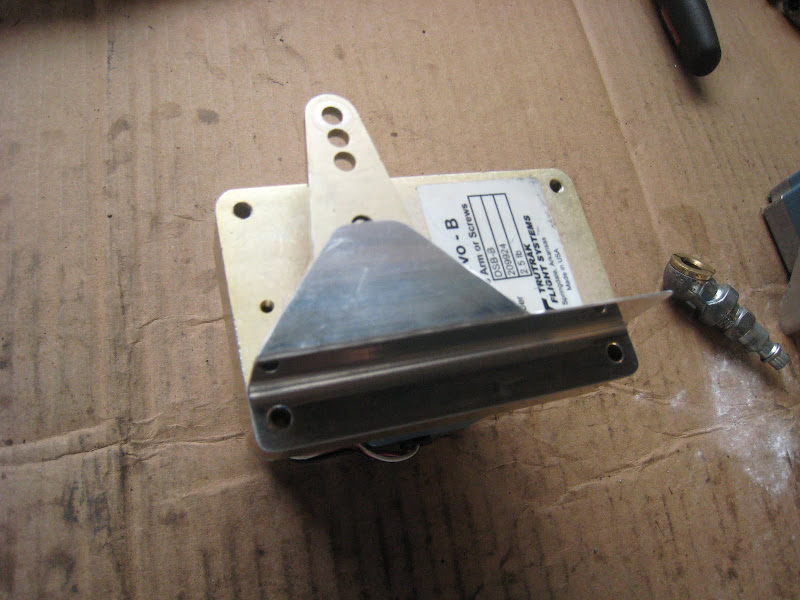

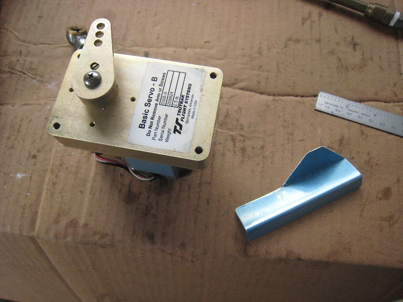

Last year, Tru Trak issued a Service bulletin and provided replacement screws due to some instances of the screw that holds the servo arm to the output shaft backing out. There was at least one report here on VAF of a servo arm falling off of the pitch servo, and causing a jammed elevator during a loop ? a situation handled with extreme professionalism by the pilot who saved the craft and brought the story back. The new screws supplied by Tru Trak had a daub of blue locktite on them, and were supposed to fix the problem.
We put the new screws on both servos in both of our airplanes as soon as they were available, and felt happy that we had addressed the problem. But during those last week?s annual on the RV-6, we found the roll servo screw backed out about half way, and the pitch servo screw slightly loose. A hangar discussion with neighbors and mechanics brought up no new ideas for keeping the screw in place (other than more locktite), but did bring to light a guard that our F-1 owning neighbor had fabricated to keep the arm on the servo in the case that the screw did back out ? a nice set of ?suspenders? to back up the ?belt?. This was very much in line with my philosophy that any potential failure WILL happen, so you better have a backup plan.
As an engineer, I am always aware of the potential for unintended consequences when making a modification, so it took me a couple of hours to convince myself that this guard has no reasonable downside. As was pointed out last year during discussions of this issue, it is important that the arm not be secured so securely to the output shaft that the shear pin cannot perform its function. The design is such that if the servo were to ?run away?, the pilot can exert enough force to shear the pin, causing the output shaft to freewheel independent of the arm, preventing jammed controls. This ?new? guard (my neighbor gives credit for the design to Blue Mountain, who had it on their servos which he had until his recent conversion to GRT/TT equipment) will keep the arm from backing off the shaft if the screw gets loose, and I can?t see a reasonable way in which it could jam the controls. This certainly doesn't negate the need for careful inspection, but makes us feel better between Annuals.

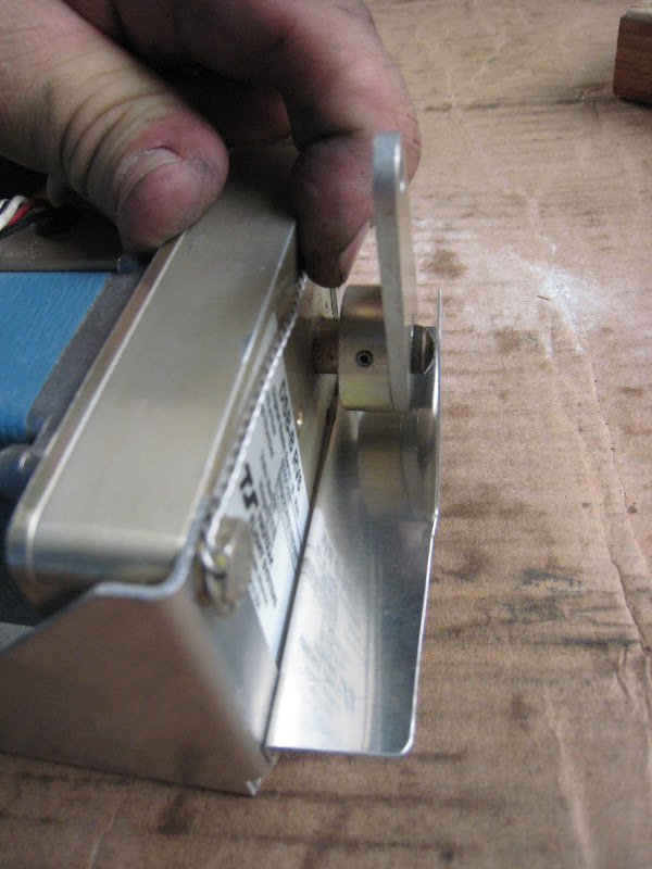

Fabricated out of some scrap .025 Alclad, the brackets are basically ?Z?-sections with a web of 7/8? and the little pyramid cut to cover the output shaft area. Full throw of the controls with the servo and guard installed was tested after installation, and nothing even comes close to interfering or binding. Adding the guard does add one potential ara where FOD could hide ? but there are already other places where this could happen in the RV without servos at all ? so keep loose stuff out from underneath your floorboards.
Pictures are worth much more than my words on how to build them:
Paul

It might - but I still think it is going to keep the arm from pulling off the end of the output shaft - it would take a huge force to make that happen.

A hole in the bracket flange...
Paul,
A variation on your bracket could be to put a hole in the bracket flange a bit bigger than, and in line with, the screw head, and then shorten up the web so that this hole in the flange fits over the screw head and the flange lays close to the arm.
This arrangement focuses on retaining only the servo arm in the event that the screw backs out...it is not designed to hold the screw in if it is trying to back out.
The primairy benefit of this approach is that that the servo arm screw torque can be checked easily witout taking anything apart. I would think this check should be performed regularly.
And, if the force of the screw backing out might be sufficnet to bend the bracket, that possibility is eliminated as well.
Paul, got it, couldn't tell from just the picture. So, the screw is not really tightened against the arm?
Correct - there is a nylon washer under the screw to allow it to slip if the shear pin goes (and it does - we've had a shear pin go once).

Just "Food for Thought:" With your approach, if the screw backs out completely, there's a "loose screw" rattling around the control system area. Your idea of mainly retaining the servo arm is a good one, but maybe an additional cap, magnet, or some other means could be devised to capture the screw if it backs all the way out? Also, it might be good to have a nylon washer secured to the inside of the guard for retaining, but not restraining, the servo arm. Food for thought, anyway!

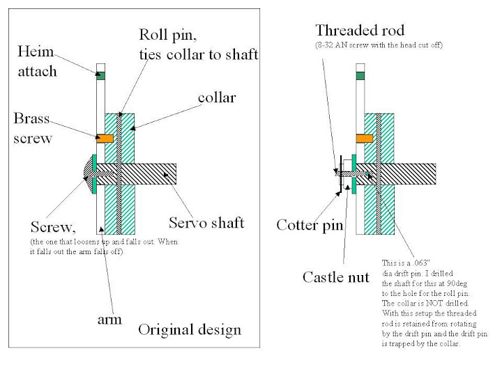

I very reluctant to post this, but I don't believe this is a airworthy installation without a positive locking feature for these screws. When the original service bulletin came out I inspected my servo's and found one of the screws loose. Believe me, a shudder went up my spine and I was angry with myself for not seeing this critical design flaw when I did the original installation. Loctite is NOT a sufficient locking feature when it comes to flight control systems. It will only be a matter of time before someone is killed when one of these screws backs out and the pilot will not be able to salvage the situation. I'm suprised that Tru-Trak hasn't realized the potential disaster that awaits them when (not if) this happens.
I propose that Tru Trak consider the following modification. This consists of installing a threaded rod (cutting the head off of a AN 8-32 screw?) into the servo shaft and securing it with loctite AND and a cross drilled precision ground 0.063" dowel pin. Note that the dowel pin only goes through threaded rod and the servo shaft, not the torque arm driving collar. With the collar installed the dowel pin is trapped.
My only concern with this modification is the fact that the 8-32 threaded rod has a considerable amount of it's cross section removed with the cross drilled hole. But this concern is mitigated by the fact that the threaded shaft has very low torque applied since the castle nut is only snugged up enough to keep the torque arm in place. The snugged up castle nut is retained with a cotter pin. I believe this will finally resolve this situation while retaining the ability of overpowering the fuse pin if the servo goes stupid. I've attached a screen shot (I hope) of a power point sketch (the dreaded Powerpoint engineering) of this design.

I was thinking along the same lines for a field fix but wonder what drilling for the drift pin will do to shaft strength right there. There is also the (slight) potential for the pin to shear, allowing the threaded rod to turn anyway. I don't think I'd consider it a permanent solution.
I believe TT will eventually have to re-engineer the shaft, probably making it longer and threaded and drilled for a castle nut at the end. When they do, hopefully they willl offer some sort of exchange program to get the fix out to existing installations.

I'm in for the set screw / red locktite and castle nut with cotter pin too.
