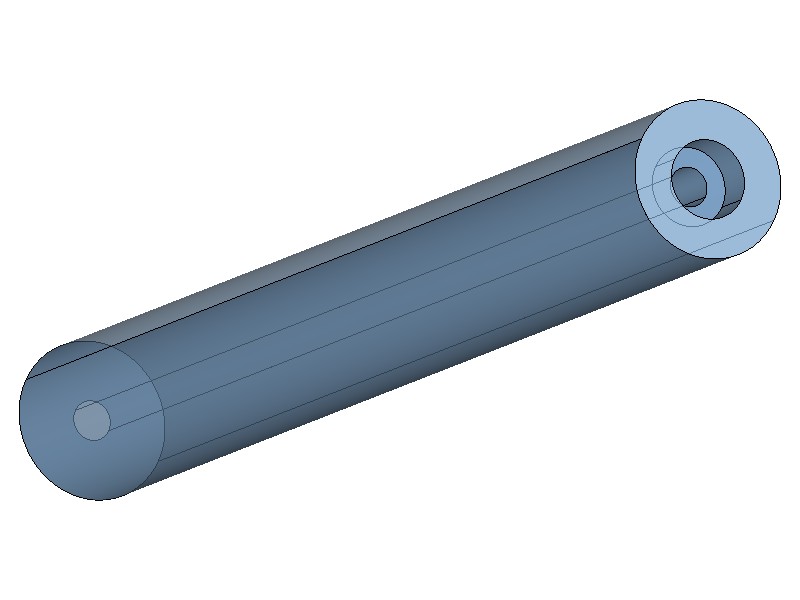

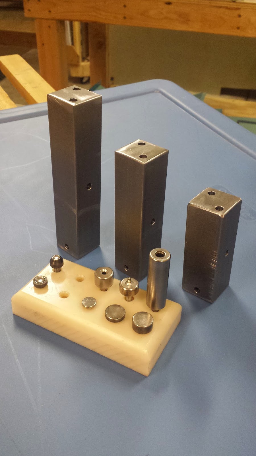

Supporting the material when punching out the rivet
My experience is that I have done unnecessary damage when trying to punch out the rivet shank once the manufactured head is drilled off. More so when dealing with thicker material like when dealing with spar doublers. At the advice of a friend at the EAA chapter meeting, I made myself various little punch guides.
I had ordered 1" dia steel round bar and cut a few pieces 1" long.
http://1.bp.blogspot.com/-LYatZ8ANFNA/VOKVwMfIcTI/AAAAAAAAAno/O_l4i7NVctM/s1600/IMG_1976.JPG
I then drilled a 15/64" hole in the center of one. Others I drilled off center. The 15/64" hole will allow the shop head of a AD4-X and AD5-X rivet to fit inside. When you are punch a rivet shank out by placing this handy little tool over the rivet, you support the area around it and you do not bend any aluminum.
http://1.bp.blogspot.com/-n1iXwTFerCM/VOKVwOIVzxI/AAAAAAAAAns/k54IT8M8lJE/s1600/IMG_1977.JPG
Drilling the 15/64" half way through the round bar will allow a friend to hold it tight as you punch without driving the punch into their fingers. (Ask me how I know!) This has saved me so much headaches in removing rivets :D
P.S. Use gorrilla tape on top of the steel guide so you don't marr the aluminum you are working on.

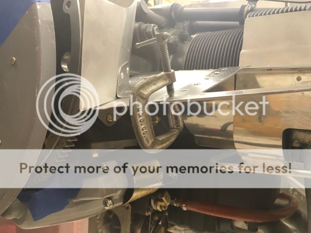

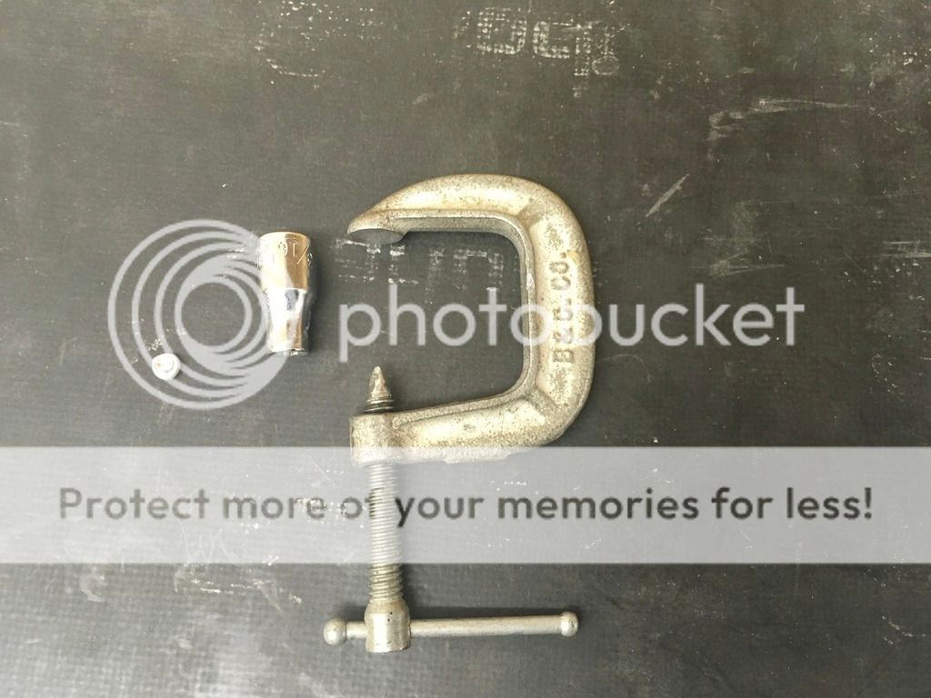

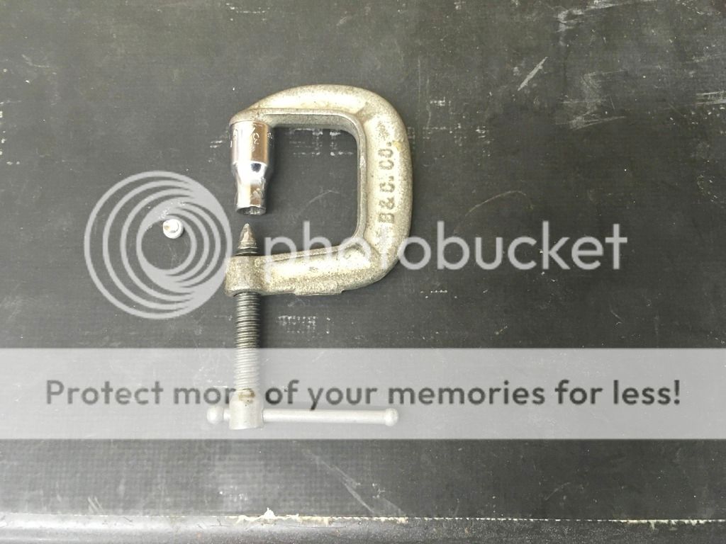

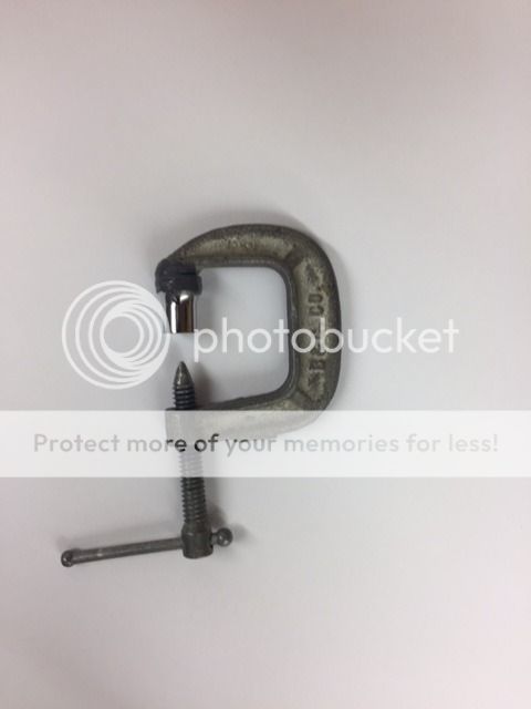

Rivet remover 'tool'
This works well with rivets needing to be removed close to an edge. I had the swivel head on one of my 1" clamps disappear. I rarely throw anything away, and finally came up with a good use for the dismembered clamp.
I sharpened the end of the screw in shaft. As the pics below show, I used a 1/4" drive 3/16" socket as the backing and receptacle for the shop end of the rivet to be drilled out.
Use the good advice in this thread to drill and remove the manufactured head of the rivet to be removed.
Then simply place the socket over the shop head of the rivet and screw the clamp shaft into the rivet. Works quite easily.
I used it for a while with the socket loose, and manually lined it up with the clamp. I finally broke down and used JB Weld to permanently attach the socket (which I cut shorter for a little more room between the jaws of the clamp)
I also recently discovered that when drilling the manufactured head off the rivet, and part of the head pry's up but not quite all of it, instead of drilling more, I place the tool over it and when screwing down it pops the manufactured head off at the same time as poking the shop head into the socket.

I had the occasion today to try to drill out a 470 and soon found keeping a drill (135 degree) centered to be nearly impossible. I made up a simple drill jig that centers the drill on the rounded head and sends the drill dead down the middle of the rivet. It can also act as a drill stop so you don't drill clear through. If you use it for a stop you will have to clear the chips from the guide tool several times.
Of course, a different drill jig will be needed for each rivet diameter. I did mine in a lathe because I have one, it can be done in a drill press by a very good eye for the center of the fixture. I do not recommend trying to make one with a hand drill and a vise.
I cannot be the first person to make one of these :)
