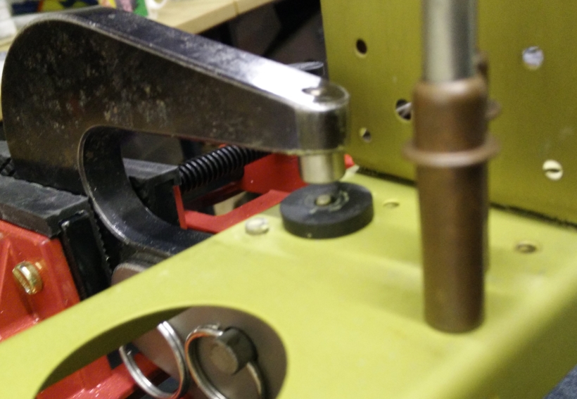

... the rivet squeezer and solid rivets are still my bane.
I had a problem with this as well until I bit the bullet and got a Cleveland Main Squeeze rivet squeezer. Not only did the quality of my squeezed rivets suddenly improve but it was way easier to use. My original squeezer simply required too much muscle and that led to poor quality rivets. A bit pricey but, to me, well worth the cost. It turned the part of the job I really dreaded into one that was easy.
Main squeeze is a great tool, I have not wanted a pneumatic yet.... then again wings are coming up

Another trick I learned here on the forum was to put a piece of clear tubing over the shop head side of the rivet that is slightly longer than the rivet shank extending. What this does is that when you start squeezing the rivet the tubing compresses and pushes the thin metal together so there is no gap when you set the rivet. I had issues like you did with rivet expanding and thin metal not being tightly together. After using this technique have not had to his happen again. 1/8 or 3/16 iD tubing works best. Glad to hear you are continuing on.

That's one of the aggravating things, I AM using a Cleveland Main Squeeze... :confused:
Solid Rivets
Modifications to the Avery or any other rivet squeezer can make squeezing rivets easy. Search for my post "Improvements to the Avery Rivet Squeezer" This allows the squeezer to be operated with one hand and the parts can be positioned with the other hand.
If there's room, one way I’ve eliminated the gap is to use a Cleco side-grip clamp in addition to regular Clecoes to hold the two pieces of material together.
http://www.cleavelandtool.com/1-Cleko-Clamp/productinfo/CLC100/#.WRkdynCSIvY
Put the side-grip clamp as close as possible to the rivet you are about to set and start to squeeze. You won’t be able to squeeze the rivet completely because the clamp will be in the way, but often times you can squeeze it enough that the rivet will start to expand and will hold the two pieces of metal together without a gap. You then remove the side-grip clamp and finish squeezing the rivet the usual way.
If there's room, one way I?ve eliminated the gap is to use a Cleco side-grip clamp in addition to regular Clecoes to hold the two pieces of material together.
Put the side-grip clamp as close as possible to the rivet you are about to set and start to squeeze. You won?t be able to squeeze the rivet completely because the clamp will be in the way, but often times you can squeeze it enough that the rivet will start to expand and will hold the two pieces of metal together without a gap. You then remove the side-grip clamp and finish squeezing the rivet the usual way.
I've done the same thing and it works quite well. I've also used small C clamps with the same result.

As for your rivet squeezer problem, I know exactly what parts you're talking about and I know exactly what your problem is you're having and why you're having it and I can fix it for you in about 2 seconds and you'll never have to worry about it again. You do NOT need to do anything fancy or out of the ordinary and you don't have to order anything expensive. The problem is the part you're trying to squeeze isn't being held down. Don't go spending a much of money on a new squeezer.
On the RV-12 on those rivets you're talking about -- and don't ask me why -- the tendency of the work is to turn as you squeeze, which puts the rivet head out of alignment with your squeezer. That's going to happen every time; ask me how I know.
Squeezing these rivets won't work (or at least it won't work well), unless you clamp down the assembly and then squeeze. Also you want to orient the squeezer so at the beginning of the squeeze you're putting pressure on the shop head (as I recall the parts you describe, I actually had to pull slightly on the squeezer) I can walk you through it.

That may be a lot of it. I have a hard time trying to clamp the work down (I also worry about damaging the work by clamping too hard). I'm also trying to keep pressure on the manufacture head but in the process I know I'm flexing the rib a little.
Clamp it down by the flange on a rib or two. Put a small piece of thin wood (I use those Home Depot shims) on the flange, and clamp it to a -- preferably -- EAA Chapter 1000 workbenches using your typical bar clamp.
This will make all the difference in the world and when you see your perfectly squeezed rivets (you know you've squeezed to the proper diameter when you feel a pain shooting up your arm. :) ) , you'll kick yourself for not doing it earlier.

I thought of one more suggestion. After cleco'ing every thing together are you reaming with a #30 ream the holes to final size before you try to rivet them? I had to do that for every hole so far on my RV-12. Once the holes are reamed getting the two parts to mate successfully typically can be done by simply squeezing them together with my fingers. I did have to use clamps on the bracket that attaches to the nose ribs on the flaperons to get those pieces to mate successfully.

As for the rivets I had some issues with them expanding in the middle of two parts and used a similar method as mentioned above (with the tubing) but using tap washers (all I had at the time).
The main things when squeezing is to keep the parts together and the squeezer flush, and not to over squeeze/use too long a rivet as it can cause the parts to bow away from each other (especially on bearing brackets).
Below is a picture of my 'tap washer' being used, This time I have the squeezer in a vice rather than the parts (I often find it is easier that way round, especially for nutplates and dimpling). The tubing will be easier to squeeze and it will also stay on and hold the rivet in place, the washer has a tendency to drop on the floor just when you have everything setup, and you can bet when you are bending down to pick them up the rivet drops out as you nudge it with your arm, oh and you will hit your head on something when standing back upright, but that is the fun of building :p
