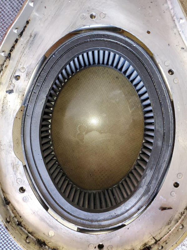

One thing I've never seen posted here is why not build internal filter supports on the upper and lower sides of the FAB? Those would effectively hold the filter in its proper dimension. Back in the olden days of carbureted cars which used this same configuration of filter, the filter housings were always designed with a lip of some sort to hold the filter on its ID, top and bottom.
You could use "skin stiffener" stock as used in control surface construction-- that 5/8 x 5/8 x .025 90 deg angle supplied in kits. In the non-prepunched kits, that material came in 6' or so lengths. Could call Van's to buy some.
Cut notches spaced about an inch apart to allow the angle to bend enough to make the oval shape. It doesn't need to be perfectly contoured to the filter shape; the resulting flats from the notches 1" apart would be fine. It would be a good idea to drill small holes at the ends of the notches to prevent cracking. Make 2 and rivet those to the top and bottom of the housing.
You could shorten the angles a bit so as to not block the filter media, but on K&N's there's at least a 1/2" of non-flowing area top and bottom anyway.

I lined the bottom of the airbox with .063 sheet, ProSealed in place. The aluminum gets a little fretted over time, but should last the life of the aircraft.

I do think a aluminum sheet in the bottom half of the FAB is a good idea, as we replair quite a few FAB's where the air filter has eaten away at the bottom of the fab from movement.

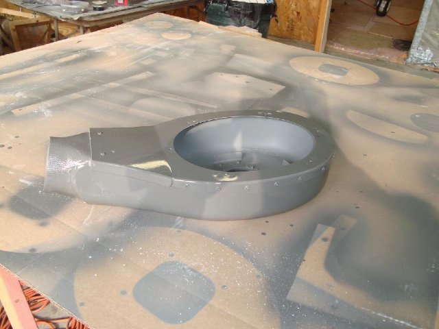

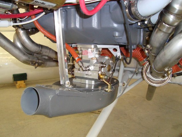

I agree with the above. I have been flying my RV-4 for 20 years and have struggled with shrinking air filter and cracking air bracket. I solved both problems as follows:
I redesigned the air bracket by remolding with fiberglass. I have no metal in the bracket other than nutplates and filter retainers. The input opening to the air induction is round not oval. The opening is only about 2" diameter and I mathematically calculated the inlet flow far in excess of the air requirements.
Nothing on the bracket touches anything on the cowling and does not require any support brackets. A fabricated gasket was made from wet suit material of which I recently replaced. I have flown it for several years and several hundred hours and never have had a single problem. Dave Anders helped me with the design of the inlet taper degree which gives me about 1/2" more manifold pressure than the original bracket. It is a lot stronger and lighter than the original Vans designed bracket.
I am careful about over priming so I don't get any fuel in the air-filter assembly. I drilled a small hole in the bottom aft part of the air filter bracket that drains fuel or any liquid that may get into the filter box area. I don't clean the filter unless I can not see light through it. It stays pretty clean most of the time. I do knock out debris like bugs etc. It does shrink a bit but I simply stretch it back out by grabbing the sides opposite of each other and it returns to the normal dimension.
On inspection, I check the inlet to the engine on the fuel servo and it is always sparkly clean so I figure I must be doing the correct thing as far as filtering the air is concerned.
Hope this helps someone
