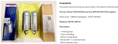

Some builders in the UK with the old fuselage kit plan to install the Andair PX-375S pump instead of the Rotax pumps. It is smaller than even the old Rotax pumps so it doesn't need the larger inspection panel.
But why not continue production? No R&D, no testing, no nothing. It is a known production product that has an existing market.
Actually both the old and new are Bosch pumps and available aftermarket. Right now spending 3k$ on pumps from Rotax doesn't make sense to me. Rotax simplified the parts stream as they now have one pump for all 9xx series engines.
Any chance you know the Bosch p/n for the current pumps used on the RV 12 before the new update?
The Bosch pumps were discussed in a VAF thread last fall, which mentioned that they can be sourced from a Norwegian auto parts company. See post #85 in this thread: https://vansairforce.net/threads/2026-rv-12is-upgrades.236552/page-2 (photo below). However, that doesn't include all the associated plumbing pieces, filters, check valves, etc.
Also, Paul Dye and Louise Hose had an article on AvBrief.com on 10 Feb 2026 that included photos of the new pump & plumbing assembly installed on the aft cabin bulkhead, and where the fuel lines come through the firewall. The larger-diameter plumbing is visible in those photos.

I remember reading somewhere that there is a Bosch pump that appears to have identical appearance and specs to the Rotax pump (wouldn’t be surprised if Rotax uses rebranded Bosch pumps). I’ll have to see if I can dig that up again.
My pumps came in a box with a Rotax label, but the pumps themselves are clearly stamped Bosch. (These are the new pumps.)

I emailed the tech support at Edge Performance in Norway, as they sell the Bosch equivalent of the new pumps. Unfortunately, they said Bosch did not manufacture the 889691 pump, and don’t know of an equivalent. I did find that you can still buy (for now) the entire dual pump system and housing, but it’s obscenely expensive.
Rotax 921/915 retrofit kit #481377 contains two pumps and the hose connection kit. Last check it was $950 at Lockwood.
I have been wrestling with this issue myself since the Service Letter from Rotax came out last year. I think it's imporatnt to realize this is a Rotax issue not Van's. Rotax is forcing the change. Rotax 889691 pump and its predecessors were custom built for Rotax. The pump is by Bosch. The new pump as experience in th 915, 916 has proven to be reliable, more so than the previous 912/914 pumps. Yes the higher fuel flow rates associated with the new larger pump helps reduce the risk of vapor lock but I think the primary reason for change is Rotax wanted to support only one pump for the 9xx series and improve pump reliability. Van's was forced into the change because Rotax started shipping the new lrger pump as standard in the 912is power plant. Asking Van's about the pumps won't get you anywhere and yes I suspect there will be hair pulling and muttering when a 889691 pump fails and has to be replaced. The old style pumps on 912's has been a weak point and failures are not unknown. So I have decided to pull the trigger and do the plumbing change, spring for new pumps (ouch $3300) and will have a couple of old style 889691 unused sitting on the shelf for sale. Kind of like a radiator and oil cooler. The ultimate reason is I have not attached my tail cone yet and thankfully I took the position of waiting until the absolute moment to do so.
