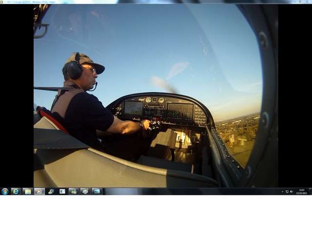

As I've mentioned before, our RV-12 has dual 10" SkyViews, an SL30, lighting kit, power for ANR headsets, switchable fuel pump, intercom and the Dynon autopilot.
Normal cruise power consumption is around 9A and with everything on it might go as high as 16A.
And proof it flies when all lit up :)
