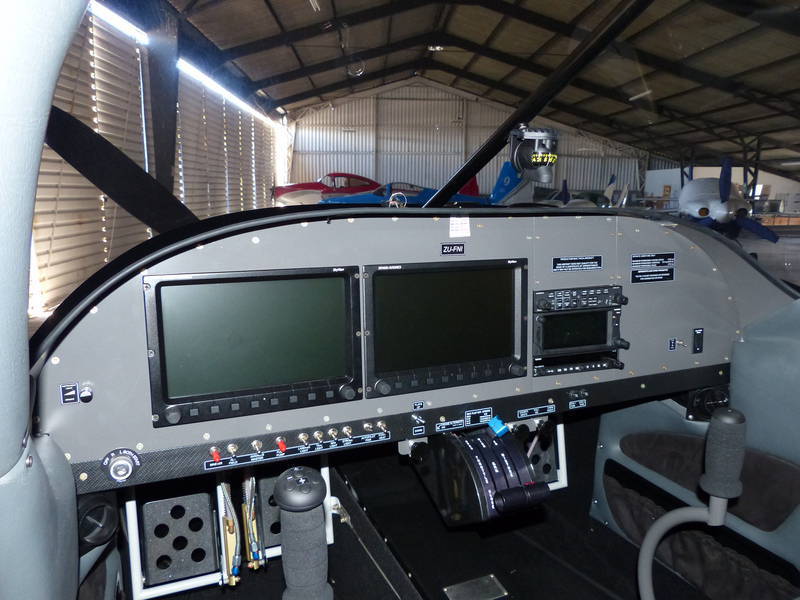

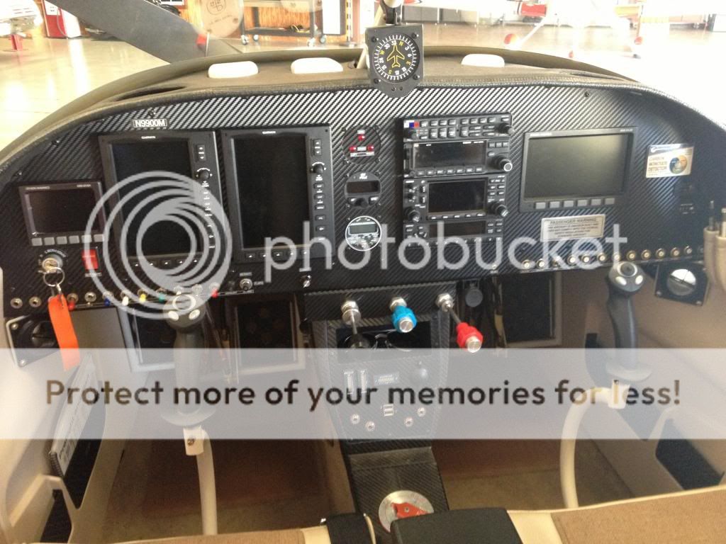

It is carbon fiber. I'm not sure if it's a veneer or solid (eagerly waiting to find out), but the samples they sent me lead me to believe it's the latter.
Thanks for the great folks at Aerotronics, I’d like to present to you my panel for the RV-10.
We’ve been working on this for the past 18 months and I’m really happy with the final results. I got exactly what I wanted with regards to equipment, a professional layout, and the Aerotronics team was able eclipse my expectations with regards to functionality and resiliency. Some of their ideas for the design of the electrical system and integration of the components exceeded what I would have been able to come up with if I had rolled my own panel. So I’m a very happy customer.
The electrical system is dual buss/dual alternator/dual battery. The primary displays are the Garmin G3X with the GPS and XM options. I have a Dynon D6 that is backing it up for a rainy day. The audio panel is a PS Engineering 8000 BT. The GPS is the Garmin GTN-750. The second NAV/COM is a Garmin SL-30. The transponder is a remotely mounted (controlled through the G3X) Garmin GTX23 ES. The autopilot is the Garmin GX Pilot.
The Dynon has a backup battery in it and we went ahead and put a TCW battery on the second DC input of the G3X too. All of the critical pieces of gear are attached to both busses. I’m very happy with it from a resiliency perspective.
At OSH this year, Garmin announced their GDL-88 ADS-B system that can be plugged in to the GTN750. So this panel is pre-wired for the GDL-88 system. The GDL 88 is not available yet, but when it becomes available we’re ready to go by simply plugging it in. This will give me the ability to display TIS traffic / XM weather on the G3X display while simultaneously displaying ADB traffic/weather on the GTN750. The idea is to use both over the short-term and when I’m satisfied with ADS-B coverage, I can get rid of the XM subscription all together.
A few other things about the panel, it’s has a built in CO detector. It also uses an AN-21 annunciator system (that’s what is driving the small annunciator LED’s on top). Also it includes the control head for a 4-Place oxygen system.
Needless to say, I’m really happy with how the entire panel turned out and the functionality/resiliency/modularity that it offers. This wasn’t the easiest process for Aerotronics as I was wanting to do some unique things such as the burl woodgrain, but they worked with me all the way through the process and I think we ended up with a custom panel that we can both be proud of.
Geoff Combs of Aerosport Products also deserves a word of thanks too for providing an attractive panel option for the RV-10.
A higher resolution image can be found here:
https://www.dropbox.com/s/kbdc6wbvkbsetlf/Perry_Panel.jpg
The autopilot is the Garmin GX Pilot that can be coupled to either the G3X or the GTN750.

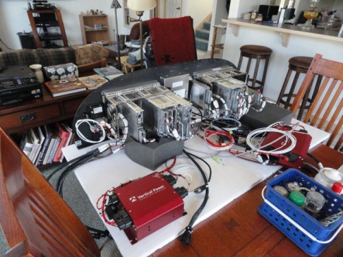

Here's a small image (from my KitLog) of the back of my panel:

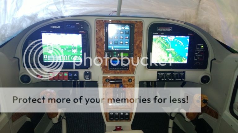

My Completed RV-10 Instrument Panel
Here's my completed and installed panel in my RV-10. Specifications below. All work was performed by myself

Thanks everyone. It's been a ton of fun planning and executing on this vision. Obviously there are a number of suppliers that make this possible, but it's the vision I had of when I first saw the potential in the RV10.

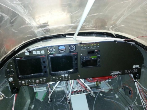

You've seen the panel before, but I finally got it into the airframe and the power circuits done. Plenty of red Xs due to nothing being connected yet, but the big step is done!
Very nice G900x panel. The only thing I don't like about this setup is that you can't get a big map screen in front of the pilot, but its a great system. You'll enjoy flying behind it. The VP-200 is my favorite part of the system. Such a shame thru discontinued their flagship product!
So I powered up my panel for the first time today. No smoke, no fire. While I did pay Stein to do the wiring schematic for me, I did all the wiring and built the harnesses myself (don't look behind the panel, it is a mess)
I could even hear the AWOS over my headsets with my newly wired jacks!
Special thanks to David Buckwalter of Avionics Systems here in my home town, wealth of knowledge and always helped when I asked, Geoff Combs for the panel and cutouts, also never refused to take my calls and Stein for all his staffs support as well.

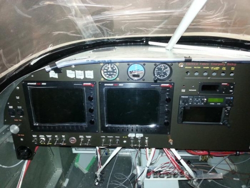

Finished panel
After flying so many years with the old steam gages it will be very nice to fly a modern panel that I designed and built.
Dynon was used for most everything including autopilot, transponder, ASDB, and #2 com. I have a GTN650 and a PS engineering audio panel.
I wanted to put a 10" display on the far right but it wouldn't fit so my copilot got a 7".

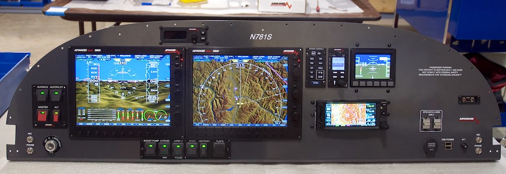

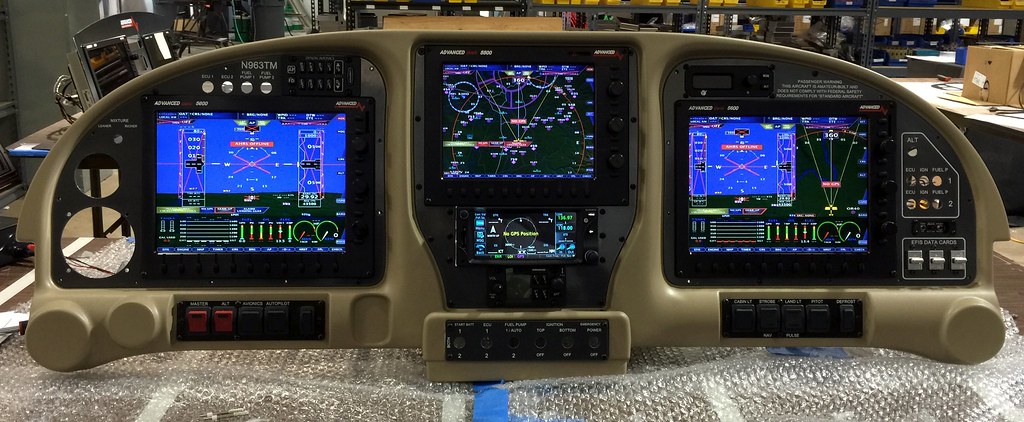

New RV-10 Quick Panel almost ready to ship. Two AF-5600T Touch Screens, PS Engineering Remote Audio Panel, ADSB,
Remote Mode S ES Transponder, D6 EFIS, GTN-650, AFS COM, TruTrak AF-Pilot, Dual ADAHRS, AF AP Control Module and USB Smart Charger.
It took about 30 minutes to wire and configure the panel this morning for testing. All we had to do was plug in all of the pre-made harnesses to the
Advanced Control Module and turn on the power. It all worked the first time. It's amazing what proper engineering and quality control can
do to eliminate headaches. Not only is it far easier for us to build, it's a lot easier for the customer to install, maintain and upgrade
components in the future.
All weather data is even shared between the screens, you can even change between ADS-B and XM with the touch of a button.

Rob - A couple questions I've probably missed during your product introductions. Posting here instead of a direct email - maybe others are chewing on the same...
1) Can the components of the quick panel concept be moved around on the panel? Comparing the RV10 to the RV7, you've moved the EFIS to be side-by-side. Do we as customers have flexibility with a panel design? Something crazy like moving the Aux power outlet 2" to the left? Or a horizontal COM panel instead of vertical. ;)
2) I saw in the RV7 post the integrated switch module used and it got me thinking about failures. Are the switches independant entities or if there is a failure would the whole module have to come out?
3) You don't show interior light switches (probably others I'm not thinking of) in the pictures - can we add on more switches to the module as we see fit to suit our interior or would those have to be sourced independently?
4) Similarly - how do you handle future upgrades to avionics? ADSB-out as an example (not knowing what new box we'll need). What provisions do you have in the control module?
I see the time value as a builder, but I'm looking at the trade-offs.
Tim
Tim
Yes, we can move components around. This was a custom panel layout for a customer.
2) I saw in the RV7 post the integrated switch module used and it got me thinking about failures. Are the switches independent entities or if there is a failure would the whole module have to come out?
Most of them are independent, only the lights and flaps get routed through the Control Module CPU. The module has two separate avionics relays and a great deal of thought has been put into which components should be on which avionics buss.
We have a few different switch modules and they are on a PCB. For example, Van's did not want a panel-mounted flap switch for the RV-14, so it's on the stick. We can add a switch outside of the switch module if you need something custom.
The control module is already configured for ADS-B in and out and so far, all of the panels have had
our Mode S ADS-B out transponder and an ADS-B receiver.
