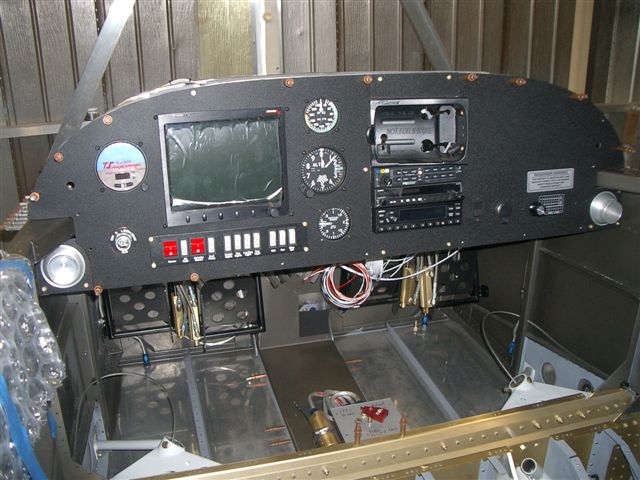

Here's my panel. The left side equipment has been rung out and it all worked off the bat except for 1 extra wire I needed to clip to make my landing light "on" indicator work (had an extra ground). No smoke, no sparks, no major errors. The stack is wired and I'll start smoke checking that this coming week. Just hung the engine so I'll be starting those wires over the long weekend.
Tail is mounted, seats are done and will be recieved this week. Wings have been mounted. Leaves the engine wiring, the cowling (with camlocks), the gear, canopy and top skins and final assembly. I have all parts in hand except for a verticle card compass.
The boost pump was silent when I powered it up. I had good current to the pump terminals so... I "primed" it with a soft mallet and on the 3rd light "prime" it started whirring like an angry nest of hornets.

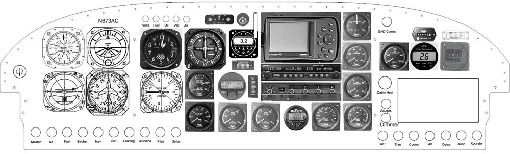

Anyone see any problems with this layout?
Doug Mattson
RV9A
Doug:
It's all relative, relative to your mission. Probably should give us a bit more background before you ask for input.
Slider of tip-up?
VFR - IFR - night?
what EFIS?
GPS?
First thoughts: your switches are on the panel support frame, must move them.
Recommend the EFIS be higher to fall closer to your central vision.
One com radio suggest you are building a VFR panel but, who can be sure. If VFR, why the A/S and ALT? You can buy A/S and ALT options for the EIS as your VFR back ups.
Better info will generate better input from the forum.
Jekyll
Doug,
Check your PM.
FYI - you can't put your switches down there with the Affordable Panels panel. The frame for the panels is under your switches.
Also, you don't need your engine monitor on the left. Center your EFIS and move the monitor to the right side.
VFR
Slider
I already have the alt and as.
I am building this panel myself and the bottom 2 inches will not be covered up so the switches should be ok. The dynon is so low to miss the panel support on that side. I think the GRT is about a grand cheaper than the D10.

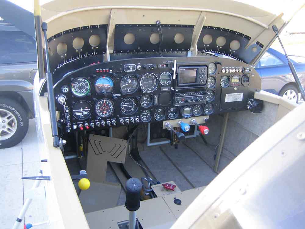

N754RV Panel
Well here it is thus far: Wiring up now. The holes on left and right are for the parking brake on left and cabin heat on right.

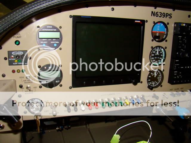

The panel is finished!!!!!!!
Hi Gang,
Well the panel is finished! It was over 200 hours of effort. I'm VERY fortunate to work at SteinAir as I had lots of help from our expert panel builders. Big thanks to Stein, Jed, Mike and Dan at SteinAir ..... and Rob, Jenny and Tricia of Advanced Flight for all of their help. I hope to have it installed with the front windshield/glass this week, and then it's off to the airport. She should be ready to fly soon (now if the Minnesota WXR would cooperate). Whooo Hooo!
PS I have entered Direct to KFCM on the 430W and it also shows on the AFS map screens. Additional info appears in several other places on the EFIS about the current waypoint/ETE etc... I just hooked up the ARINC interface and hope to have that going on Monday. The AFS EFIS with the 430W & Tru Trak A/P is a very good combo. This is a very good time to be a builder.
paul

Hey Paul,
Great panel!!!! If doing again, I'd go with virtually the same thing. I might try to add in the Vertical Power system to eliminate the switches and breakers but other than that..... Love the AFS stuff!!
What is the device above the Trutrak?
Darwin,
It's a clock and a CO detector. The switches are for A/P source select for ARINC and GPS. Can't have enough clocks...
