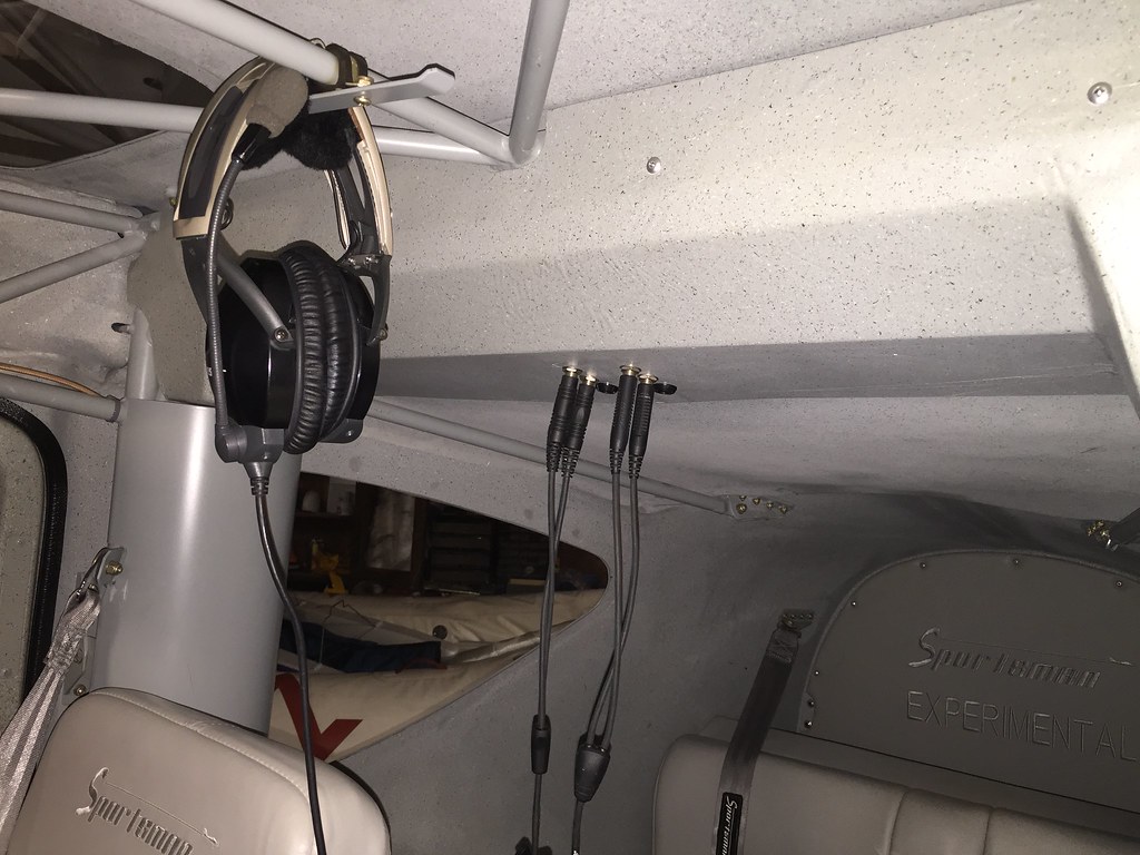

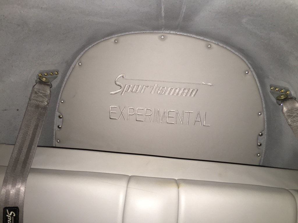

Rob - I'd appreciate learning from your experience on the console vs panel mounted plugs, if you don't mind. We're building a Glasair Sportsman and haven't yet committed to a headset jack location. Given the Sportsman and RV10 both have doors, the exit from which could easily be fouled by headset cords (a concern for me), what advantages do you perceive the panel mount location to have over the console?
At the moment I'm considering installing our jacks on a closeout panel virtually behind the pilot and passenger's heads (about a foot behind their heads when seated). I'm thinking this will keep the cords out of the way and yet keep the jacks accessible should one need to swap headsets.
Again, I'm happy to learn from the experience of others, so please fire away!
This is an easy one....
I just happen to have one of those in my hangar somewhere.
We are currently installing a new Advanced Quick Panel in the Sportsman, how is that for experience.
The stock TWTT location works great.

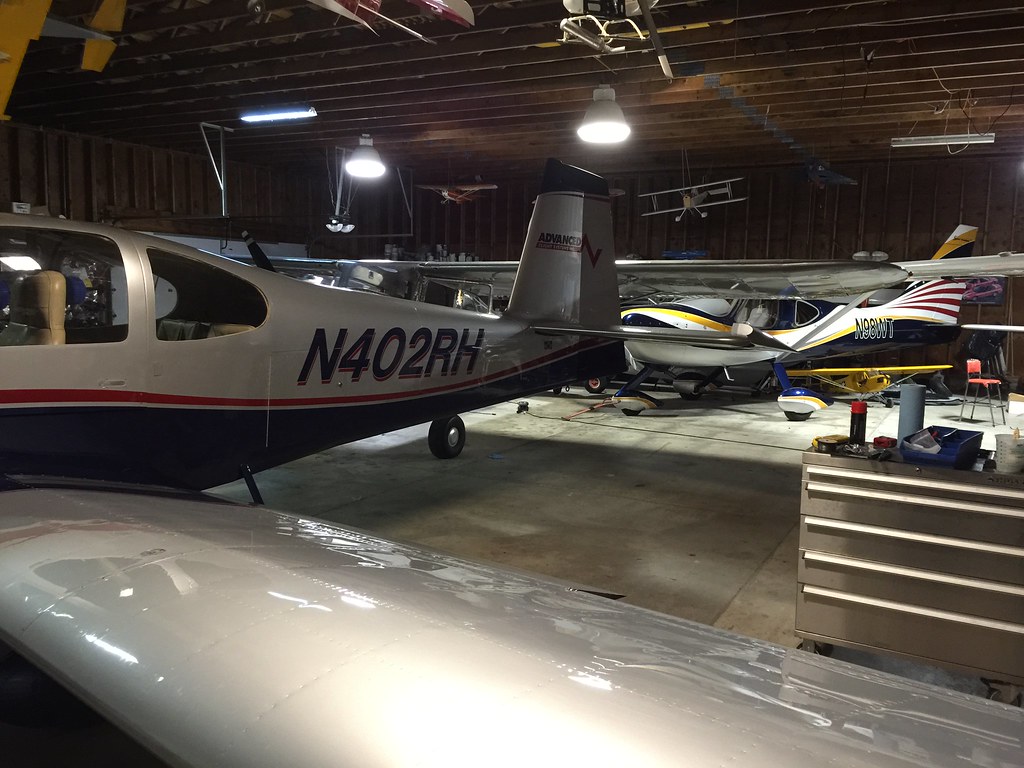

Rob Hickman
Advanced Flight Systems
N402RH RV-10
:) Sorta figured you might have one hanging around, Rob! :rolleyes:
Thanks for sharing the photos. I've got to do some more "fit checking" as I'm thinking of mounting the headset jacks a little more outboard so they won't be in the way every time I reach for something in a seatback pocket.

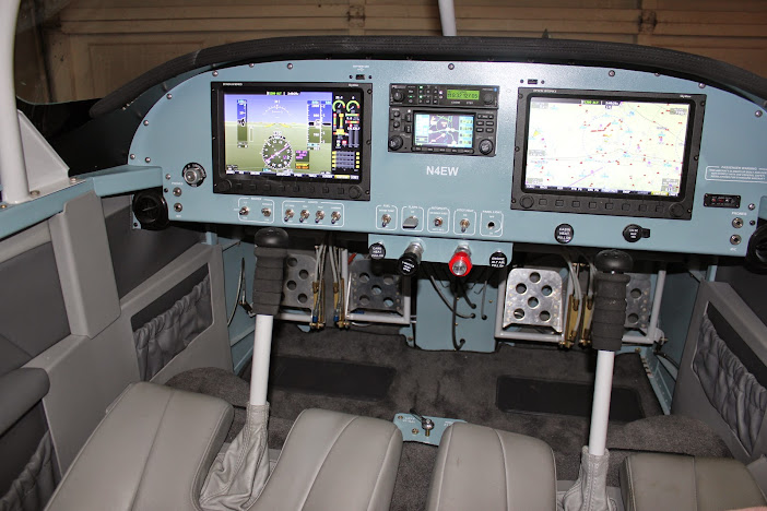

Here's a photo of my panel that demonstrate the size, symmetry and functionality. The panel is a custom composite panel leather wrapped wit the same leather that will be used for the interior and seats. Center stack is a Garmin 750 and SL 40. The transponder and audio panel are remote mounted. Extensive redesign of the panel and sub panel were necessary (slider) to make it work. The results are an extremely solid structure that is more solid than stock. Because this is a slider, with limited access after completion, everything was designed with access and serviceability in mind. Service loops were incorporated into the EFIS harnesses. Removal of the EFIS provides access to everything!!!

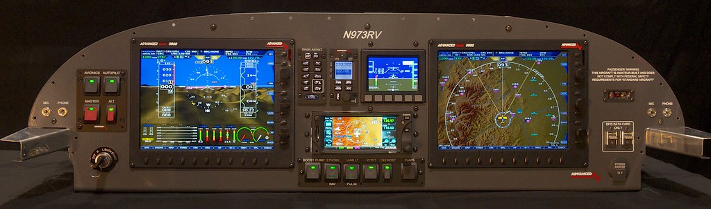

Here is a picture of an Advanced Quick Panel for an RV-7 getting ready to ship.
Configured, tested and ready to install with the following equipment:
Two AF-5600T Touch Screens, D6 EFIS, Autopilot, AF-Com, GTN-650, Remote Mode S ES Transponder, Multi screen ADS-B Weather-Traffic, 406 ELT,
Lighting controller with Wig-Wag, Flap Positioning, Auto Trim, Advanced control module, Remote USB data jacks for easy database and logbook updates.

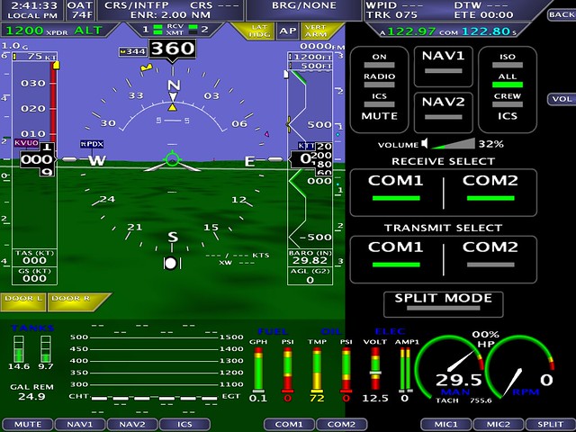

Where's the audio panel Rob?
AFS IFR Panel - PAC15 Audio Panel
The Advanced RV-7 IFR panel uses the PS-Engineering PAC-15 remote audio panel. I have had this installed in my RV-10 for over a year and it works great.
