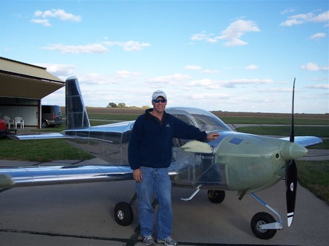

Just a little encouragement for those building a -12.
Besides being fun to build, they are really fun to fly too!
Keep pulling those rivets!
