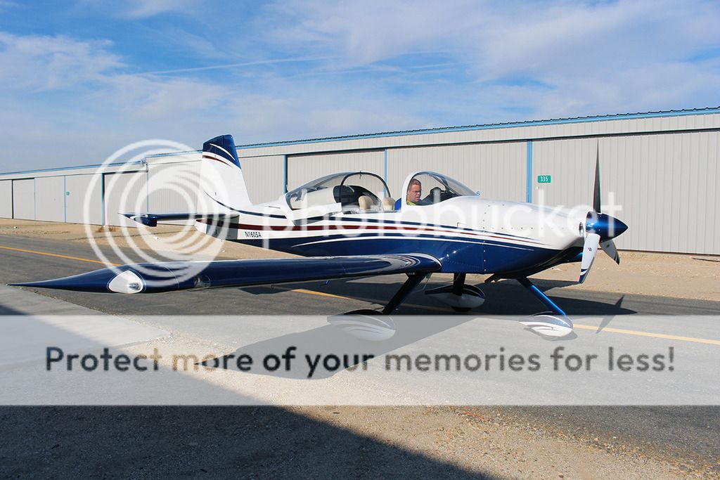

Got my first weight data yesterday, with IO360 and Whirlwind C/S prop, full glass panel, dual alternators, battery in the mid-tail, extended range tanks and complete Classic Aero interior (seats, side panels, carpet, the works).
Empty weight is 1111 pounds at 77.92" from the datum, just about 10 pounds heavier than I anticipated before I started building. Blasted primer.... :D
1111...that's an easy to remember number! I'm hoping to have mine weighed in a couple of weeks. Minimal upholstery, Catto FP prop, lightweight starter, single GRT Sport SX display, no exterior paint, so I'm thinking' 1050?

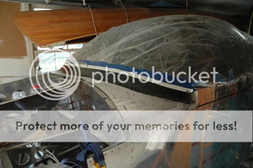

Canopy
Finally had some time after the Holidays to Sikaflex in the aft window on my tip-up canopy. Lots of clamps, but the mess was manageable.
I couldn't help pulling back the protective plastic to see how it looked. I had beveled the aluminum skin which gives a nice finished look and also provided the necessary space between the window and the skin for the Sikaflex.
I was pleased with how the two sections matched-up. I'm thinking I'll add a fiberglass targa strip to help with noise and to keep rain out.

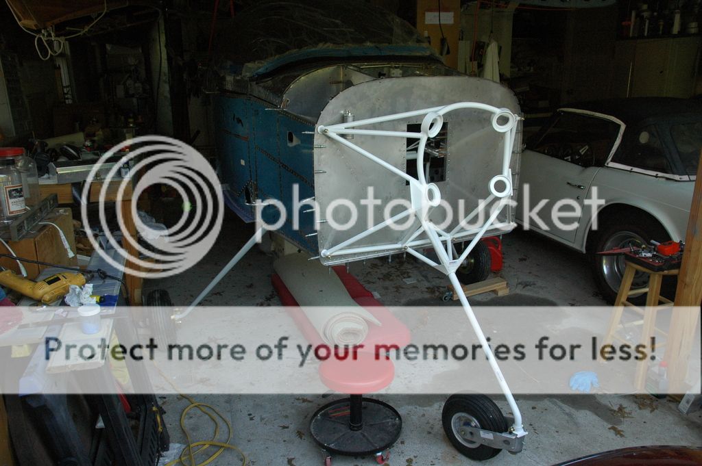

She's got legs.... :D
Got her up on her wheels the other day. Thanks to Tim Emig for his help drilling the fire wall and attaching the engine mount.
Getting the gear on is a big step! Now it looks like a real plane, and neighbors don't think you're building a canoe anymore. :)
The only downside is it's harder to climb inside...easily remedied when you put the wings on.

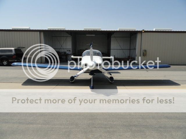

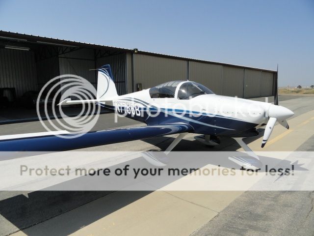

Did W&B today...
I did weight and balance today, the good news is there is no logical way to get outside of the CG range without doing something almost impossible. The bad news is N183RC is a little chunky, about 40lbs over target. I came in 1113 empty with all pants and fairings, empty fuel. There was a single headset in that number.
It's a RV-9A, tip up, O320, Sensenich fixed, Sensenich aluminum spinner, D180, Dynon AP, GTX327' SL30, 496, electric trim, mid level interior. Painted in and out.
1113 with everything, 1103 with no fairings or pants.
Is that about right?

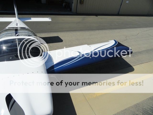

Painted
Picked my newly painted airplane up from Art-craft Paint in Santa Maria, CA last week. Paint scheme by Scheme Designers, Inc.
Looks great Bruce! I dropped my -7 off the week before they finished painting yours and saw it in the hangar. Art-Craft is a great shop!

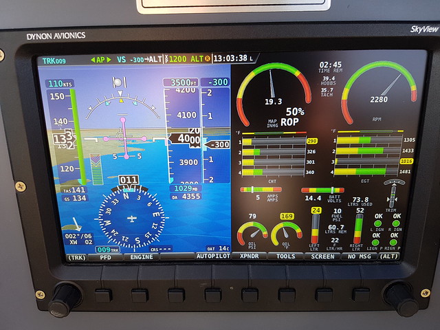

40 Hours DONE!
I can't quite call the project finished, but close enough is good enough, for now...
I finished the initial 40 hours flight testing today, and thought I'd celebrate with a bit of coastal flying on the way back to Cessnock. You know, some poor buggers pay hard earned cash for this kind of thing!

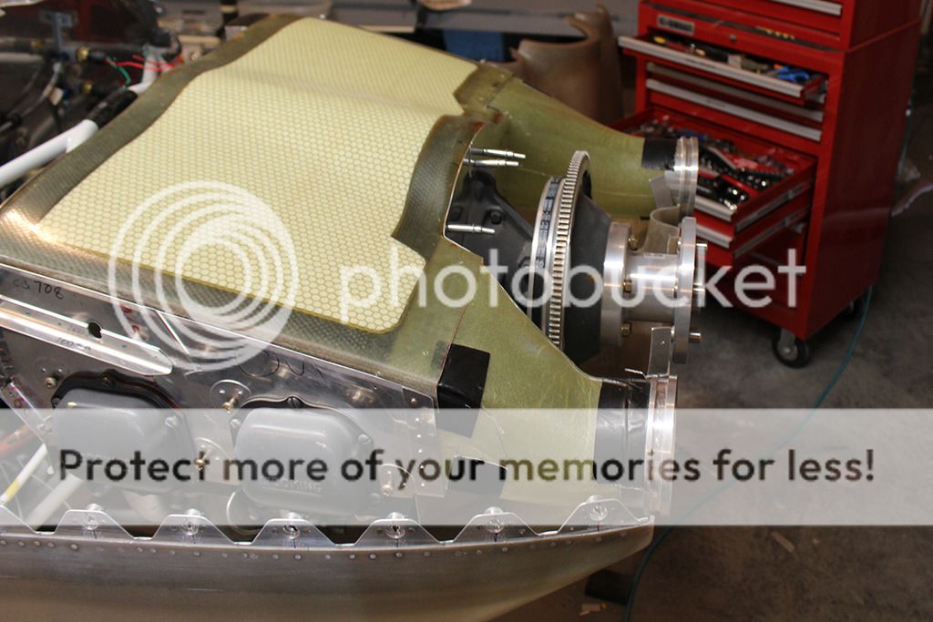

Cowling
I have been struggling with my cowling and baffles - just like everyone else. I was fortunate to have Darin fly over from the Seattle area today to show me his James cowl, plenum, and everything else I am trying to get finished. He wouldn't even let me fill his tanks up. Thanks Darin. I really appreciate it.
Sometimes just seeing something in person can make all the difference. It was a great afternoon and I am ready to keep moving forward.
Here is a picture of Darin's beautiful 9A.
[URL=http://s1245.photobucket.com/user/rockwoodrv9a/media/A-1_zpskpvdlg0q.jpg.html][/URL]
Here is my plenum and baffles as they are now. I need to lower the back a bit for more engine clearance and glass the ends of the scoops so they fit tight at the plenum. I still have to trim the cone areas to allow for the wet suit material joint between the ring and glass - but that will come later. Now, back to wiring!!
[URL=http://s1245.photobucket.com/user/rockwoodrv9a/media/plenum%20a_zpswkz25qvm.jpg.html][/URL]

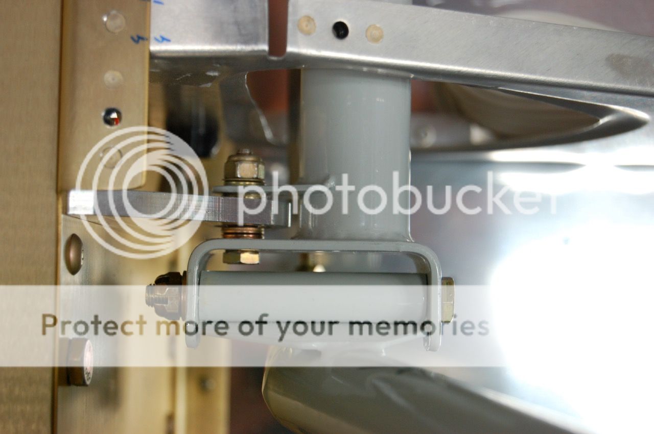

It's progressing nicely David. Hey if you have plans handy can you take a look at brass bushing specs? Inside the control column below the stick. Mine has an untolerable play and I want to machine a new one.
David,
Another question for you (thanks for posting the pics...). I see that you installed the ' Almost a -14 Mod'. I have done so as well. How do you plan to close/latch the right side of your canopy? I am not too sure about all the additional connections and linkages introduced by moving the long torque tube aft from its factory designed position. I am looking for alternatives and may just go with an independent latch on that right side corner of the canopy. What are your plans?
Thanks in advance - enjoy your Sunday!
Lars
Vlad, Is this what you're looking for?
