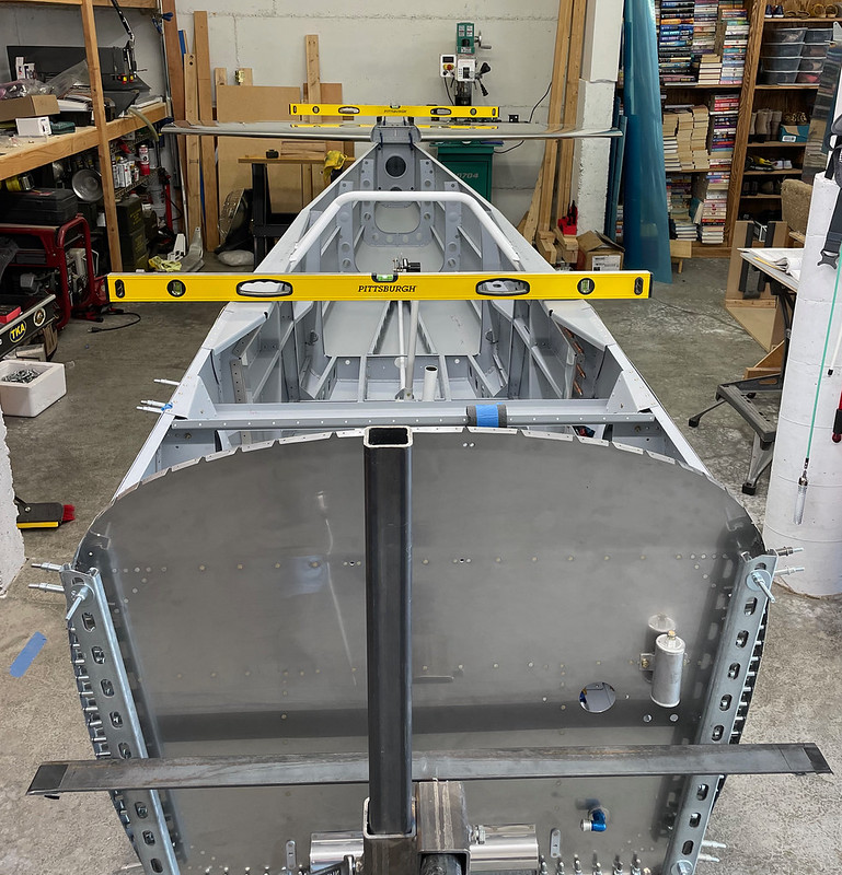

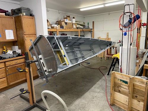

Ready to drill horizontal stab onto upper longerons. Waiting for tech advisor visit before doing the deed!
Looking good. Love that jig for rotation. Got me thinkin.. ;)
A friend of mine welded it up out of spare steel tube stock he had. He used it on his RV-7A build, then passed it on to me.
I was all set to buy an expensive auto-body rotisserie. But, this was free so...
I use a lift-table from HF as a dolly for raising it up and down and moving it when needed. Its also useful for leveling when needed.
Hi Ken,
is that a QB fuselage? The reason I ask is that the F-801L backing plate on the firewall for the rudder pedals, is upside down on the (aircraft’s) right side. Refer DWG 60.
I have seen this same thing on another QB fuselage, where one was inverted. It would make it a lot of fun (not) setting up the pedals!
Rob.
Hi Ken,
Rob.
Ha! Good catch. Thank you!
Glad you pointed it out now, before I drilled those holes. I'd like to think I'd have realized it was upside down before I drilled it. But, ...

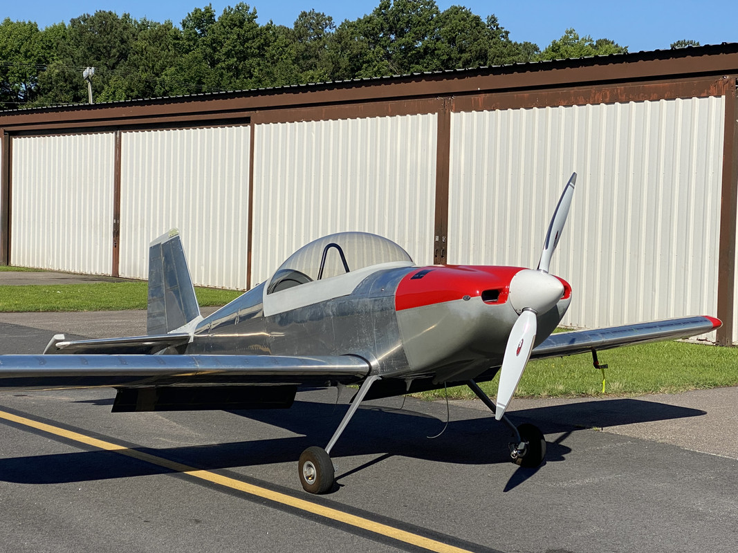

Weighted the planed today.
1096 lbs
76.88 CG
Still need wheel pants and paint. The red on the cowling is 2080 wrap. It’s a failed project. The engine heat causes it to bubble. Wingtip wrap is looking good.
1096 lbs
76.88 CG
Just curious. I'm not trying to be a downer here but I notice this CG is out of the CG range in Van's plans, at least per my earlier RV-8 (1999 start and 2005 finish). My plans reference says the CG Range is 78.70 inches - 86.82 inches aft of the datum.
I know you haven't painted this yet but assuming my numbers are still the standard are you concerned about the final CG location? Paint will add weight and change the CG but you can't know how much until you paint it. Also Van's illustration shows the measurement taken from an aircraft in level flight mode (some folks forget to do this :rolleyes: but a leveled aircraft will move the CG aft compared to an aircraft weighed with its tail on the ground (the weight obviously doesn't change.)
Just for reference, I recently weighed my -8 and the numbers were:
EW: 1138 lbs
CG: 79.81 inches
Chris
76.88 is probably an empty CG. With 40 gallons and 180 lbs in the front seat, he will be at 79.14. Good to go.
The CG range in the plans is for the plane in flight with a pilot and gas not the empty CG. The empty CG in the Vans sample WB document is 76.26”
This is correct. My battery (EarthX) is on the firewall, I have an RV200 composite prop and the grove one piece gear. CG with me, wife, fuel and baggage will be right around 83”.
