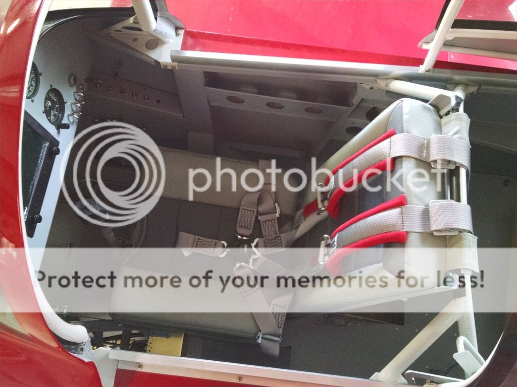

I plan on using an RT A400 mounted horizontally on the left side between pilot and passenger. I always brief my passengers that in the unlikely case we end up on the ground inverted, the fire extinguisher doubles as an emergency canopy breaker if required.
Interesting. What's the thinking behind using a T-handle throttle quadrant, but a vernier mixture control?
Ours is all on the throttle quadrant.
Simply personal preference. I like the precision of the vernier for mixture.

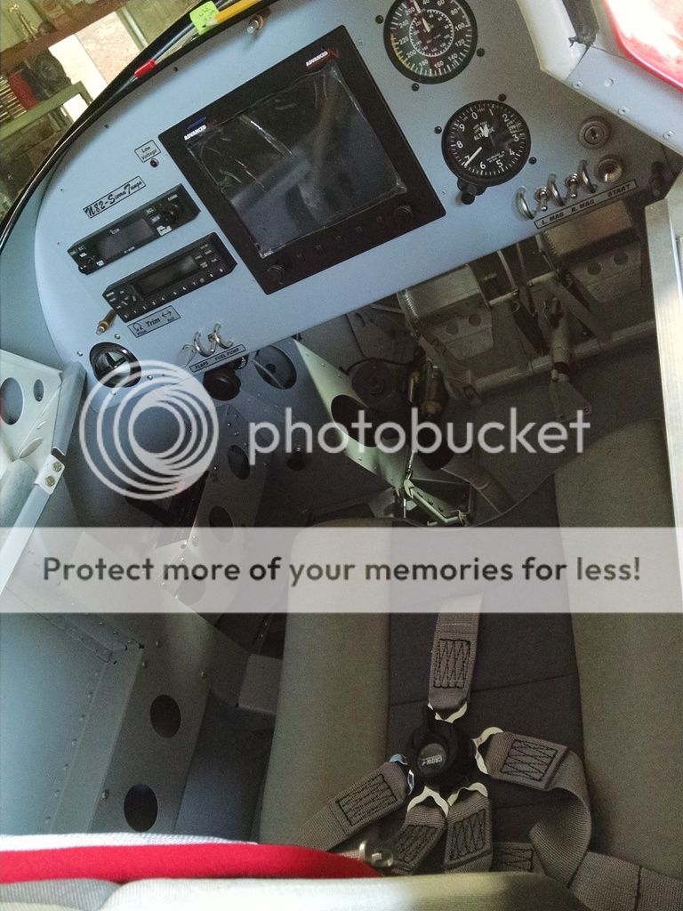

Steve,
I think your bracket and vernier mixture control is smart. I'm very unhappy with my "deluxe" throttle quadrant with one friction control for three levers.
Could you tell me the source and part number of your vernier cable so I could modify my RV-8A too, please? (I assume your engine is fuel injected.)
I don't see your heater control and alternate air pull cables. You might also want to consider one for an oil cooler door -- I'm finding that to be very necessary.

Joe, I was not happy with the friction either on my quadrant. After a little investigation it turns out the designed friction is not the best. It pushes on the side of the quadrant. I oversized the hole in side of quadrant and added a shim"al. Tubing" so the friction knob pushes on the plates only and not the side of quad. Works perfect now, also made a new friction lever. Pics on KITLOG, link below

Joe- my engine is carbureted. I did send back the 55" mixture cable that came with the FF kit and replaced it with the 51.5 inch length.
Re cabin heat and carb heat, the photo doesn't show it well but those controls are on he right console below the cb's and in front of the cup holder. Obviously the shiny piece of alclad there is not yet painted.
Joe- my engine is carbureted. replaced it with the 51.5 inch length.
Since mine is F.I., I'll most likely need a different length. Guess I need to measure.
That should be good (although my preference is to have the engine controls grouped together). I mounted mine too far forward on the left side (ahead of the quadrant) and need to slip out of one of my shoulder straps to reach it :-( Cupholder will be nice; I need to add one too.
Agreed, but I can't use your solution. I need zero additional friction for the throttle and differing amounts for each of the mixture and prop controls. After flying this way for a year, I want to try a vernier, at least for the mixture.

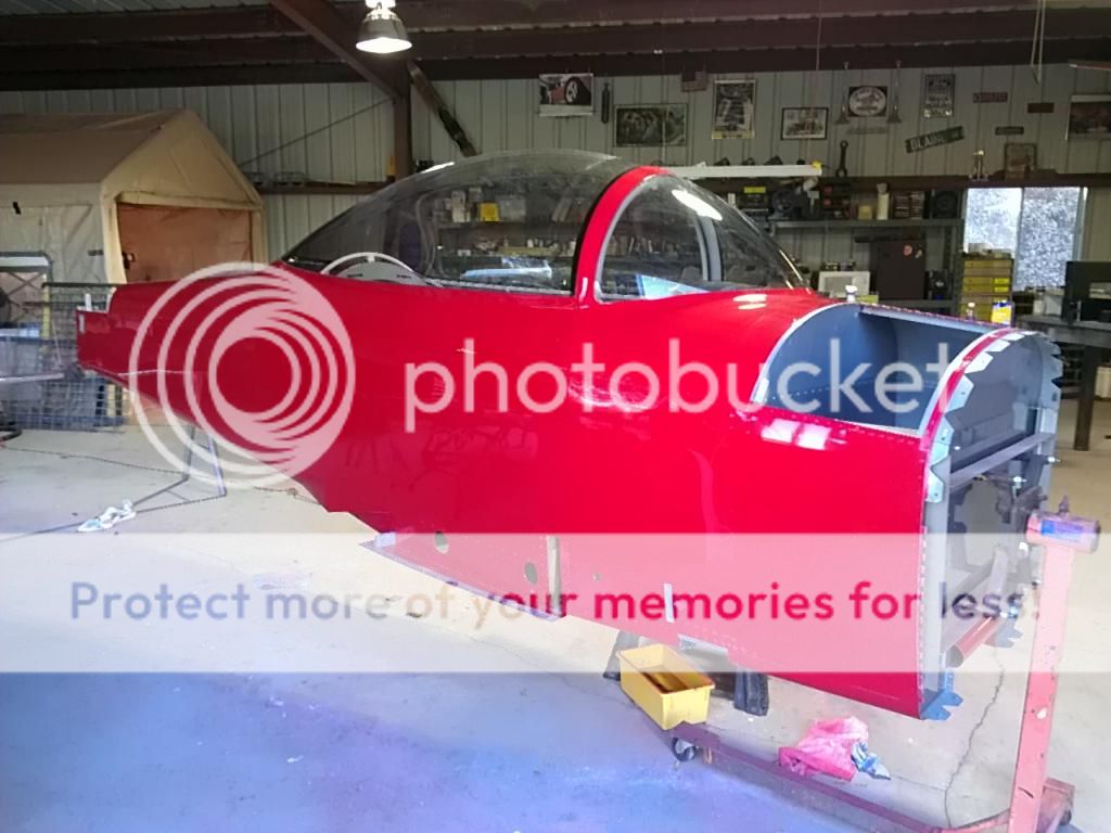

Inspiration

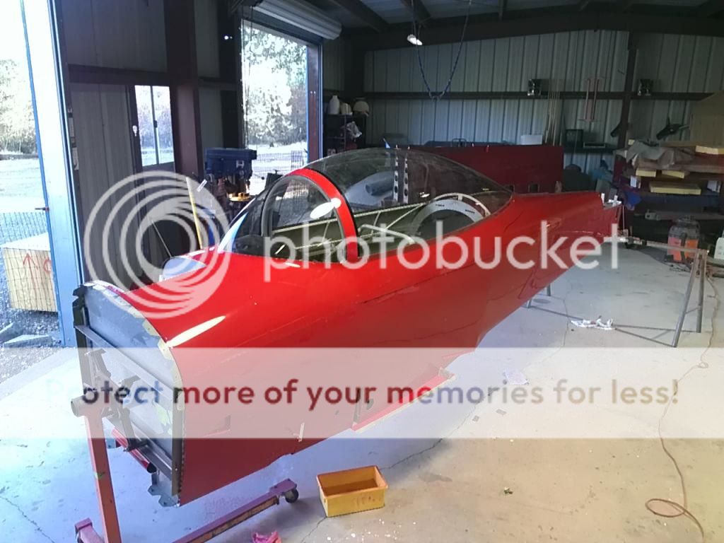

Completing some tasks are just a relief. Paint buffed and canopy mounted is inspiring.
Status
Looks good. Mines red with some grey ,white and silver. After a few designs I painted the "hoop" around the canopy black instead of the red body color . I think it makes the canopy look like one piece and longer .

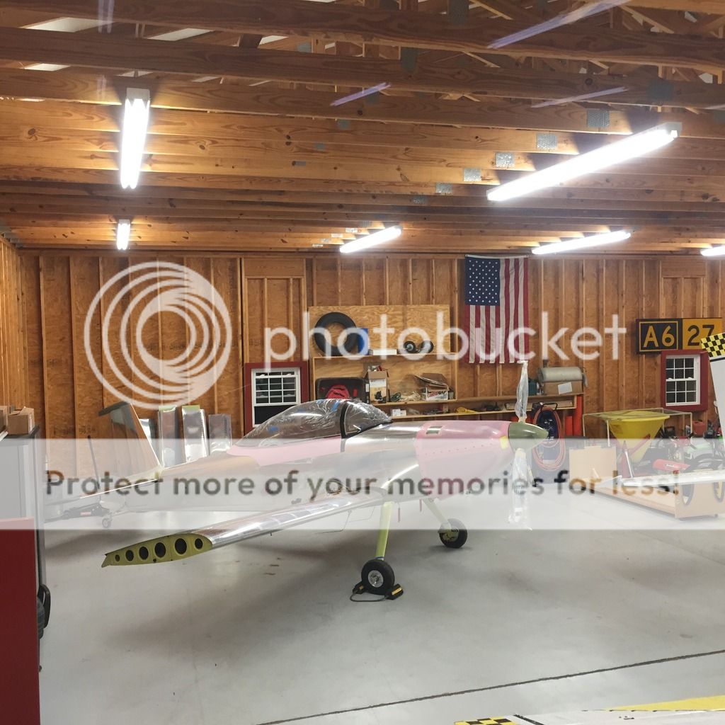

another milestone
Got the 8 to airport, and began assembly, wings on fairings done but not installed yet, gotta paint em. FWF next, hopefully before too long.

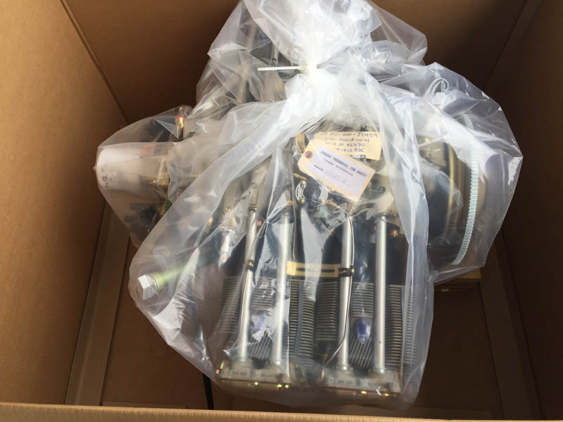

It's a Superior TNIO-360! Precision airmotive silver hawk fuel injection, B&C alternator, slick mags, and so on.
It came off of a Lancair Legacy where the owner was not happy with the performance and decided to put an IO-540 on the front of the legacy instead of the TNIO-360. Everything firewall forward is in the box.
I will probably not use the turbo normalizer and end up selling it along with the exhaust and pick up an Vetterman's exhaust for the superior cold air sump. I don't need the extra boost and won't be flying above 12,000 where it's most happy. If anyone is interested in it, please let me know.
There's a total of 262 hours on the engine, and less than 50 hours on all four cylinders that were replaced.
The prop is a Hartzell C/S HC-F2YR-1F, which didn't arrive with the engine and is somewhere in Toronto.

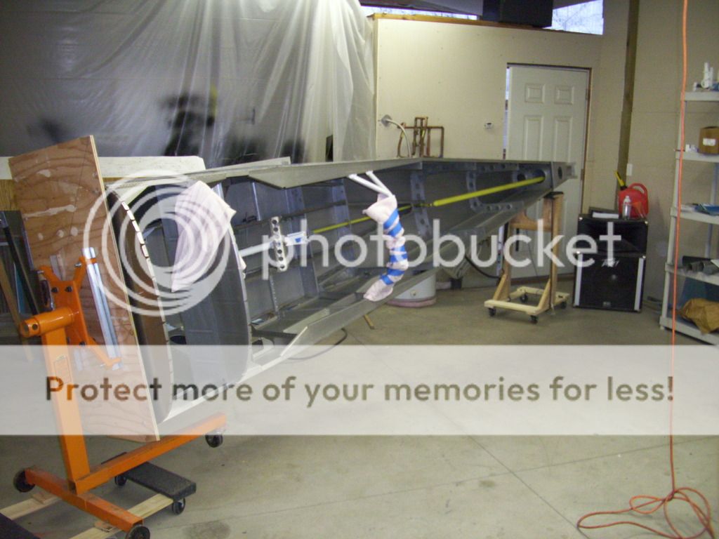

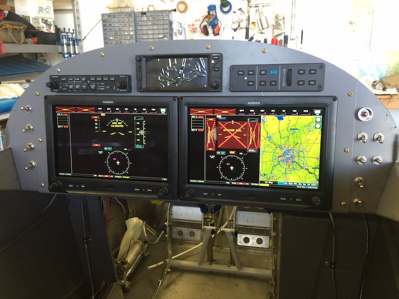

Well, the wings are as done as they're going to be for the foreseeable future. For the time being, I'm not going to bother riveting the bottom skins. Keep these things open until I've got all my plumbing and such finalized.
Sure would be a great time to cut an access plate for the back of the instrument panel..
Looking good.
Yeah I've gone back and forth. Probably putting a single big display in the center so dawdling about the access. Don't want to pass up a chance to kick myself later.

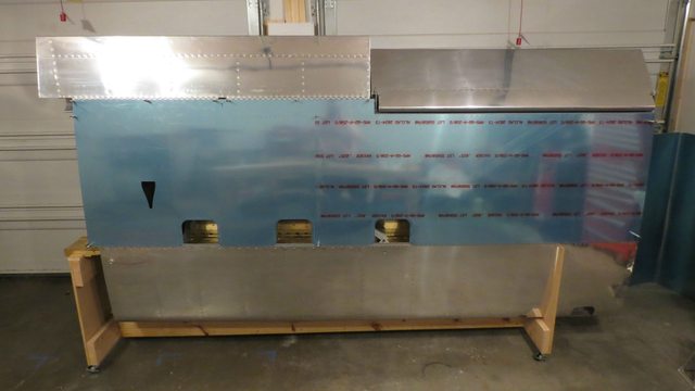

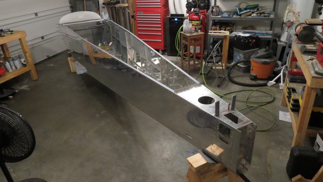

The fuselage canoe briefly saw the light of day yesterday. In accordance with the instructions, we were moving it from the tall sawhorses it was on to some low units I built so I can work on inside stuff.
Philip,
While I didn't build a rotisserie for my project, I really wish I had. Makes interior work a whole lot easier. I had so many days with a sore chest from leaning on the longerons wile working on stuff in there. Rolling the fuse sideways makes things a whole lot easier.
Philip,
Yeah, once the fuse goes together for the second time, I intend to build a rotisserie for the extended interior work. For the moment, about all I'm doing in there is match-drilling through the lower center section flanges and fitting the center cabin brace (or whatever the weldment that goes between the seats is called), and in a week or two the whole thing will come apart for deburring/dimpling/countersinking/etc.
And of course, sometime in the near future I'm going to have to throw a couch cushion in this thing so I can climb in and make airplane noises.

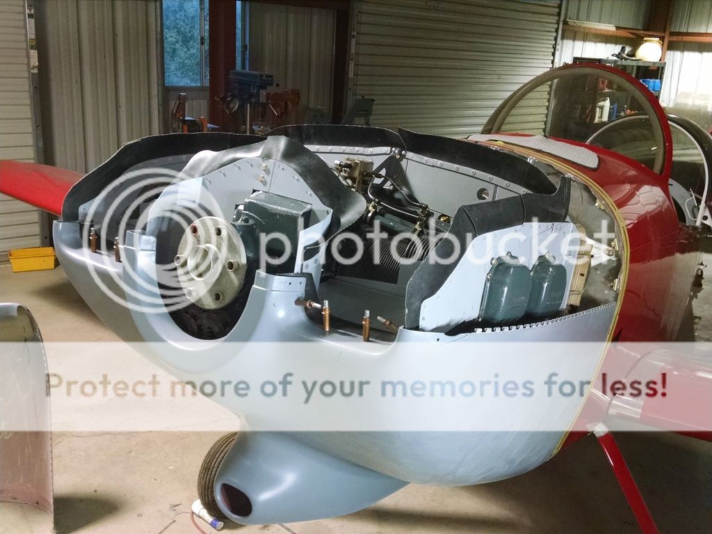

Big day today....brought the fuselage to the airport on Saturday and got the engine hung today. Sequence was top right, top left, bottom right and bottom left.
Some frustrating moments, but with a little help and persuasion, she's bolted on.
Now I have to figure out how to rotate the back of the prop governor about 180 degrees.

Cool! Already in training for inverted flight! ;-)
Prop Governor
I know it's scary to even consider taking apart a brand new $1500 dollar prop governor, but it really is simple. The rear plate can screw down in any orientation without changing its function. Cut the safety wire securing the screws, remove the screws while holding the rear plate in place. Then rotate the plate until the desired orientation is achieved and re-install the screws. Re-safety and you're done.
Just a thought. Before fitting the cowling to the engine in its current position, would it be smart to install a washer on the two top engine mounts to simulate engine mount sag. Later when the mounts do sag, one could then remove the washers.

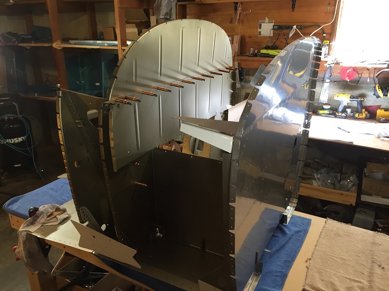

fuselage canoe
Entered the canoe stage with the help of my son, who is becoming a good riveter.

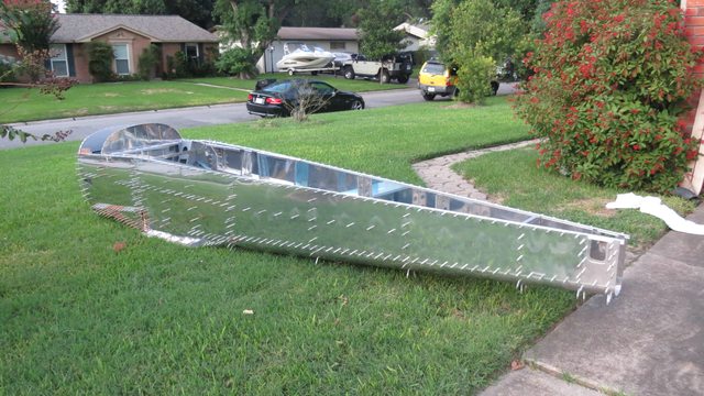

Finally finished shooting rivets on the bottom of the canoe and rolled it back upright again. I'm glad to not be spending any more time sitting under that thing sweating profusely all over my headlamp.

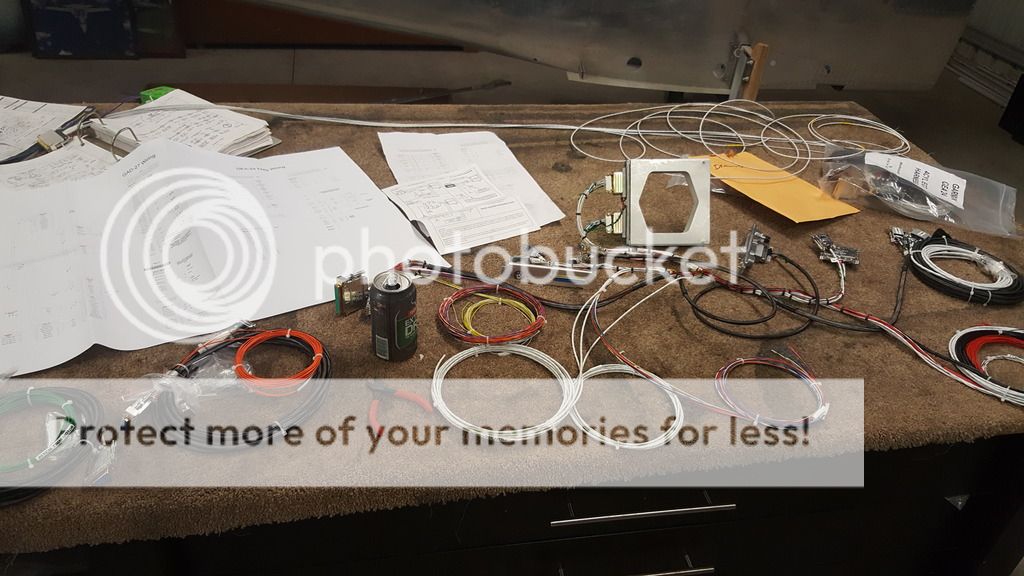

A massive thanks to the guys at SteinAir for the quality work they have
done putting together my custom harness and supplying my Avionics!! I can't recommend them enough!!!
