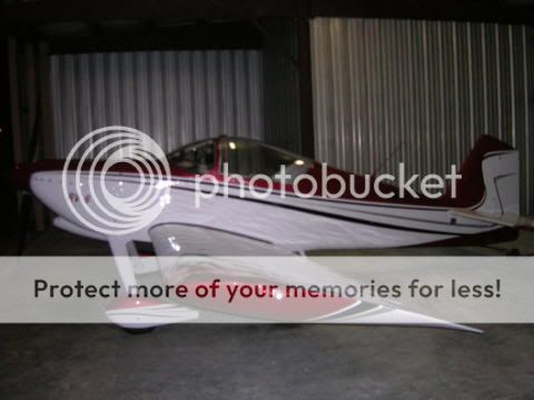

Mounted the left and right wings to the fuselage this weekend.
Now have to get the fuselage and wings jigged so can drill the hole in the rear spar attach bracket.
Painted plane - still in parts
I had my plane painted by a local friend with a body shop.
I fly RC planes for fun too so I wanted a look that was part RC, part antique.<
Hope to be putting the wings on shortly.

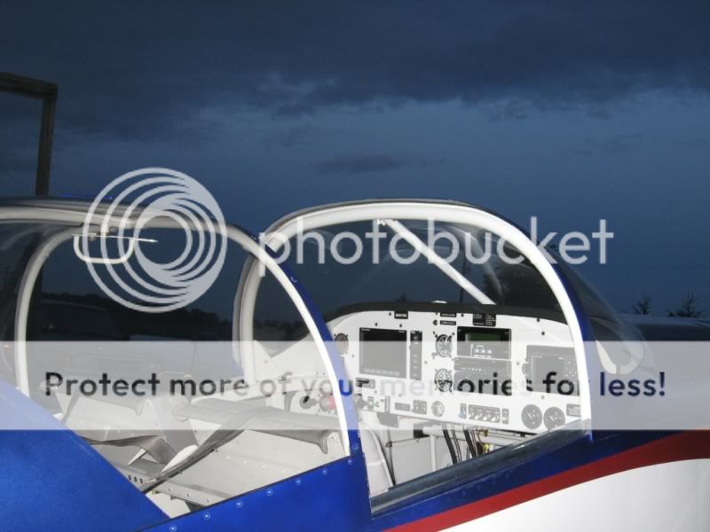

Here is my RV ! Many Mods !
I recently installed the Vetterman exhaust im really am liking it so far.
Sorry about the size of the pics can someone tell me how to scale them down?
The Catto 3 blade will be installed shortly and many more things just waiting to be bolted on.

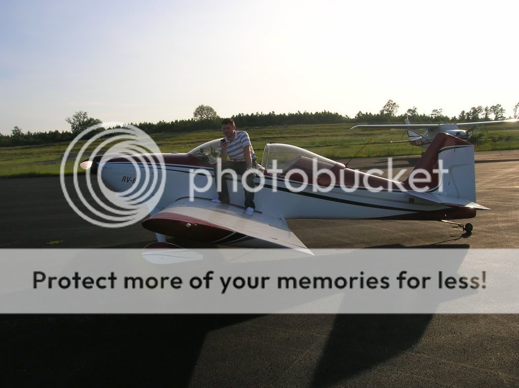

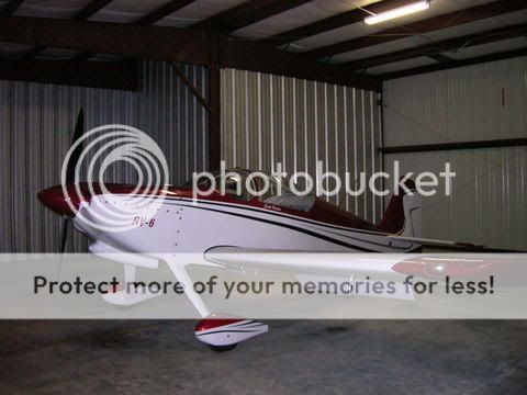

I am the proud owner as of Jan. 2008 of Robbie Attaways RV-6
Flew it home from Phoenix AZ after the purchase in approx 9 hrs of flight time
to my home base of Louisa, VA. (LKU)
As you must know I am enjoying the airplane beyond my expections. There are three other RV-6's at LKU
so you can imagine how much fun we are having on weekends.
Drop in we are ususally there every weekend.

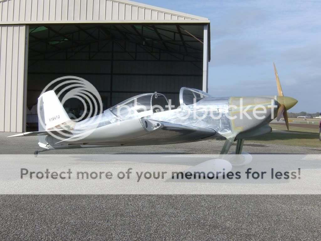

With 220 TT, my -6A "Darla!" has been flying for over 3 years now. I decided to maintain a (mostly) Nuvite polished
aluminum finish not so much to save weight but mainly because my wife balks at endorsing a multi-thousand
dollar paint job. What is painted was done over a couple of years by bringing parts home from time to time to apply
Acry-Glo. That kept down time to a minimum and is one reason I made the empennage tips removable with
screws and nutplates.

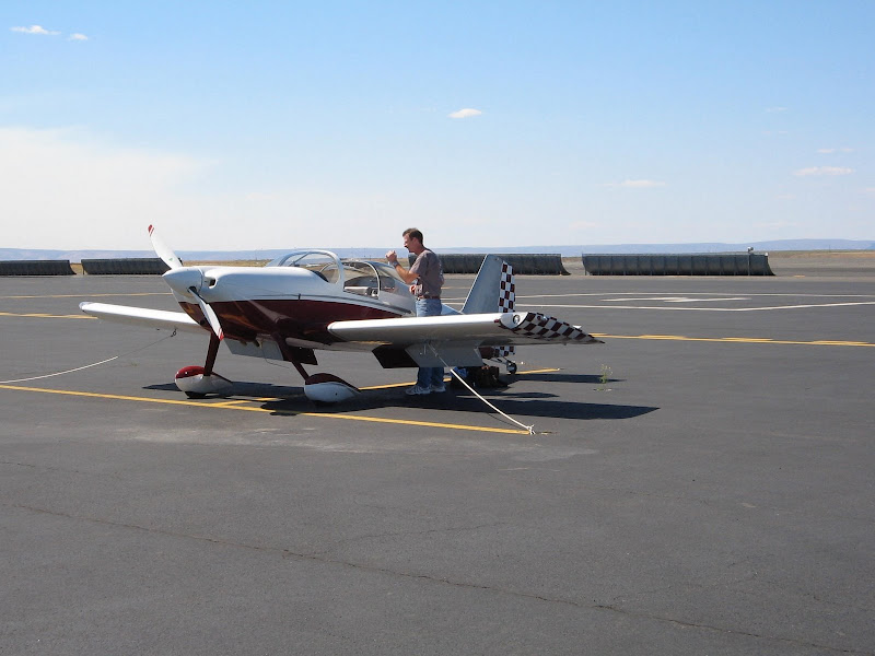

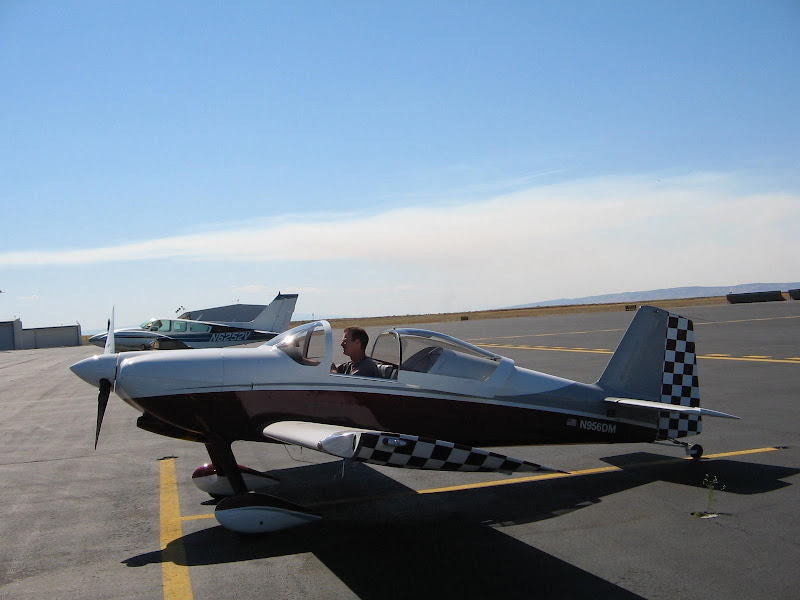

Some pictures of my RV6 (hopefully it will work) after I flew it from Philly to Moses Lake Wa. I was trying to get to Seattle but had to settle for Moses Lake for a couple of weeks waiting for Puget Sound weather to cooperate.
Doug Meloche
RV6 230hrs
Looks like Columbia Pacific Aviation. I got my pilots licence on that ramp, a&p just to the west at Big Bend. Beautiful 6, and welcome to kmwh!

It is also one of the fastest RV-6s around. Go to www.sportairrace.org, scroll down to the bottom and click on "2007 Race Season Race Results" then click on Taylor 100 Race Results. You will see that your airplane completed the four sided 100 mile course at 214.58 mph.

Nice lookin' plane. Who took those pictures? Must've been a professional. Ha!Ha! See you when you get back to Philly.

I knew about that race, I think Robbie set a new speed record with it.
I see on the results that you were not too far behind him.
The other 3 RV's at LKU know it's fast also.

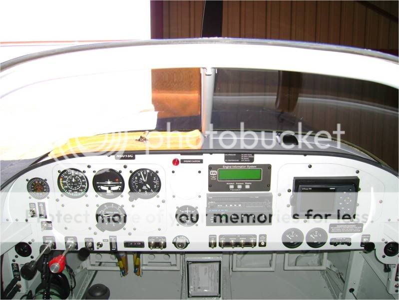

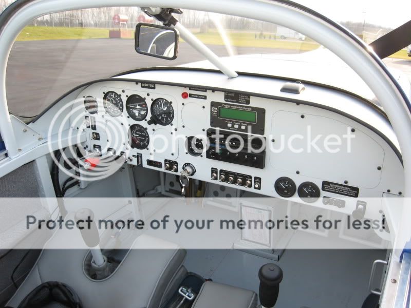

N96FS ready to fly in IN
I finally finished my RV-6 after 14-1/2 years of building. On November 20, 2008 DAR Tony Cecere inspected and signed it off I will make my first flight after transition training with Alex this week.
I kept it simple and light. Empty weight is 1009 lbs. It has a rebuilt 0-360-A1A Lycoming with Sterba 70/82 wood prop, new carb, plane power alternator, new slick mags and was upgraded to the RV-7 FWF kit.
The panel is simple VFR/Day/Night. I have an older Advance Grand Rapids EIS, Icom I200A, Garmin 320A transponder and PS3000 intercom. The seats are Flight Line, no carpet (yet), no side panels, CH stick grips and electric flaps
Congratulations Frank
I think you achieved exactly what Van had in mind when he designed the six.
It's refreshing to see a panel which isn't worth more than the whole kit.;) How did you resist all that "panel candy" out there? :eek:
I notice you have what appears to be defrosters on the top of the panel. That's a great idea. Thanks for the inspiration. Nice clean looking plane. Have fun and fly safe.:)

It was easy to resist the "panel candy". 1. I looked at the simple panels in Van's planes and they flew them across the country to Sun'n Fun and OSH every year. 2. Most of the new electronics were not availabel when I started designing my panel many years ago. 3. I am a low time pilot who would probable not get the full use out of a more elaberate panel. 4. After 14.5 years I decided to keep it simple and the cost down so I could finally finish and get to flying. 5. I figured as I fly I will determine what else I would like to have and can add it later.
Yes I do have two large computer cooling fans for defrost. I did not put in any ducting, I figured heated air would rise under the panel to the fans. In a short taxi test with two of us fogging up the canopy it work well. Don't know what it will do in flight.
Congrats, Frank! Light and simple -- Van will probably kiss you. :D
Good luck with your training and first flights. Keep us all updated on your progress. I'm not too far behind you ... heheh ...
It doesn't hurt to have some kind of attitude indication for inadvertant IMC, even if it's a panel page that's available with some of today's handheld GPS units.
I'm saying this, because one of Van's simple panels did in fact, run into serious and un-planned IMC problems while on a cross-country back in 2000.
edit: And if that's a panel dock for a Garmin 296/396/496 .......then great! , as it's got the panel page! It's a bit hard to tell in the pic.
L.Adamson --- RV6A
Yes, that is a Garmin GPS docking station for the x96 series. I also plan to eventually place in the center instrument hole, where the slip ball is now, a TruTrak ADI autopilot.

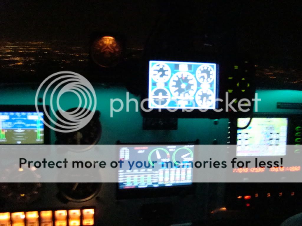

My New Panel on Sugar Charlie
I am presently deployed to the Middle East on a yearlong rotation. Prior to leaving the states last fall I ask the former owner / builder of my RV6, N601SC (AKA ?Sugar Charlie) if he would perform a little RV panel magic. Boy did he come through. Steve Campbell is now my new best friend. I cannot say thanks enough to the quality work he has done.
Below are the before and after pics. The before pic was taken in APR 2007 when I bought Sugar Charlie. The present is what I will return to in the fall of this year.
Though I have not personally made it home yet to enjoy the outcome of his magic ? I am sure the tricks will be countless. The major components for this particular upgrade included a Dynon 100, Dynon 2 axis auto-pilot, Dynon AP 74, Dynon AOA/Pitot, Grand Rapids EIS fuel analyzer, Carb temp probe, 2.25? backup Airspeed and Altimeter gages, Classic Aero leather glare shield trim and linking my Garmin 396 to the SL-40 and Dynon package.
Sugar Charlie was an incredible traveling machine prior to the panel upgrade ? I can only imagine my future VFR travels will be even more enjoyable.
Having made the cross country between 32GA (40 miles south of Athens, GA) and Old El Paso, TX on several occasions in my first RV (RV-3) and now the 6 in fewer than 8 hrs of hand flying ? I am sure the Dynon auto pilot and new situational awareness concerning attitude for those hazy summer days will be a welcomed addition.
Many thanks to the following in the retail industry ? Stein at Stein Air for providing all the great products, Mike at Dynon General Support and Tim at Grand Rapids. You folks are off the charts concerning costumer support. Throughout their emails to Steve all they wanted to do is make things right and get the 6 safely in the air. Finally, to all the helping hands at I17.
Over Old El Paso - Spring 2008
Apr 2007
May 2007
Jan 2009
Jul 2009
Jul 2009
My Grin
See you all on the top deck?
Cheers.
Jerry
