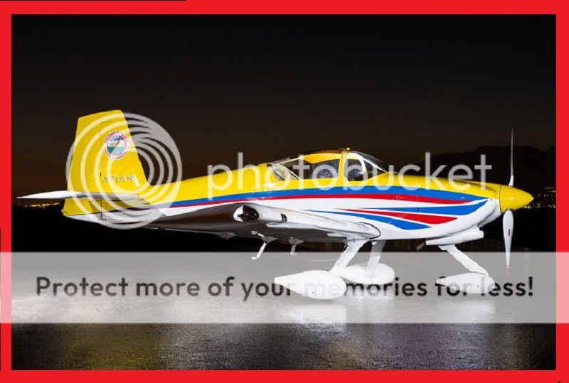

Vlad,
Yellow paint is Imron 5000, color is N0680. Single-stage paint. And in real life it is VERY yellow and very visible compared to most white or even reds.
Ron,
Canopy is not tinted at all - its just the standard canopy. I guess the photo just makes it look tinted.
Paint was done by Cardan in Red Bluff, CA.

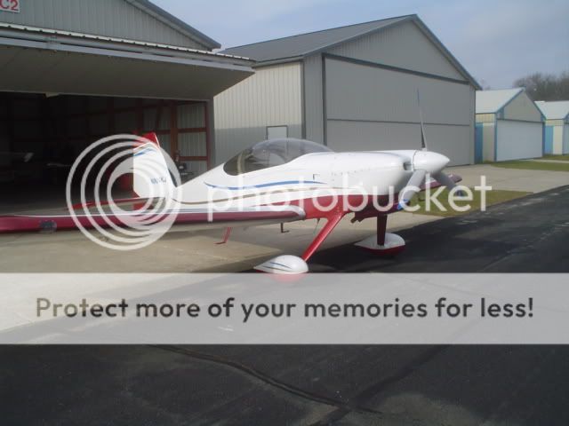

Alrighty fellow -9er's. Here's a couple photos of my baby. Phase 1 complete! Hoping to take her on a short cross-country soon.:D
WOW
Jerry, Dude,
now that is one awesome looking RV-9. Love it!
I too am building a 9 not a 9A. Some of the few 9's out there.
again WOW good looking plane.
How's the performance? I have the same engine and a 2-bladed Catto. Hoping to fly in a couple of weeks.
Thanks everyone
Thanks for the compliments everyone. It sure feels great to see 5 1/2 years of hard work finally flying through the air. For those wanting some performance numbers. At 5500 feet, 2400 rpm, the Dynon indicated a TAS between 143-148 kts, fuel burn at 7.2-7.5 gph @ 50 deg rich of peak. Got my eye set on a few fly-in pancake breakfast's in northern Indiana these next few weeks. Let the fun commence!!!! :)

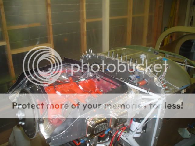

N539RV engine setup
I bought a used O-320 D3G which I ended up having zero'd out by Premier Aircraft Engines at KTTD, and had them convert it to Airmotive SilverHawk fuel injection and plumb in for Hartzell CS prop. I retained the left mag and installed Lightspeed Plasma II EI.

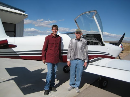

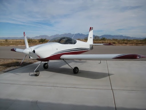

No swiss watch...
but it's a pretty nice tractor! Kit 91841 has completed her first flight in the capable hands of good friend, CFII, engine builder, RV-9A builder - Don Jones. It flew well, with only minor adjustments needed.
Couldn't have built it without all the help from Don, my wife, and all the people on this forum. It seemed like every time I had a question, a search of the forums turned up a couple dozen "been-there-done-thats". I also got lots of help and suggestions from several of you at the LOE fly-ins.
This 9A is equipped with a Titan 320, AFP fuel injection, G3i ignition, SC-15 canopy, and Catto 3-blade prop. It has a full Classic Aero interior, back yard paint and weighed in at 1137 lbs.
Don and Russ - RV grins!
Looking forward to spending lots of time on the seat of this tractor! :D:D

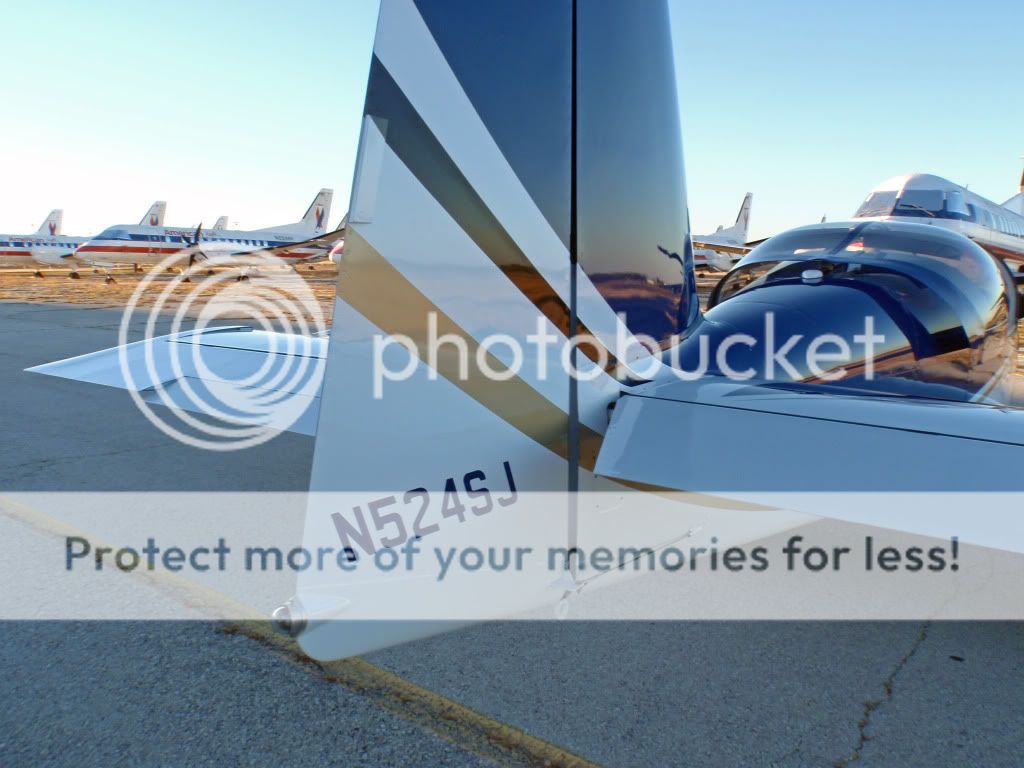

Painted and waiting for snow to melt!
My C-17 USAF Reserve squadron patch, which I've been in for 12 years or so. When I was furloughed from the airline, my reserve squadron kept me gainfully employed and able to work on my plane. 3.5 years later, plane is done, I'm still in the reserves, and I'm back with the airline. (Don't think I'd ever put my airline logo on MY plane)
tail picture added above
Hey Mike,
See above, I added a picture of the tail, which is my USAF Reserves squadron patch. The 300th Airlift squadron in Charleston, SC. Been with them for a long time, and without those guys, my plane probably would have never been started.

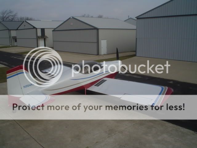

Completed N904KJ
Well, my RV-9 is finally flying, after nearly 5 years and who knows how many hours. FAA sign off was done on July 13th 2010 and I did the first flight on July 20th. This was also the first flight for the newely rebuilt Lycoming 0-320, 150 hp engine. All went well, as I circled the airport over the broken ceiling at about 5500 MSL. The only discomfort I experienced after the flight was my aching “facial” cheeks as a result of the RV grin.
Equipment includes AFS 3500s/3400s EFIS/Engine monitor, AvMap EKPIV GPS, TruTrak Digiflight II 2 axis autopilot and ICOM A210 com radio. Engine is a 1967 Lyc. 0-320 E2C rebuilt stock 150HP with ECI TITAN EXP Cylinders, dual P-Mags, B&C 60A Alternator and Magnaflight light wt. starter. Prop is Catto 3 blade. Interior by Abby & Brad @ Flightline Interiors. They are awsome to work with and do excellent work.
True airspeed is 181mph @ 8500ft. Best fuel economy so far was 3.8 gph @ 2000rpm and 120mph. I love that part ;)
The paint was done in November by Euroaire Aviation in Reedsburg Wisconsin.
To date I have 101 hours and the grin is still just as big ;)
My wife Jane and I have taken several trips and many more are planned
Here are a few pictures.
Ken Klima
Tony, your right Ken's plane is beautiful...Yep, you guys have to come visit me at Schaumburg, 06C.. Mark C.
Here's another great photo of Ken's plane.
Ken, I remember some of my early flying (training) being done in WI on the hard-packed snow. My private checkride was out of Kenosha in winter, but I remember much colder further north. That's a great picture. Can't wait to follow your footsteps in my -7.
Beautiful airplane Ken!
I'm planing to put the same engine in my 9 so I liked seeing your performance numbers.
