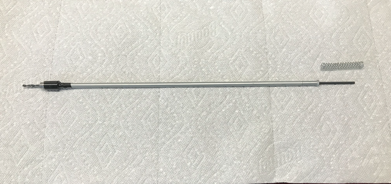

I am finished with the nose gear installation and have the 18" bits and guide bushings for sale listed in the classifieds.
Included are the 3 bits, 2 guide bushings and the length of PEX tubing that makes the process much easier.
The bushings and PEX are the same diameter and I found that taping the two end to end with gorilla tape was of much benefit. After taping you can easily insert the guide bushing into the existing 3/8" hole of the mount inside the tunnel then drill through the PEX and bushing.

A tip for SB 19-08-026 compliers: I found that an approximately 16" length of 5/16" dia. wooden dowel was very useful in driving out the two lower AN 6 bolts. Any straight metal 5/16" dia rod or tube would do as well.
Here is another tip for SB 19-08-026 compliers: I took note of some earlier commentors' useful suggestions to use a tube or spring to keep the drill bushing in position while drilling the two lower strut/motor mount holes. I took an @ 14 5/8" long piece of @ 5/16" ID tube (plastic, rubber, or metal) and taped one end of the tube to the appropriate drill bushing. Insert the appropriate drill bit through the tube and bushing, then place a small thrust washer, an @ 1 1/4" long moderate-force compression spring, and then another small thrust washer (add a bit of grease on the washers) at the end of the tube. Tighten this "assemblage" in the drill chuck so that the tip of the drill bit falls just shy of end of the bushing (think "frightened turtle"). It is then a very easy job to sit in the cockpit, index the bushing into the existing 3/8' firewall hole, line up the drill, hold the tube to keep it from spinning, and push the drill motor to drill the holes -- the "assemblage" places pressure on the bushing and helps to keep it properly aligned while the drill bit does it's work (don't forget to use some drill bit lubricant such as Boelube, etc.). Easy-peasy!

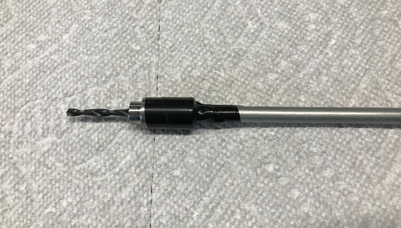

To hold the guide I used a wrap of blue painters tape around the guide and partly up the drill bit. Start with the brill bit point just peeking out of the guide.
The 1/8 - 18" drill bit I got from Vans wasn't too sharp, I made it through the left hole but was only able to mark the right side with it. I removed the strut and finished drilling on the bench all the way to 3/8".

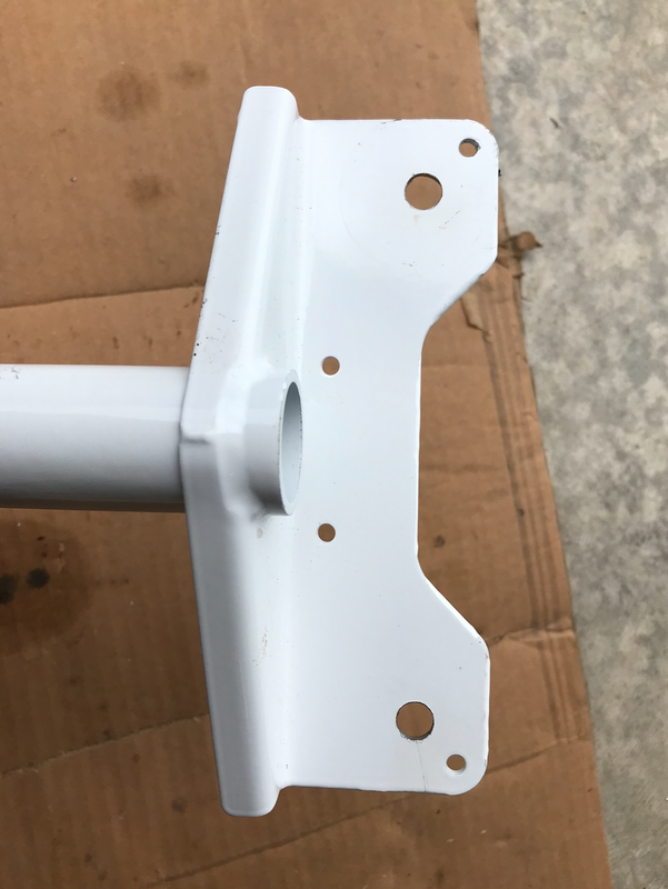

I?m getting ready to install my new nose gear and wondering why the lower engine mount holes need to configured at assembly. The flange for the lower engine mount has four holes that I assume are clearance for existing rivets. If clearance holes for rivets can be pre-drilled by Van?s it seems the lower engine mount holes could be also. Maybe lower engine mount holes aren?t a ?known? location?
I must be missing something?.
The production process of the RV-12 nose gear assembly includes heat treating after the welding is completed.
When heat treating is done on welded 4130 steel assemblies they can (and do) change shape slightly from what the were when welding in the welding fixture.
To try and minimize this, they are bolted to a very heavy fixture while they go through heat treat to try and stabilize any movement but it doesn't resolve it 100%.
Because of this movement, no two gear legs are exactly the same, which is a problem when you are wanting a very close tolerance fit of fasteners, and have to remove one to install a different one.
This is not a problem on a new build because you just match drill the holes based on the nose gear leg once you bolt it in place and all is good.
It does induce a problem if you need to retrofit a different nose gear to a fuselage that has mounting holes already drilled in the firewall.
That is why there is two different version of the nose gear available, and why it was advantageous for anyone that was in the process of working on the finish kit, to wait for the new nose gear leg. This gave them the option of just bolting it in place and match drilling from the front.

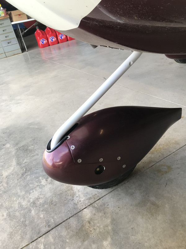

That might explain why my nose strut is slightly off-centerline with the fuselage. Perhaps it warped during heat treating...
As part of my preflight inspection the last thing I do before climbing aboard is to walk about 40? behind the airplane and eyeball the center axis of the fuselage. I line up the vertical fin and tail tiedown hook with the front nose strut. I look for symmetry of the entire airplane as well as straightness of antennas hanging off the bottom. That?s how I notice my nose strut is not centered.
Somebody asked me why I do this and I suspect it?s a carryover from flying model airplanes. Usually before launching a model airplane you hold it at arm?s length and look for warped wing or asymmetrical flight surfaces.

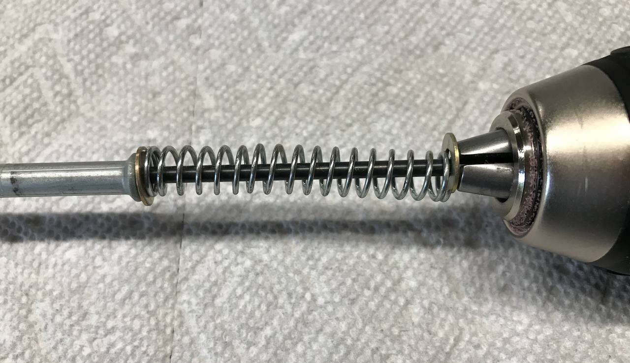

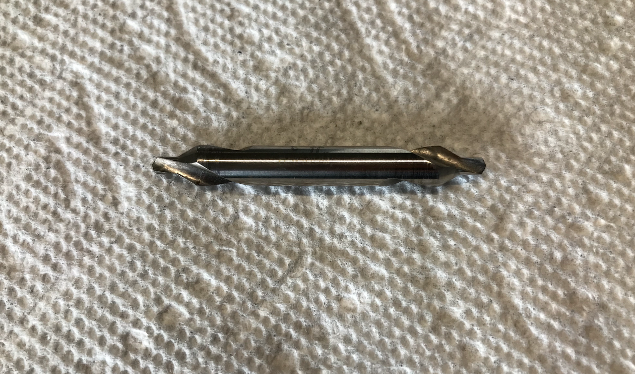

I?m installing new front gear leg without any assistance due to COVID social distancing. So far, I have about 10 hours into the job. I?m following the SB and using the DHeal post #170 tip for spring pressure to position drill bushing. Works a charm?
I found it extremely difficult to drill the first holes. 1/8?x18? long high speed drill hardly touched the heat-treated plate on the gear leg. So, what I did was use 1/8? drill with bushing to spot the location on the plate. I then removed the gear and drilled the holes on a bench. I ended up using a center drill to pick up the spotted location and start the first hole through the plate. Holes were bumped up to 3/8? and deburred before reinstallation.
DHeal Spring Method to Position Drill Bushing
Drill Bushing Taped to Outer Sleeve
Compression Spring w/ Thrust Washers
Center Drill for Starting Hole in Solid Material
Ready to Install
