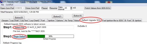

ECU Re-flash
I've had a few people ask about how the user re-flash works on the EM-6.
This is done through the ECU data port which normally connects to the card logger now.
You download SDSDASH to your laptop from a link we provide. This is the logging, communication and de-encryption software allowing the EM-6 to talk to your Windows device.
We'll send you a file by email for each ECU which contains an encrypted file matching each ECU's burn # (you can see that # info on your programmer on power up).
Open SDSDASH, Click on the Reflash Upgrade button.
Find the file on your laptop.
Click on Begin Reflash button.
Progress bar will show status of reflash process. Takes around 100 seconds to complete.
Done.
