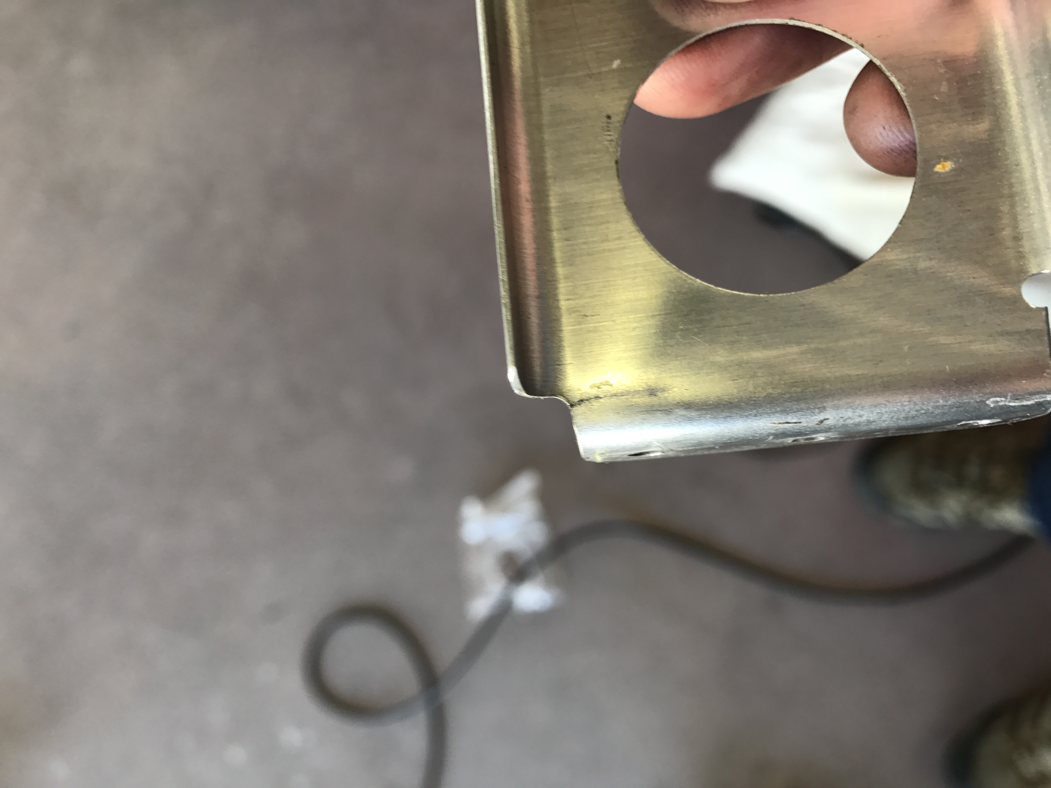

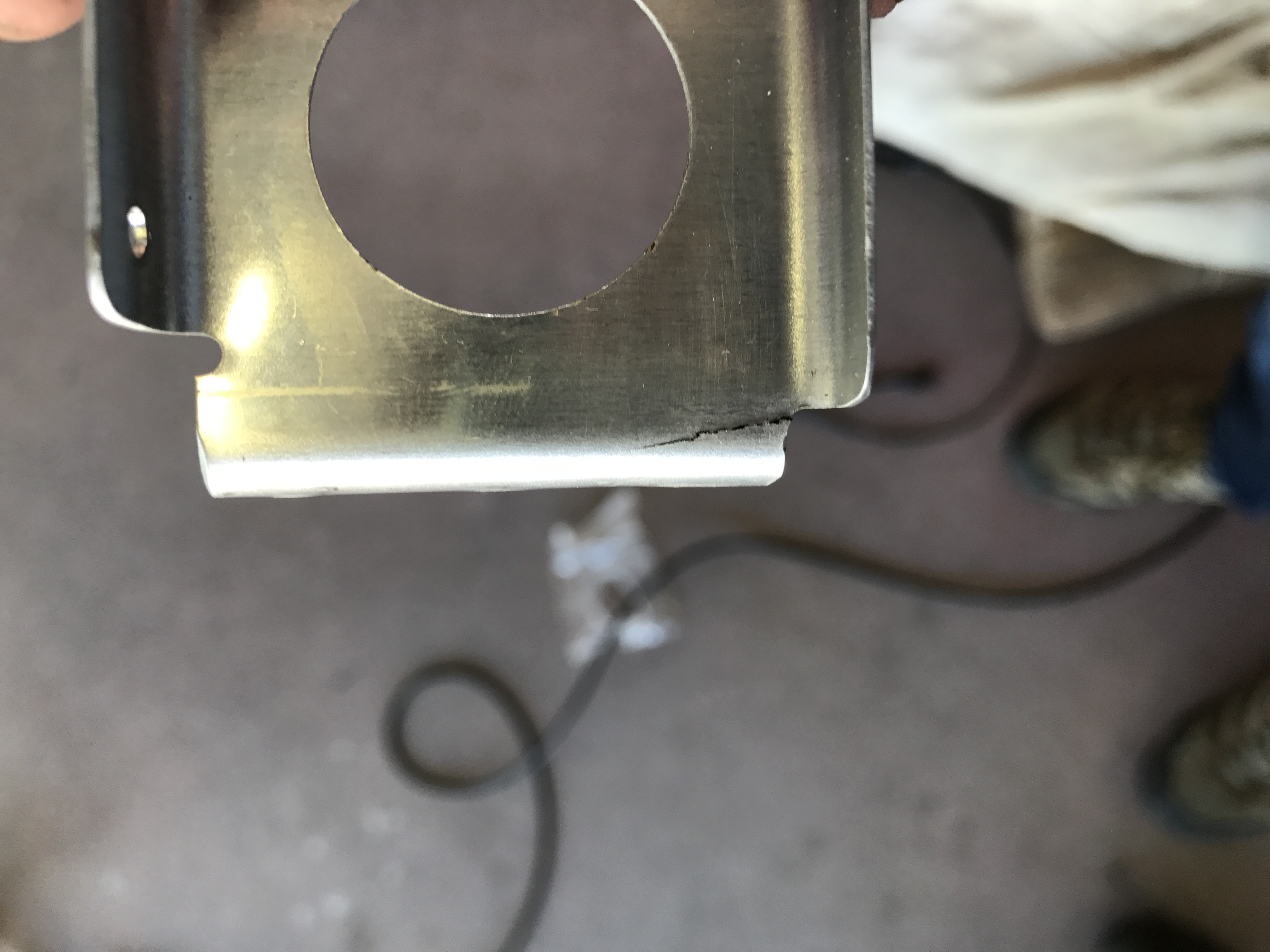

On my sixth conditional...over 600 hours...discovered a crack on the right aft rivet exactly the same as the one pictured in the service bulletin. Since it is in exactly the same location as the company airframe, it does provide more evidence to the theory that the crack is age related.
This possibility provides even more encouragement to the consideration of a pre-emptive fix. John Bender has a few more hours than I do and while he has no cracks, he sees the evidence as when, not if - enough so that he has already ordered the fix. Hopefully, more will see it as so. A brace that fails in flight could be tricky to handle...if possible at all.
Perhaps the saddest consequence of my find was that this was to be the first year in six that I was not expecting to remove the fuel tank....the poor thing deserves a break.
I wonder if any of the aircraft with cracks have had their flaps deployed above 81 KIAS. Could that be a contributor?
For the most part, cracks in airframe parts are the result of cycle loading (lots of flexing cycles) not overload.

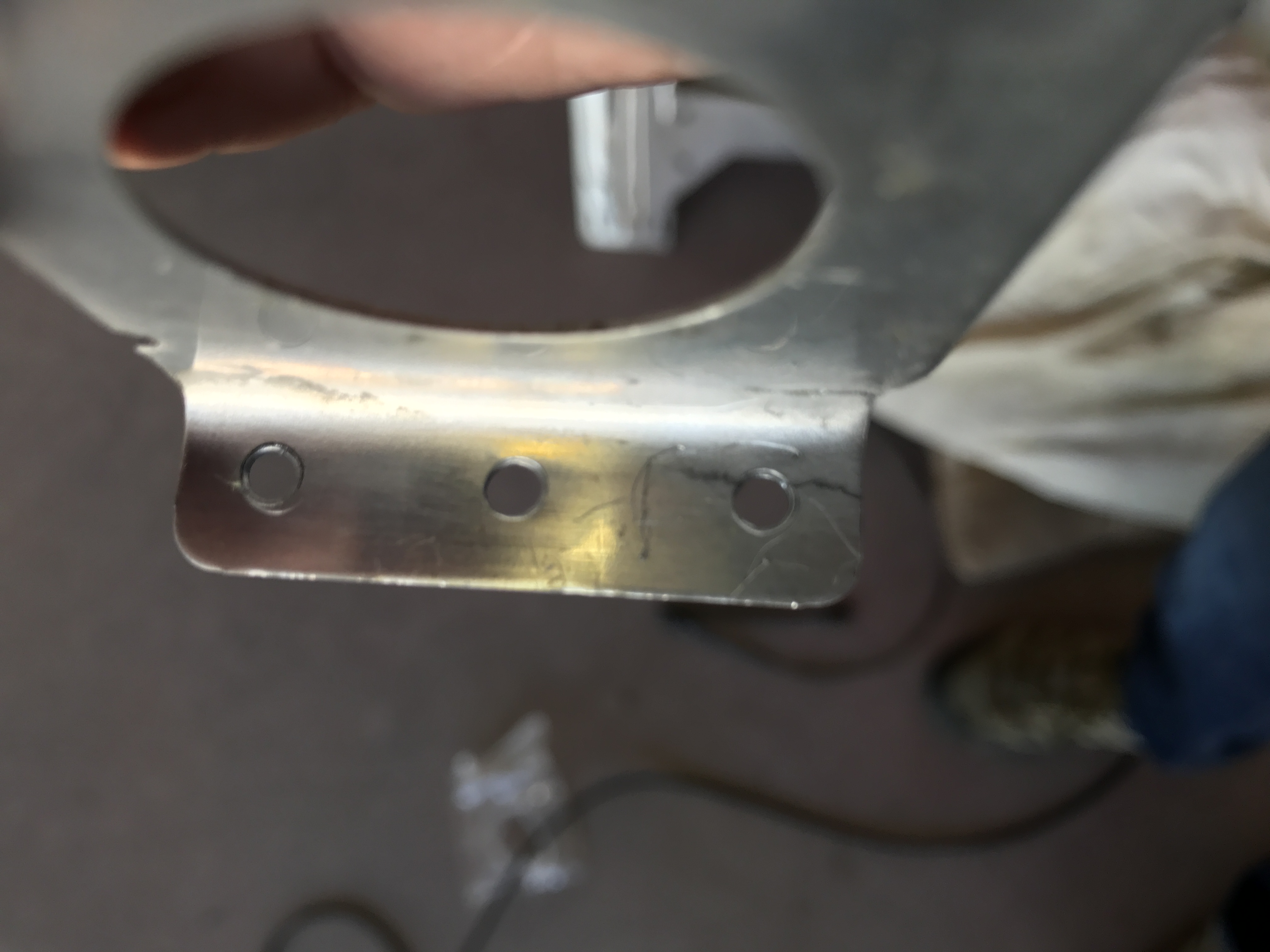

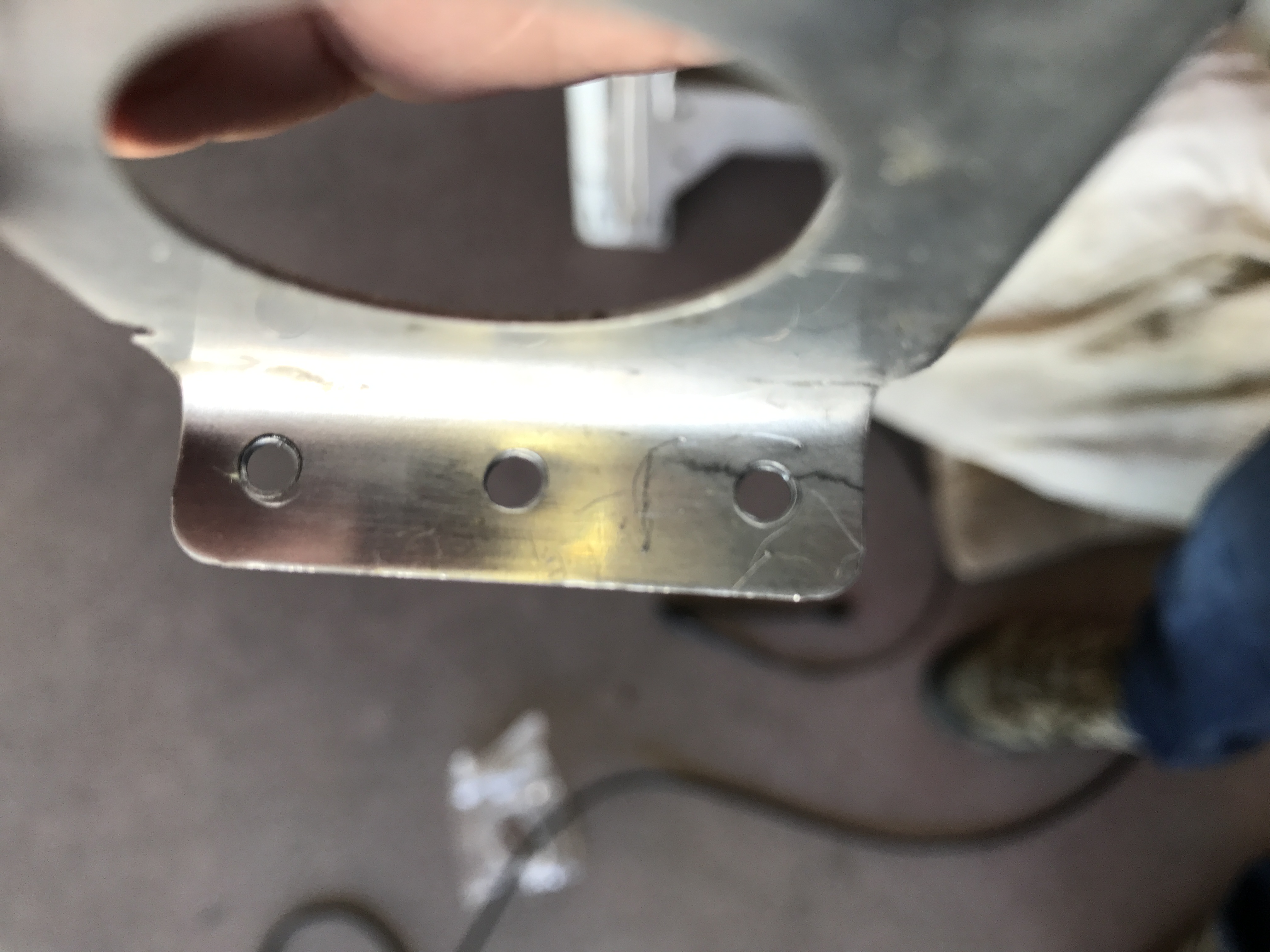

3 rd crack
My 3 rd crack was just like BigJohn's photos but a little bit longer and on the same side. My total airframe time was similar. Would encourage everyone to take this SB seriously. Anyone that has 250 hrs or so on their airframe could have the problem. When I first reported my cracks I was the low guy on the airframe hours. Now we have a second airframe with similar hours and I would speculate that there are several others out there with the same problem.

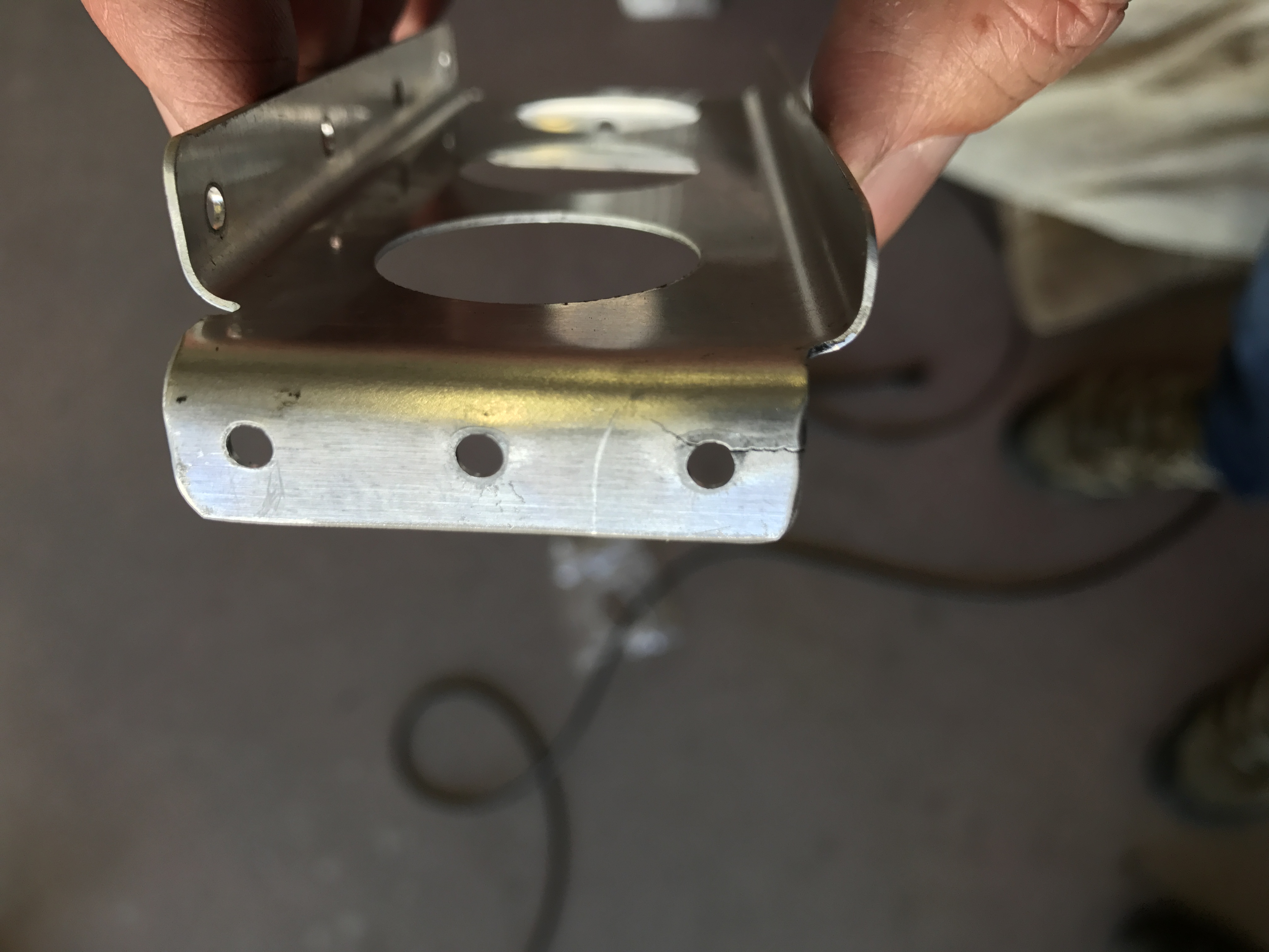

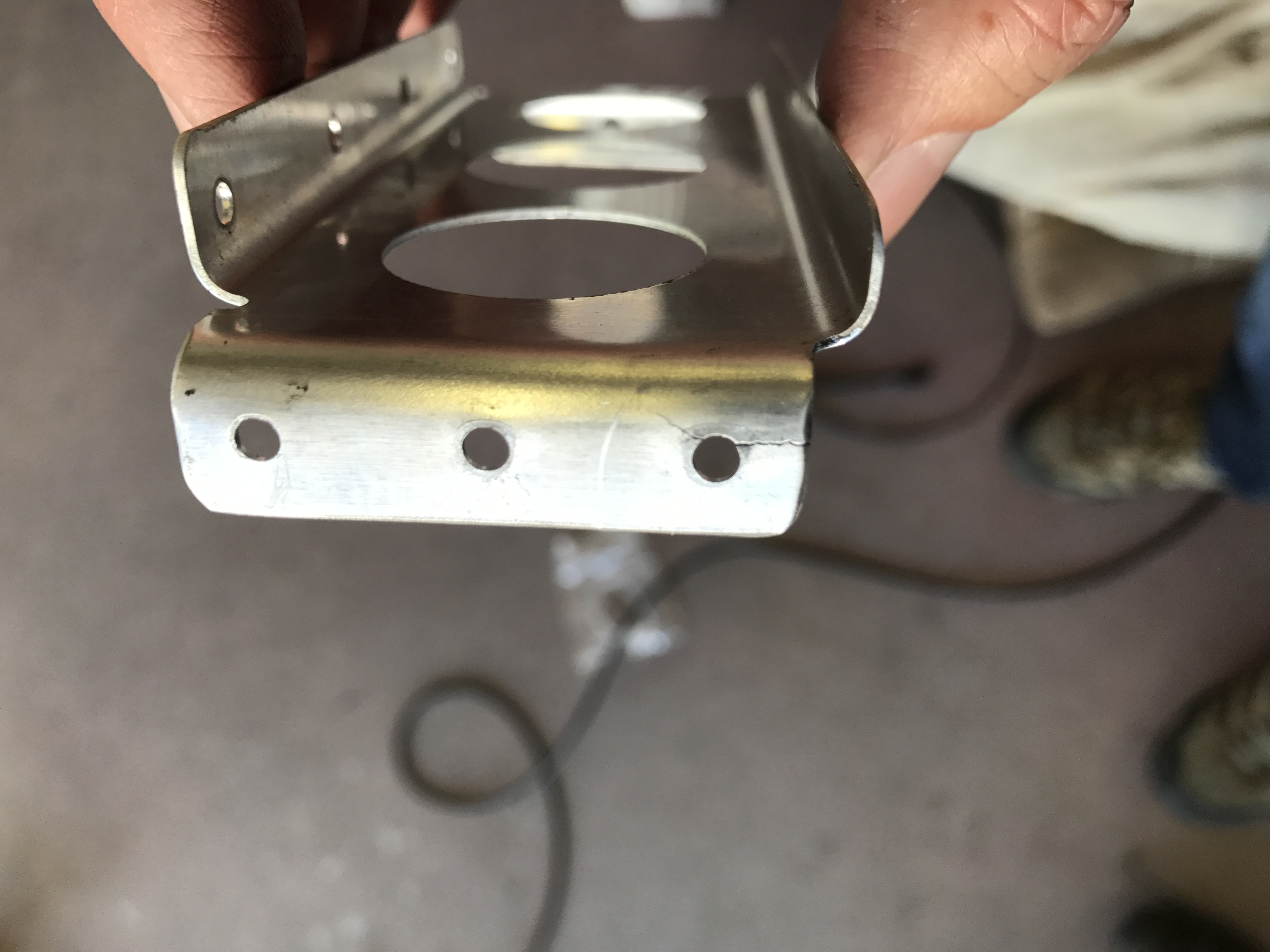

All that said, the new brace is also a new design of brace. It is actually two separate pieces joined by some heavy solid rivets. The edges, now thicker sections connect directly to the flaperon bearing bracket and then to the thinner flexible brace itself.

The inspection interval is not because of a high concern of failure. It is actually just the opposite.
Because there is strong evidence that in most cases, evidence of cracks will not show up until a considerable amount of flight time has accumulated, regular inspection allows an owner to wait and install the updated part at their convenience, or when cracks are discovered.
A crack that is induced by repetitive load cycles (like this one) can be influenced by many factors (how well the part was deburred, etc.), so there will never be a specific number that it will show up. I would be surprised if many cracks are found prior to about 500 hrs.

We just replaced the bracket in (2009) serial #2 RV-12 with 724 TT on it. Found four cracks after getting some built up lubricating grease/dirt out of the corners. It's VERY hard to see those cracks without carefully cleaning the bracket. And its hard to clean the bracket without being a python - or taking the tank out, which we did.
