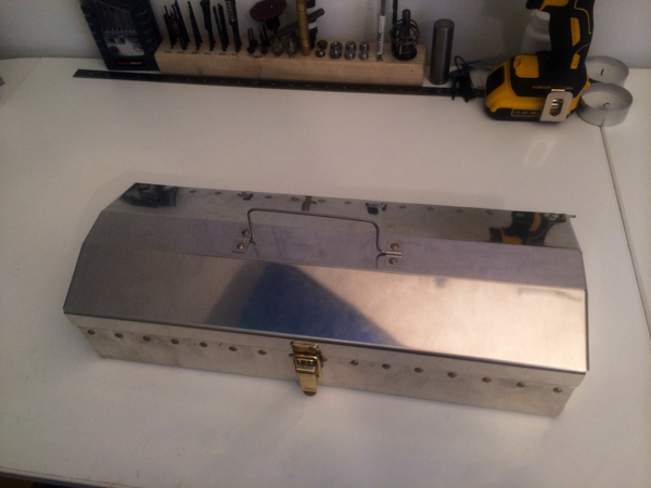

If you are concerned about whether you have the skills to build a RV, you might want to give the training kit and the practice toolbox a try:
http://www.vansaircraft.com/cgi-bin...2-60-549&browse=misc&product=training-project
http://www.vansaircraft.com/cgi-bin/store.cgi?ident=1443928262-60-549&browse=misc&product=toolbox

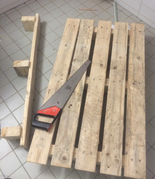

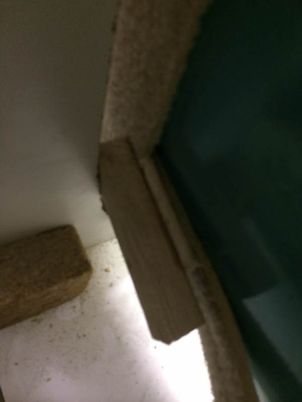

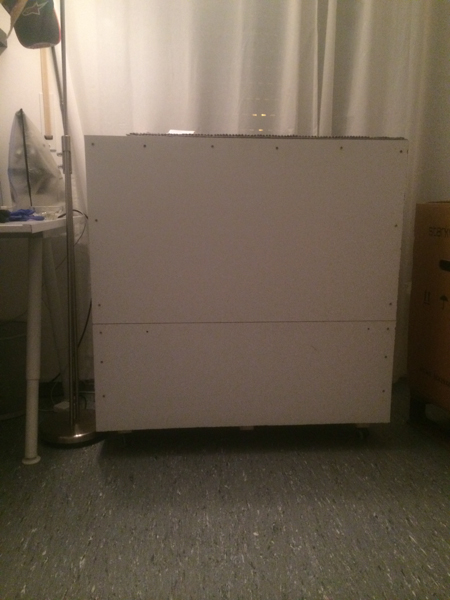

I also finished my compressor box. I Started with a pallet. I put wheels underneath it and build a wooden frame around it. Everything used to build this box so far was "trash" except for the wheels and screws. Can't wait to try it out :eek:
This is what I started with...
download
This is what it looks like now...
download
---UPDATE---
I know most of you experienced builders already knew this...The noise I make while riveting is far worse than the compressor kicking in every now and then. I do not use a lot of air since I use and electric drill and squeeze rivets by hand. I took it out of the box and am now using the big box as a rolling "Tool Box". Kind of neat to have a place where everything can disappear into.
If you're going to box it, at least rig up an electric fan & ductwork to circulate some cooling air. Ever touch the compressor's cylinder head after it's been running a few minutes?

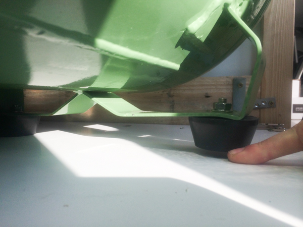

My new compressor did have one small problem: One of the feet is bend up a bit so it rocks back and forth. Nothing that couldn’t be fixed with a little bit of scrap wood but it did get me a bit of a discount so I guess I cannot complain.
It works really nice and actually isn’t to noisy so for now I have been running it with the box doors open rather than dealing with any possible overheating problems.

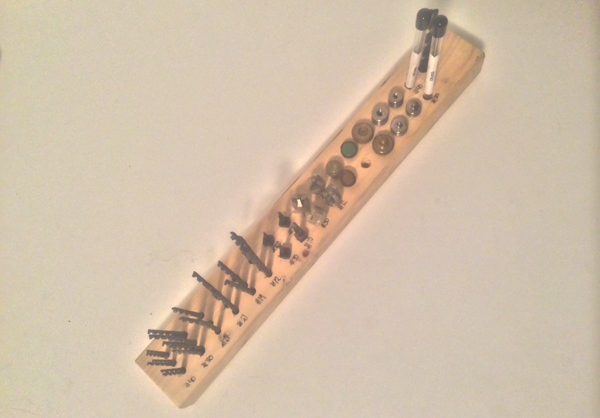

I made this “organizer” for the small stuff.

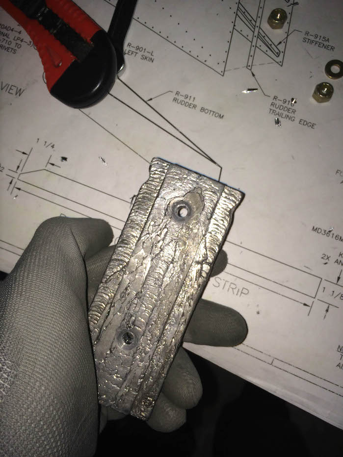

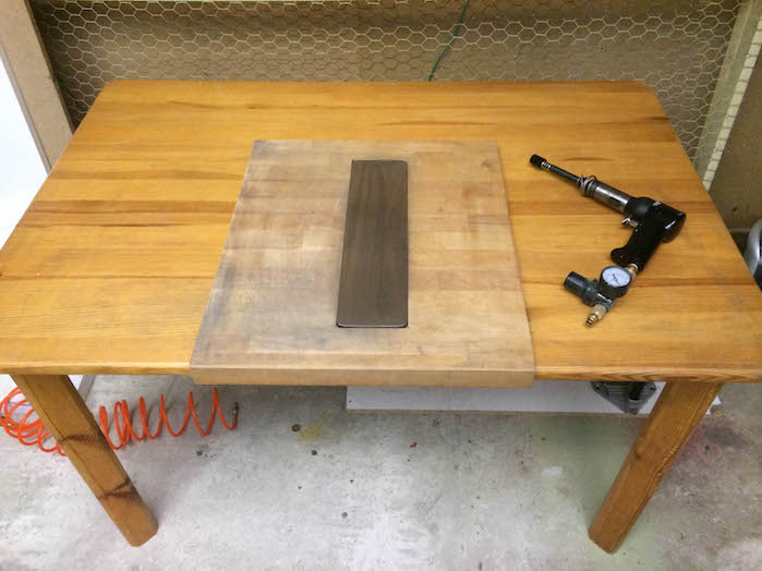

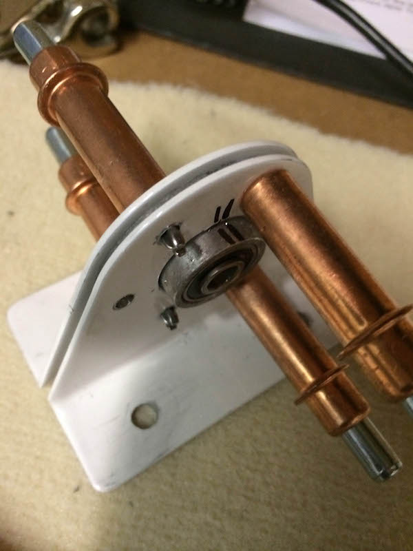

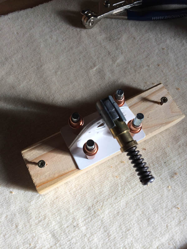

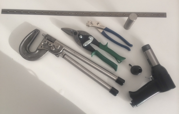

More tools. I also purchased the round 1.5 lbs tungsten bucking...Thus far the only one I have. Time will tell if I need more.
download

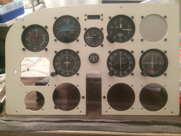

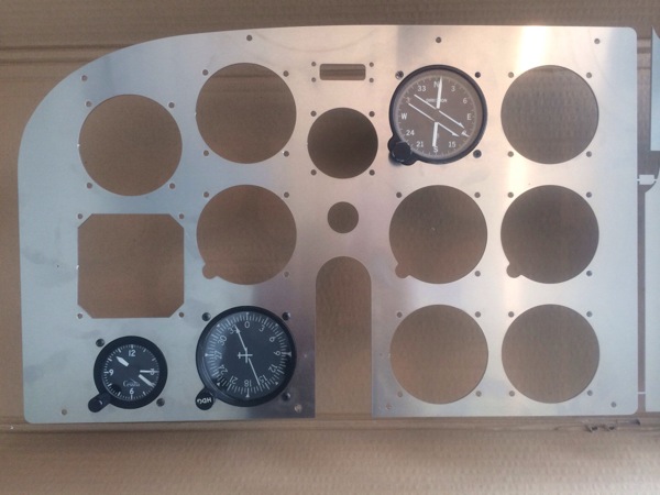

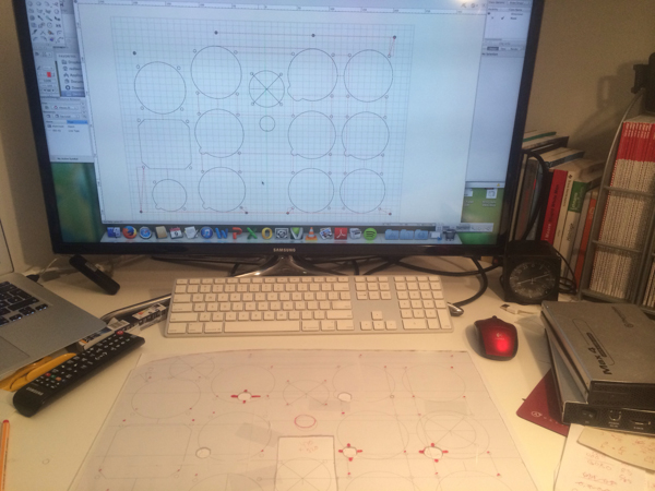

I have been busy with a different project. I made a new laser cut and powder coated panel. I figured I will learn a few things for my RV panel in the very distant future... Turned out to be great fun and I think it turned out rather nice!
I started Tracing the panel with Plexiglas and a sharpie.
download
Then I learned how to use a CAD program...
download
I had it laser cut. I connected all the peaces with little “bridges” and cut them with a dremel.
download
After powder coating and trial fitting some instruments...
download

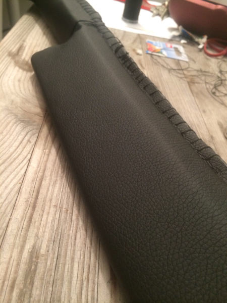

I also made a first attempt at upholstering. Took a while and all by hand but turned out better than I expected. I did't use glue or anything a like in case it didn't look good and needed to take it off again. The edge with the stitches is going to be hidden anyhow.

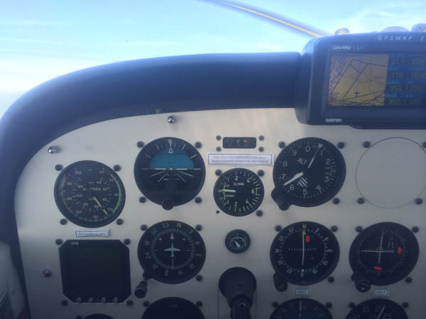

Here is the finished Panel cruising up at 6.5k ft at spam can speed.

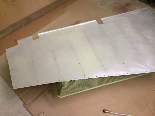

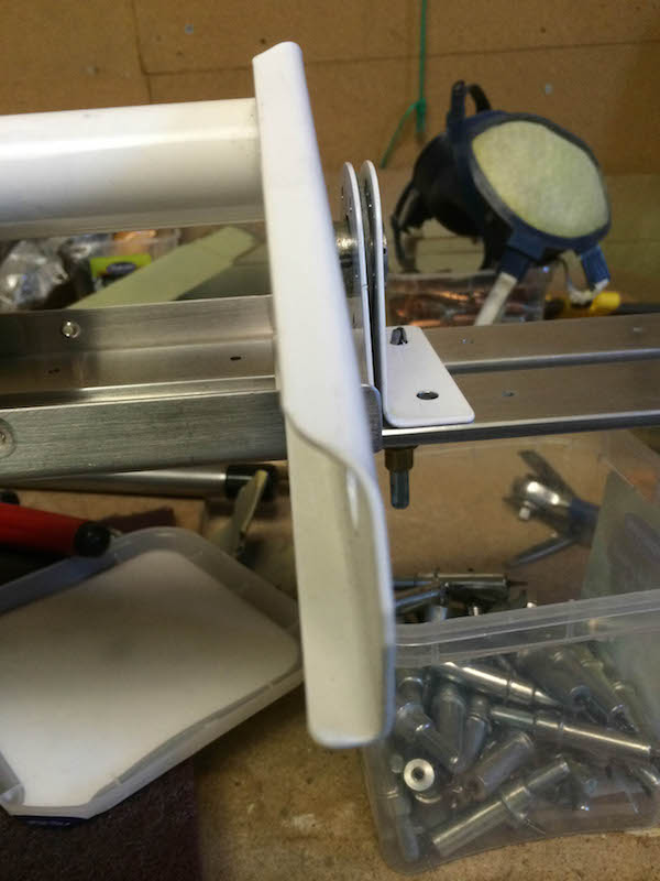

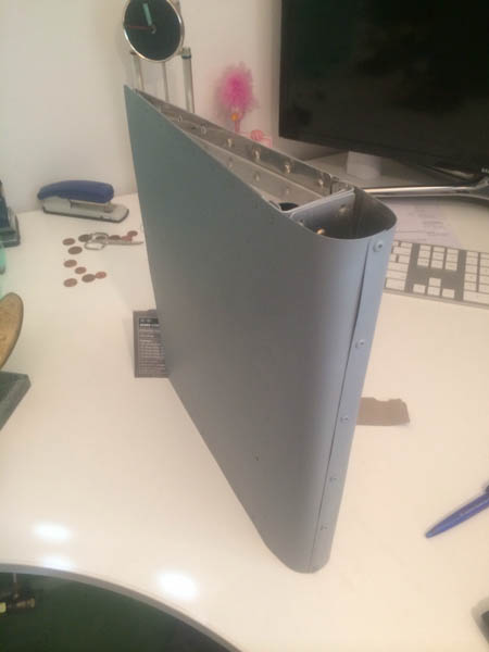

I finished my Mini Wing a while back and felt quite a bit of newbie pain with it. You guys make it look to easy on the internet...I didn't like my quality of my work. Good thing this wing will never fly. Amazing how much a little bit of paint will hide!
I drilled out every rivet twice and put it back together. Good practice.
Here it is:
download

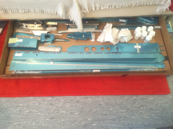

After Inventorying I put everything away. All the parts slide right under my sofa.
download

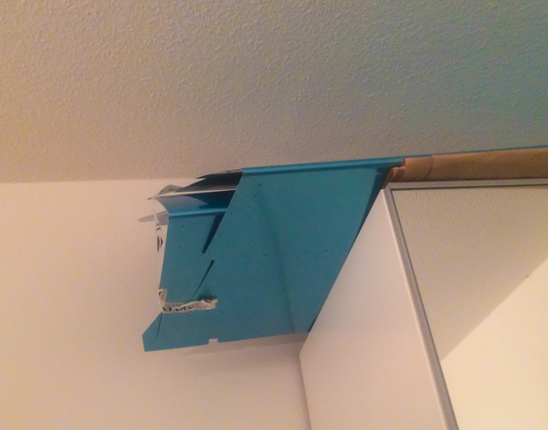

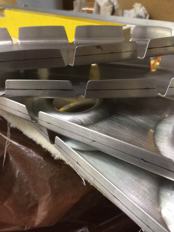

The skins fit nicely on top of my furniture for now...
download

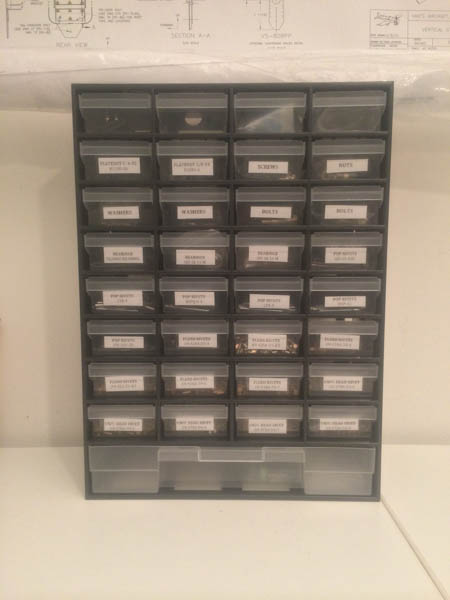

All of the hardware is organized. (If you like the label file click here)

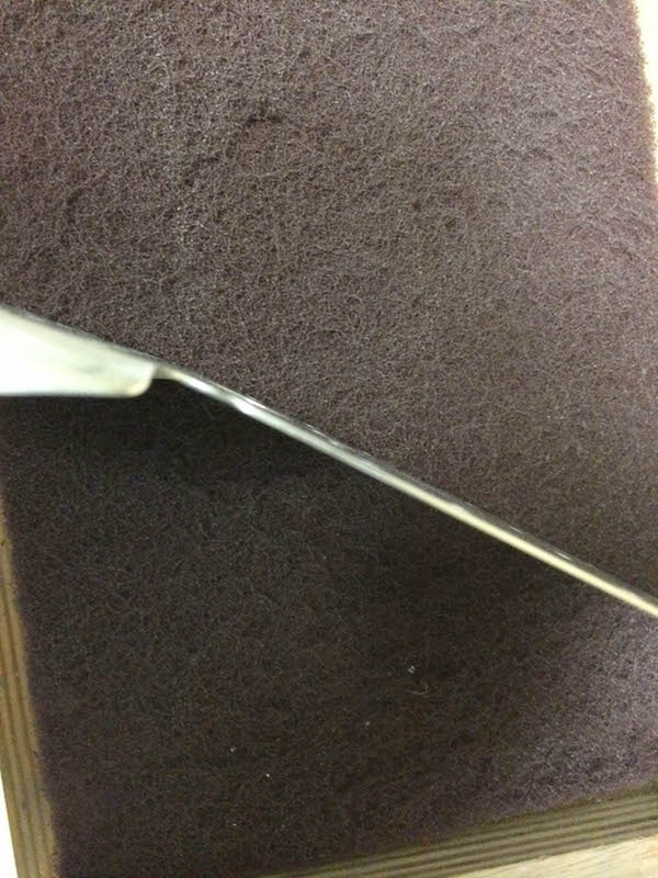

Just a tiny tip...
Before you roll the leading edge, use a tool to break the edge of the layer on top.
Vans manual has a home made tool or you can buy one.
Basically it bends the edge just a little so when the two parts are riveted, the top edge lays flat instead of lifting.
I also break edges on overlapping skins.
#12
Just a tiny tip...
Thanks Larry for all of your help.
I am starting with the VS. So no rolling edges there but I will keep that in mind once I get to that step.
It's a good tip.
Larry is talking about breaking the edge of the aluminum sheet where 2 sheets come together. The "edge rolling" tool he is talking about puts a slight bend in the edge of one sheet, so that when you rivet the sheet down, the edge stays "down" and flush. Congrats on getting started! Build on..

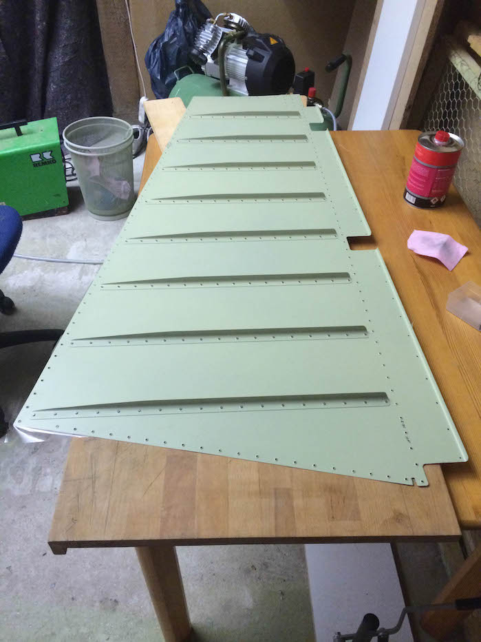

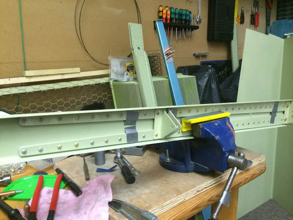

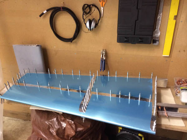

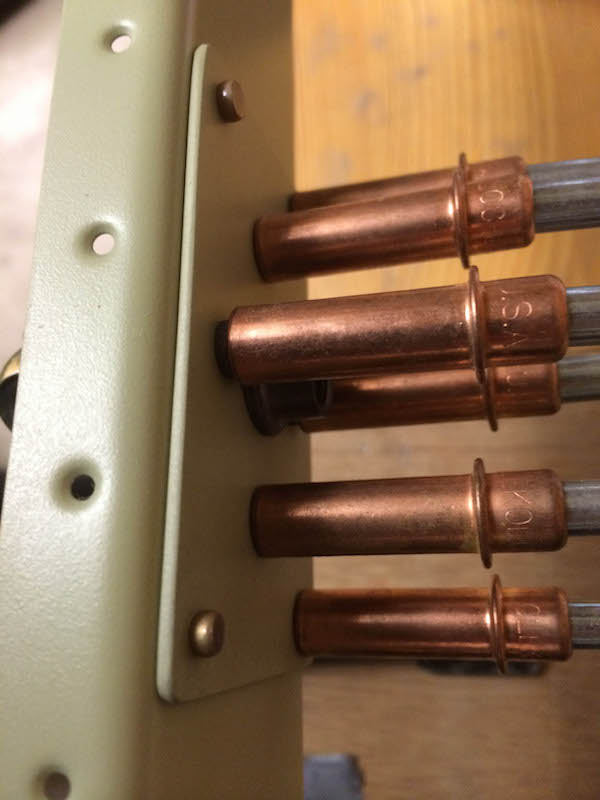

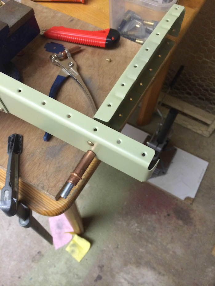

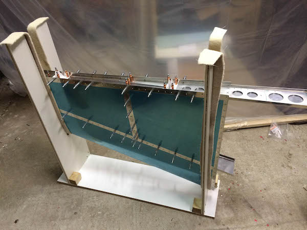

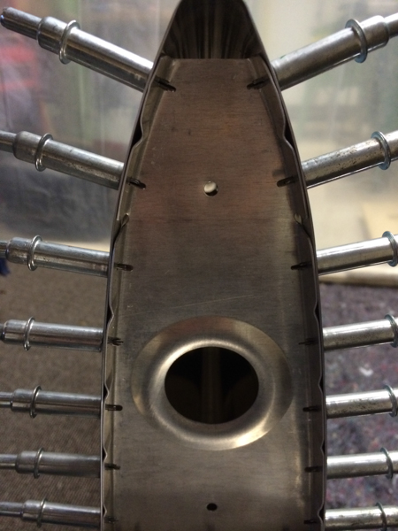

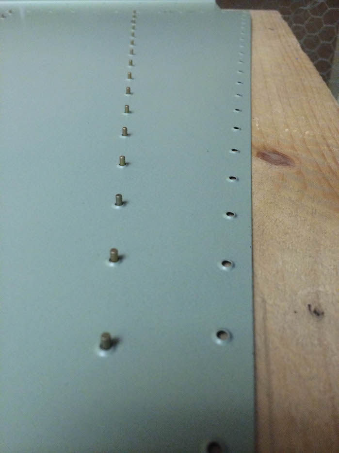

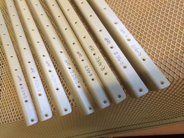

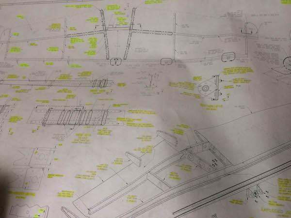

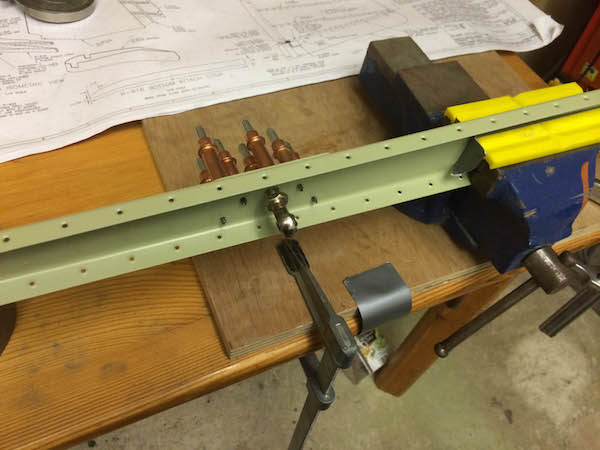

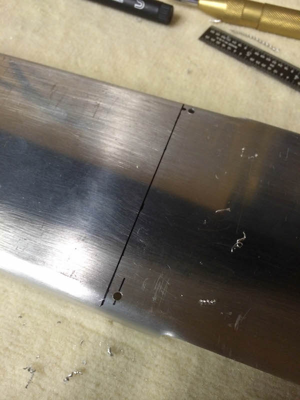

Today I worked on the VS. I followed the plans with fluting, deburring, final size drilling, dimpling, countersinking... It took me a while to get the hang of the different deburring methods and the ScotchBrite wheel. I had to remove the second wheel because it was getting in the way the whole time. Much better now.
download

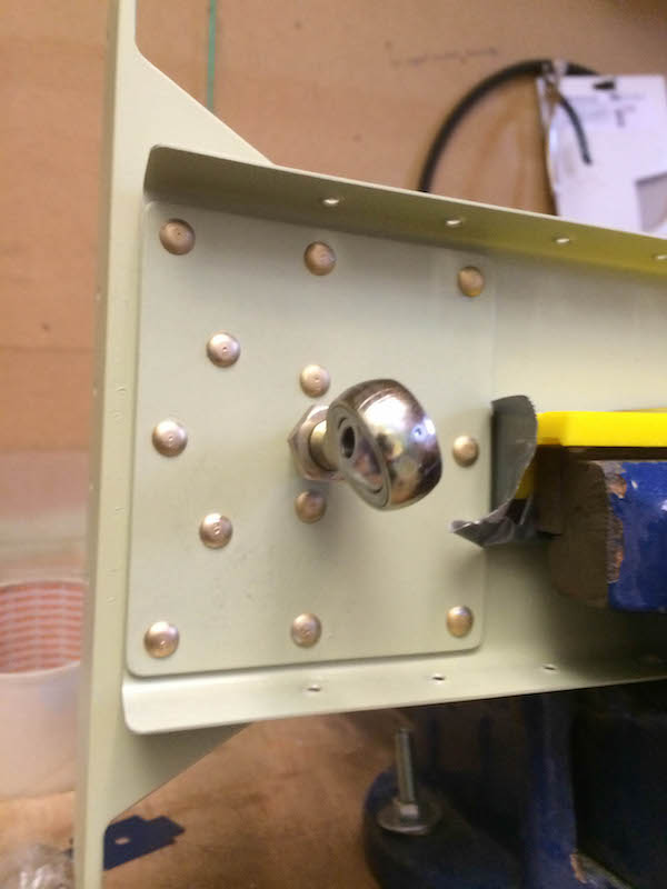

I think I made good progress for the first day. I am now ready to prime. But I will have to wait for my compressor to come back. If I wasn?t priming I could start riveting the VS together tomorrow.
download

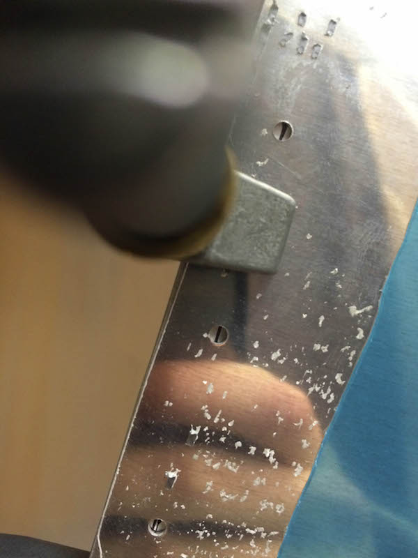

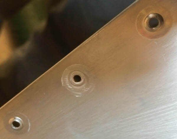

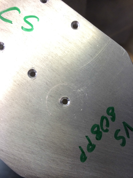

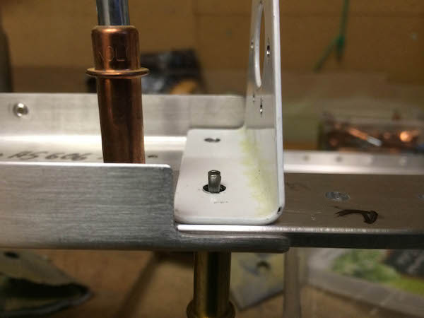

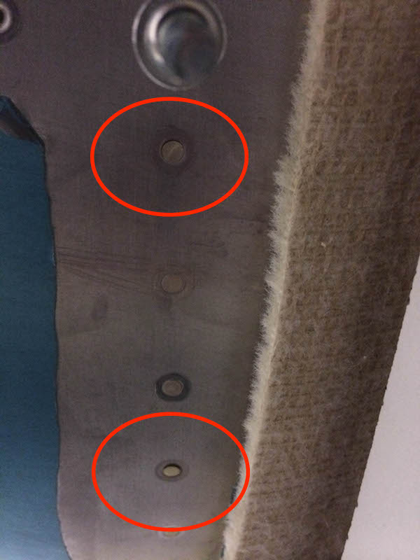

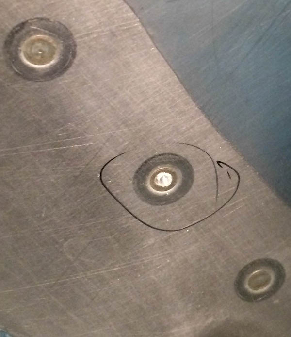

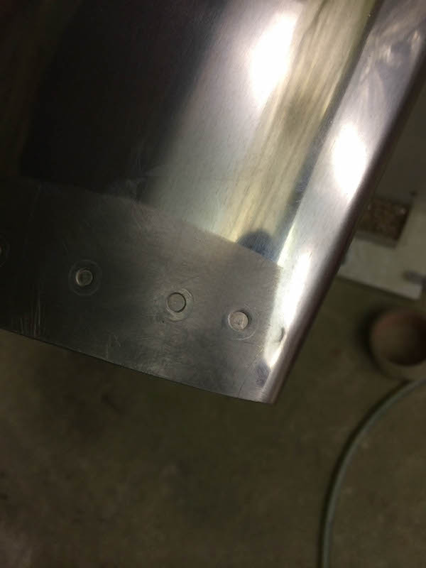

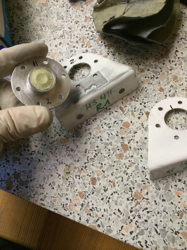

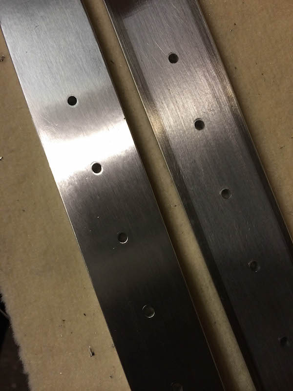

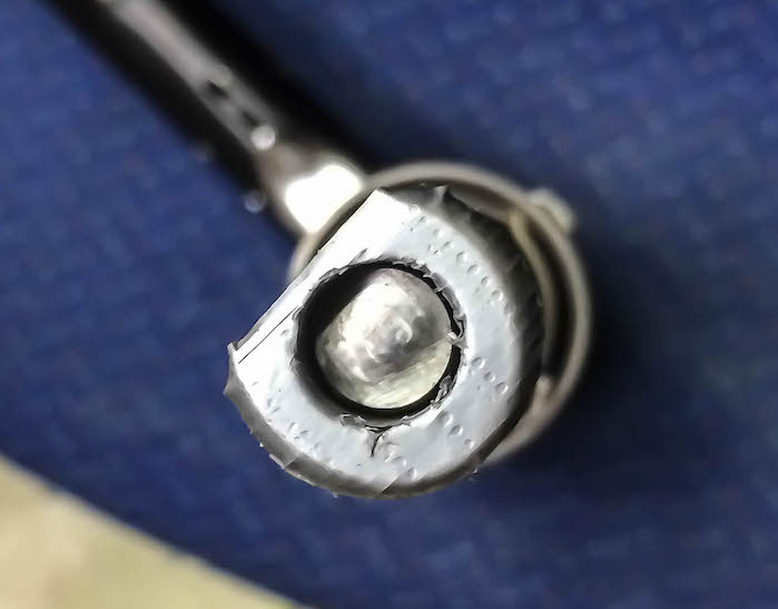

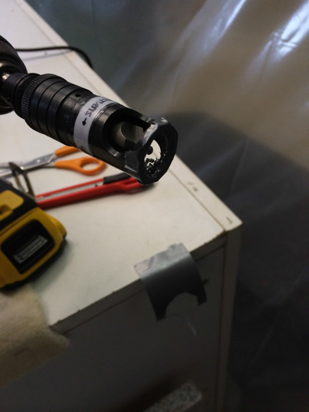

While countersinking the VS-808-PP, I noticed that my countersink cage leaves marks on the aluminum.
download
I didn?t like that so I used some tape to prevent that from happening. Like this. Works great, but I did have to fine tune my settings on the cage to account for the tape.
download

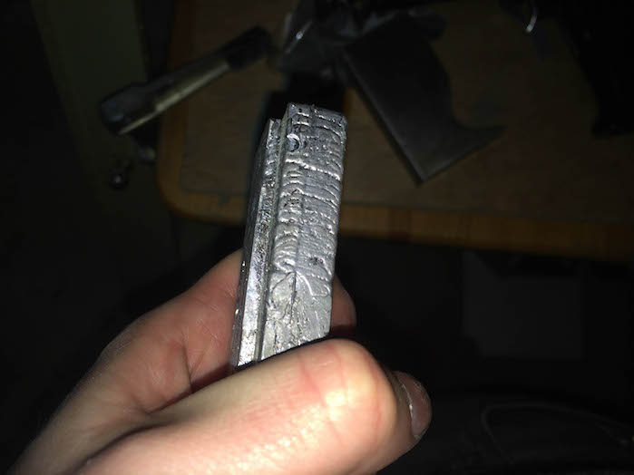

I didn?t notice this until I was ready to go home and took of my gloves?First BLOOD!

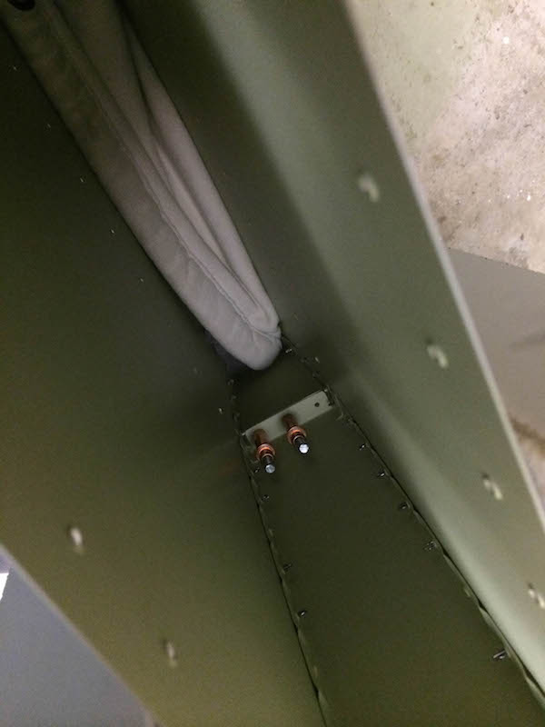

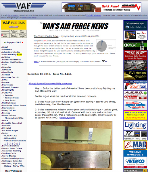

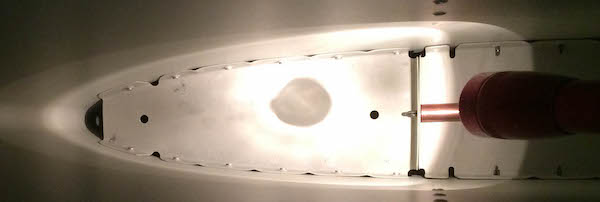

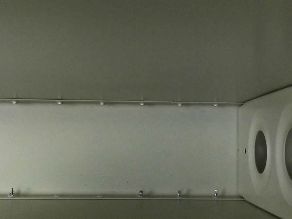

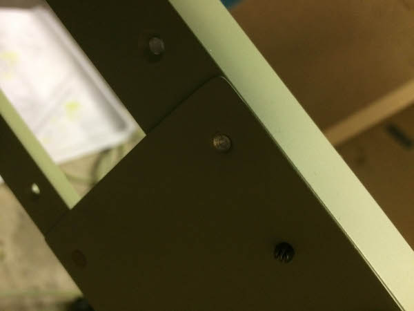

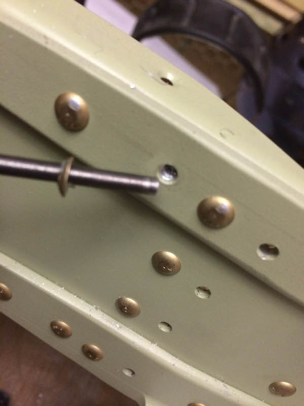

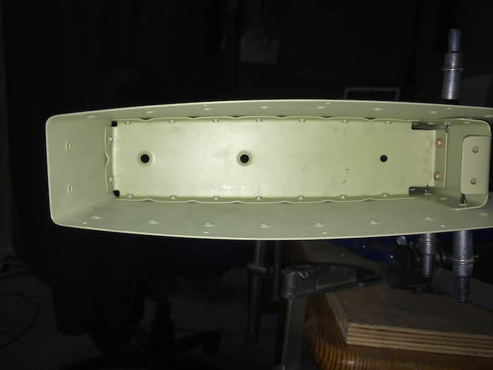

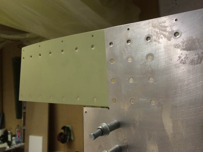

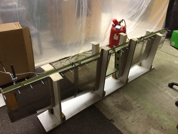

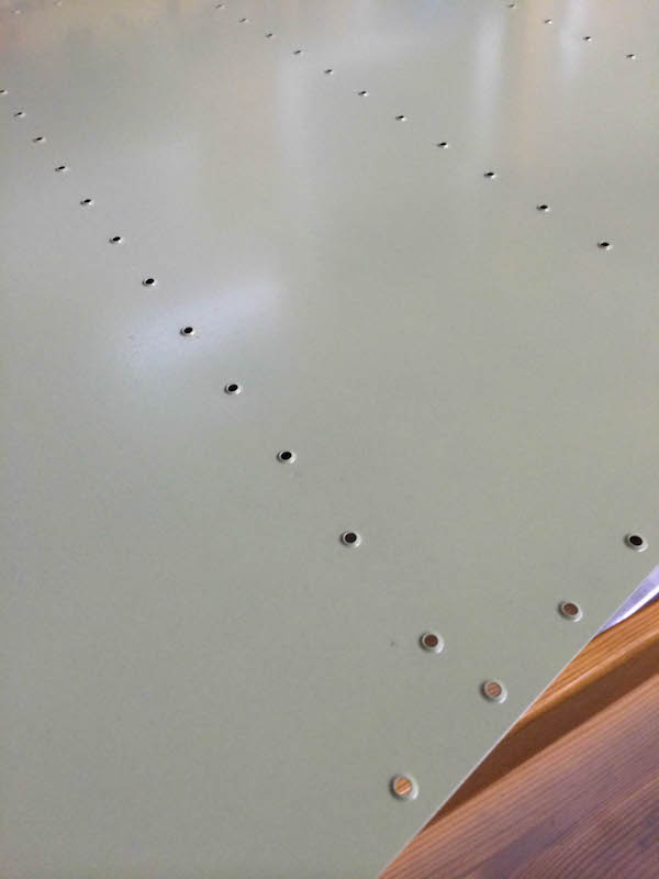

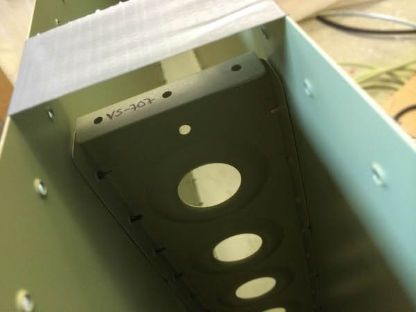

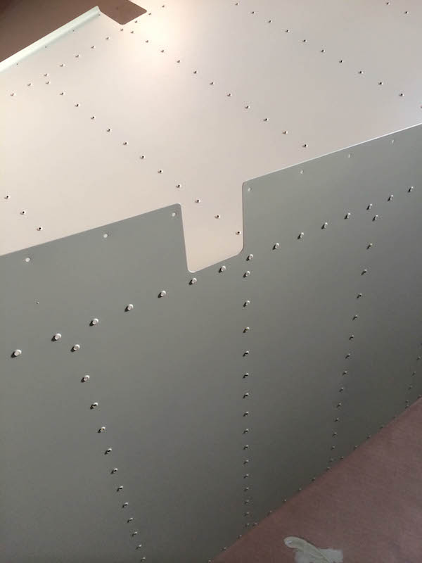

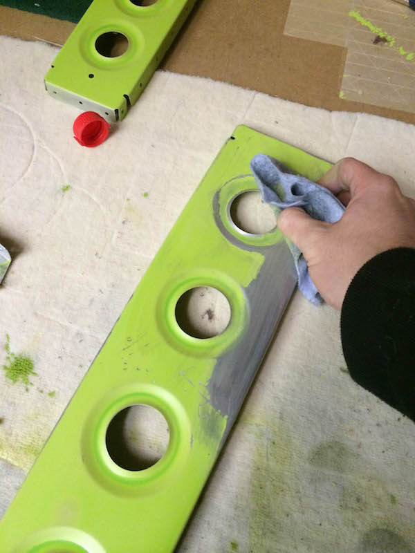

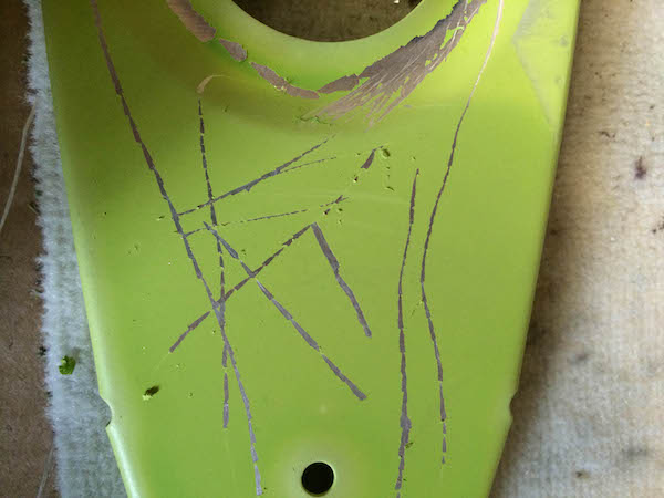

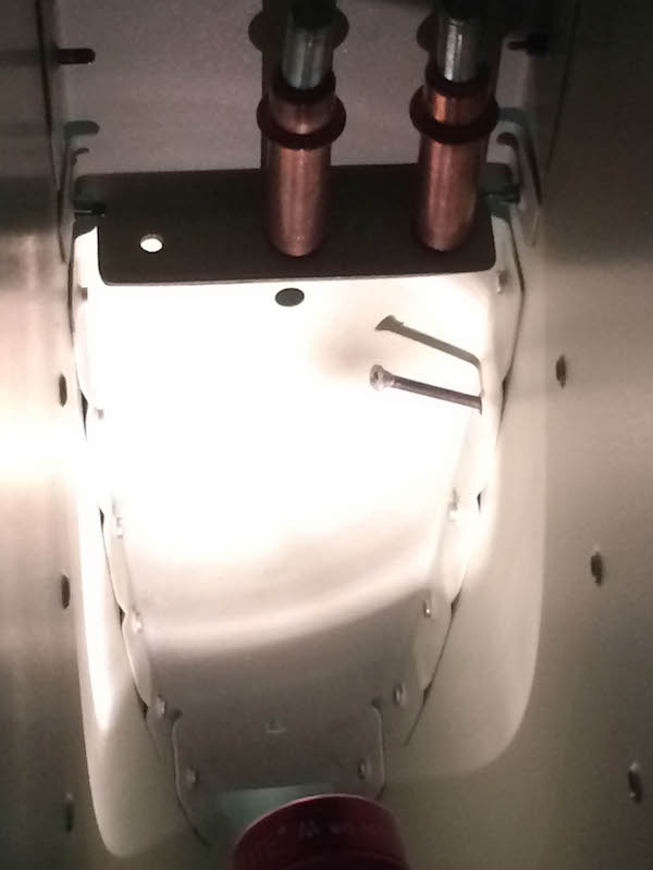

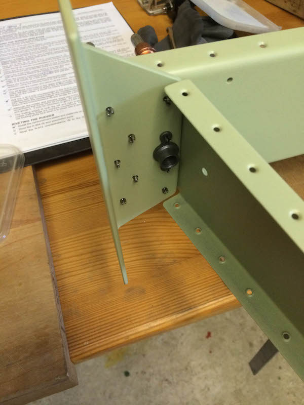

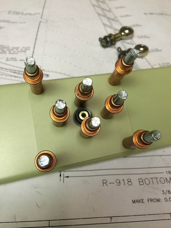

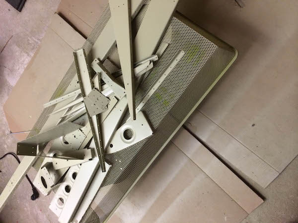

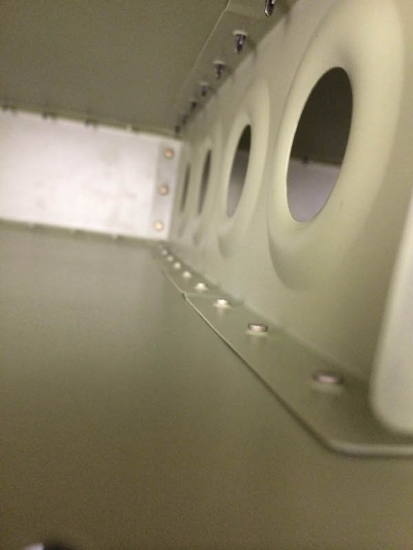

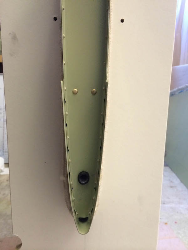

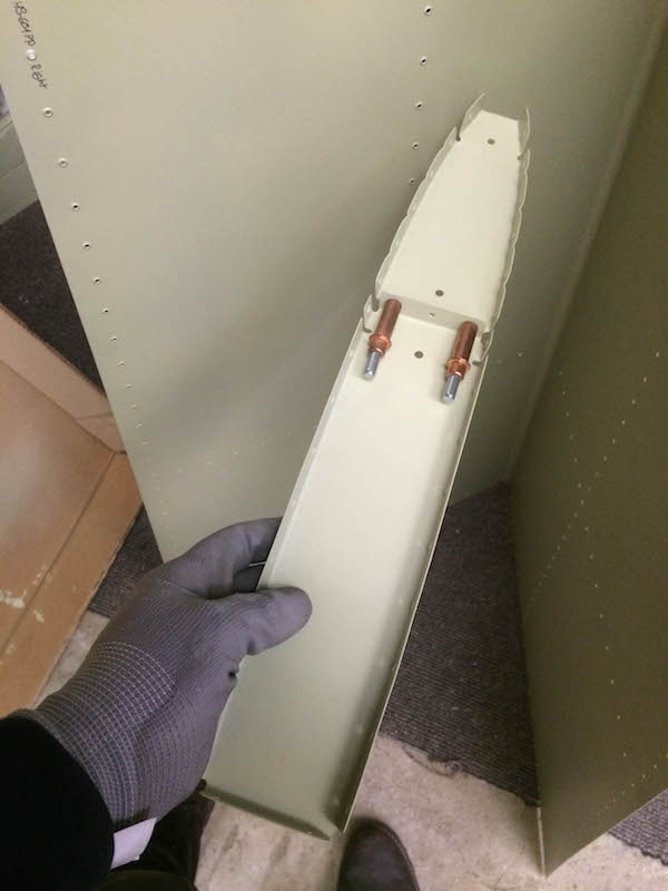

I started with the VS, then moved to the HS and on to the Rudder. However I never set any rivets because I was busy "Almost done with my own little prime war" witch somehow landed me the front page :D How cool is that?
download
I kind of posted that, in the hope I would figure out how well my chosen primer compares to AKZO or other products. I received a great list of alternative products and some good ideas how to apply them. But for now I have decided to put down my weapons and end my war.
After all of the time and money spend on this topic I can honestly say if I didn't feel this crazy need to prime, I must suggest to just skip it altogether. It comes up to be a significant increase in money spend and a ridiculous amount of time added to the build time. So in case you are still undecided. Do yourself a favor and just build it without fighting this war. In the end I was looking for a product that has been widely used by others with positive feedback. This is because as soon as you choose any of the local auto paints available your project becomes the test project and you wont find out how well it works until it is to late to change... I think that is why AKZO 486-12-8 is so popular. It also helps that Boeing is using it. I tried the rattle can by Dupi color and a water based primer by Stewart Systems. I decided against them.
The primer of my choice is green! I really wanted it to be green.
The primer of my choice contains chromates to act as corrosion protection.
The primer of my choice is a 2K Epoxy based product used by Airbus and the dutch military.
The primer of my choice is fluid resistant. The usual suspects such as AVGAS.
The primer of my choice unfortunately is not solvent resistant. Meaning Acetone and some rubbing will take it off.

Here are some pictures.
I sprayed a tac coat to promote adheason
download
After 5 minutes I sprayed one even coat of the primer. Goes on smooth. No runs. No fuzz.
download
After it dried
download
download

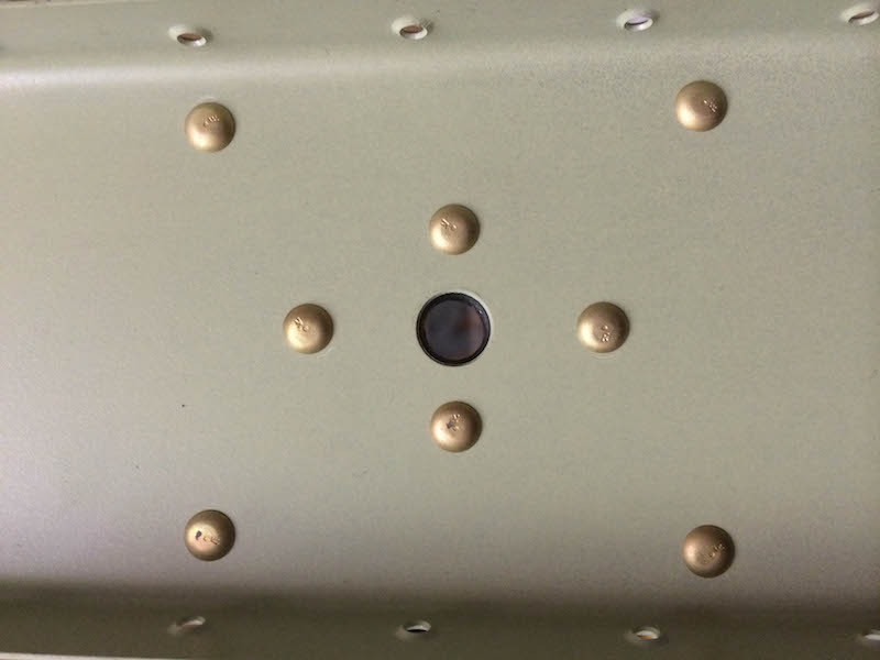

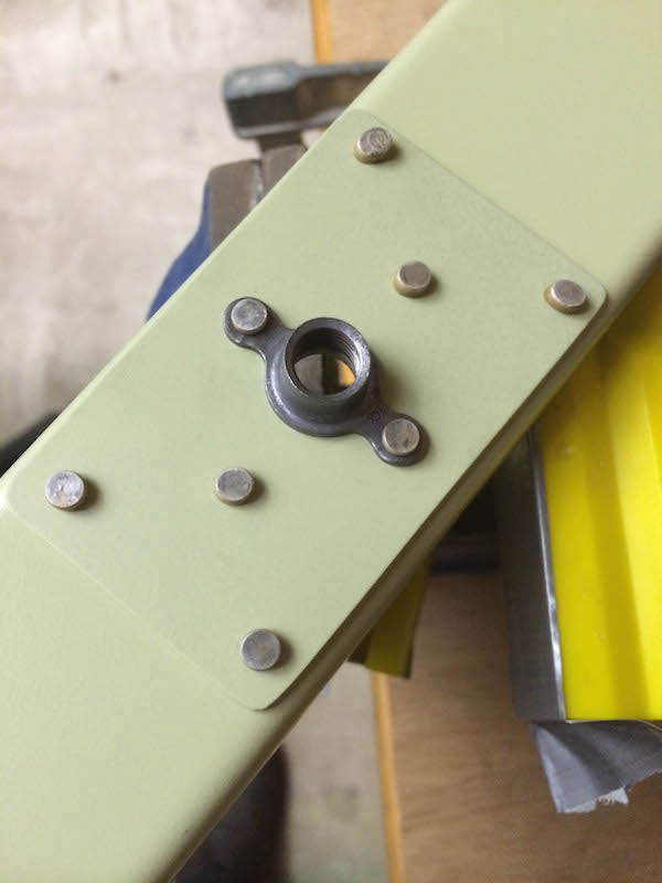

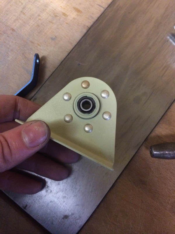

Well look at that... Finally my First rivet is set :)

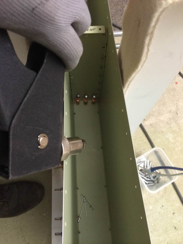

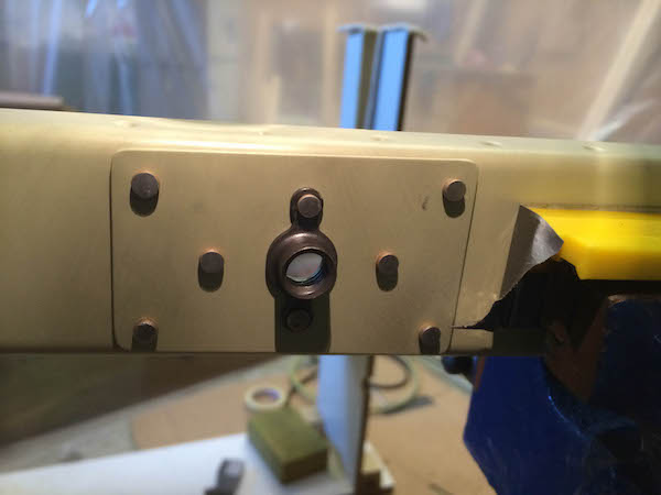

I have to admit that I choose to use my hand squeezer on some reinforcement plates and nut plates of the rudder because I thought these would be the easiest. I found out that I suck with the squeezer. Almost all of them bend over a little bit. Later one I switches to some flush rivets on the skin of the VS. those went in very nicely I think. After setting 6 or so of those I called it a night. I wanted to end on a good note.
download
I thought these would be very easy...They weren't...
download
This was the setup I had going.
download

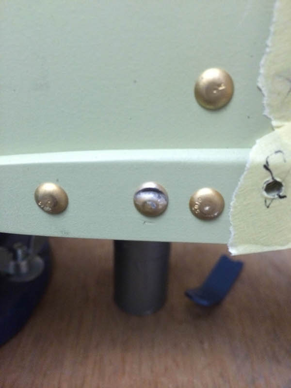

These are officially my first two rivets of my RV!
download
I stopped after that... I am not too pleased with the results but I have to investigate if these are "ok" and just cosmetic or if they have to come out.
download
They look perfect from this side...
download
These were much easier... Maybe I got lucky but I stopped after these.
download
From the inside. I would like to see the skin closer to the spar but not sure what to do about it. Maybe paint or dust in between there...
I choose to drill those rivets out and do them again with the rivet gun.

This was New Years Eve. I spend about 2 hours in the shop just for fun. I like the rivet gun...
I have been labeling my parts on the sides that are going to lay against each other. So in theory no labels will be visible once I am done. I really like the look of the primed parts. Glad my prime war is over.

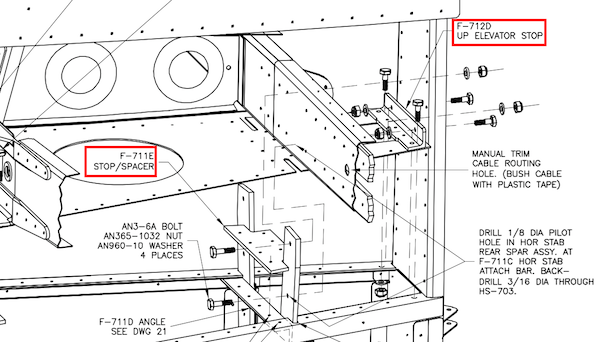

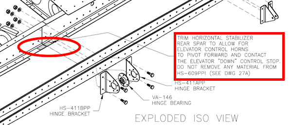

I did some head scratching over weather or not I should cut this now or wait till later and how much to cut. "measure twice, cut once" seems to be stuck in my head.
download
It doesn't tell us any measurements and it is not mentioned in the plans until the attaching of the empenage to the fuselage later on. Thus I questioned if I needed to cut this now or later.
I decided to do it now, because of the note. It says to be careful not to cut into the HS-609PP. Once the rear spar is all riveted it is going to be more difficult to make a clean cut and with everything primed it is going to leave a mess.

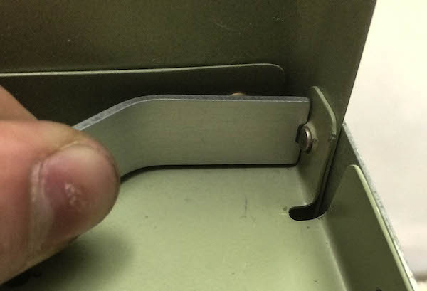

I looked at DWG 27A to see how it all comes together. Here are the Up and Down stops but I decided to just cut all the way down to where the HS-609PP is.
download

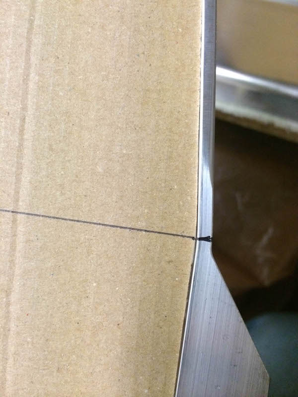

I temporarily attached part of the elevators to see what needed to be cut.
download

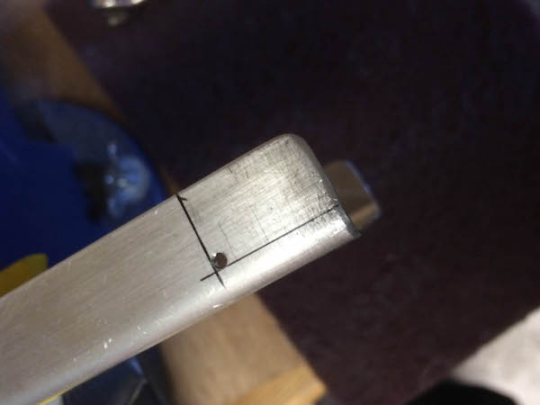

Used this to mark my cut lines.
download
I drilled a whole to make sure I wont get stress cracks here
download

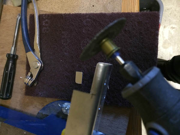

I decided to Cut with a Dremel. Easy!
download
Final result
download

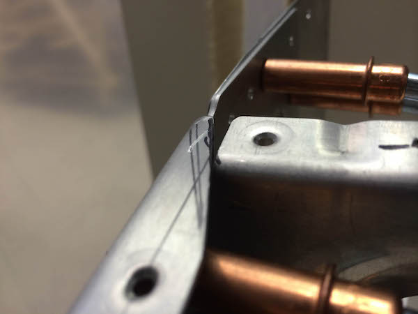

Don't think it matter to much. But on my case the cut needed to be just a tiny bit shy of the end of the HS-411PP Hinge Bracket. So I would think one could just mark that and cut where the hinge bracket ends and be fine as well... YMMV
download

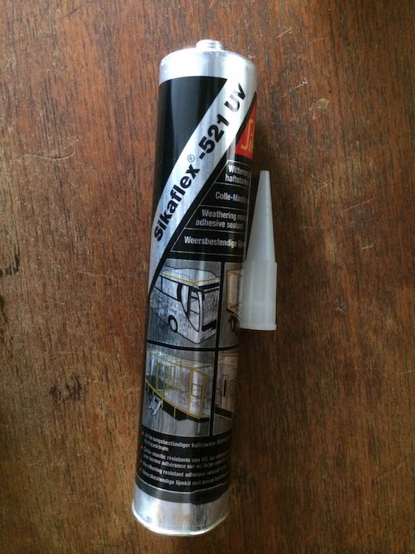

I have been reading, posting and asking questions about the RTV used on the rudder & elevators and how to use it... What I found out is that there are at least as many opinions as there are people.
As a last resort I asked the mothership and I intend to follow their lead on this. Maybe I should have asked them sooner but I always feel silly asking them question. They must get a million a day!
Question:
On the RV7 plans it doesn?t really call for it. However in section 5.7 it does mention it while talking about bending the TE of the elevators.
There are many opinions:
-This was only the case before because the material was thinner.
-Epoxy/proseal the whole stiffeners before back riveting.
-Putting a blob of RTV or proseal at the front end of the stiffners because cracking may occur there as well?
Could you specify the brand of RTV you use and found safe to use on Aluminum. Lots of opinions here as well.
Answer:
I would recommend you add the RTV as described in section 5.7 to stop the potential of cracking rivets at the trailing edges. Pro sealing the stiffeners to the skins however is optional and on a 7 wouldn?t make much difference. As far as the RTV goes we just use standard high temp RTV, yes it slightly corrosive and will etch the aluminum but we have yet to see any problems caused by it. If this is concerning to you I would recommend using tank sealant in the place of RTV.
So there we go... Al my problems gone all of a sudden... By the way I don't want to use pro seal because I would have to import it and it would be somewhere around 80$ and I wont need much of it. I just don't want to spend that kind of money. It will also go bad before I get to use it again.
However I found a product made by Sika that seems to be perfect. It is made for metal. It can be used on unprepared metal and primer and it is silicon free and non corrosive. I would call that a winner! It comes in 3 colors. Here is the Sikaflex 521 UV TDS
download

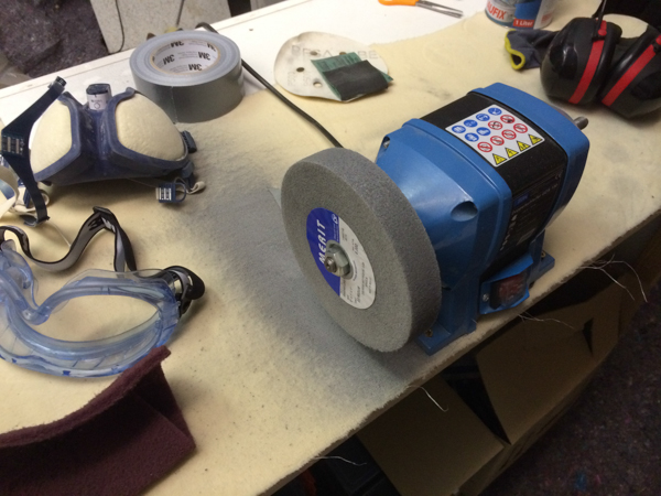

After my epic prime war I had to lick my wounds...As I had mentioned I used a water based primer first and I made the mistake of using it on ALL my VS parts. YES ALL OF THEM! Unfortunately the quality of this product was not acceptable to me. So I added a good 15 hours of cleaning bad paint of every single rivet whole and all parts of the VS. That totally sucked!
download
This was just with my nails...
download
Aceton will do the trick but in the process it becomes glue a like and it just was a huge PIA to get all of it off. I had already dimpled the wholes so I used Q-tips to get those clean.
After the clean up I primed all the parts again with my new paint and it came out beautifully. Although nobody will ever see the inside it would have bothered me to have bad paint on some part of the plane.
download
These were some of my first flush rivets on actual airplane parts. They are "ok"
download
I label all parts but only in places that are later riveted to other parts. I used some tape here to hold the skin tight to the rib while riveting the top rivet there.
download
Some more rivets...
download

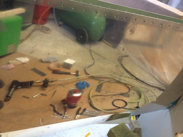

As you can see I am a bit of a "messy" but it works. One side of the VS is all done! I was so freaking excited! BTW this is the moment I realize polishing may look cool. Not sure if I already scratched to many of my parts.

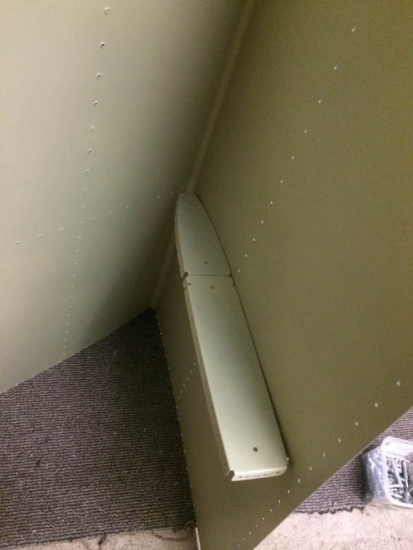

View from the top. I added a way to get a cable up there if I choose to. Not sure that I will, but I always thought a build in camera on top of the tail would make a neat view.
download

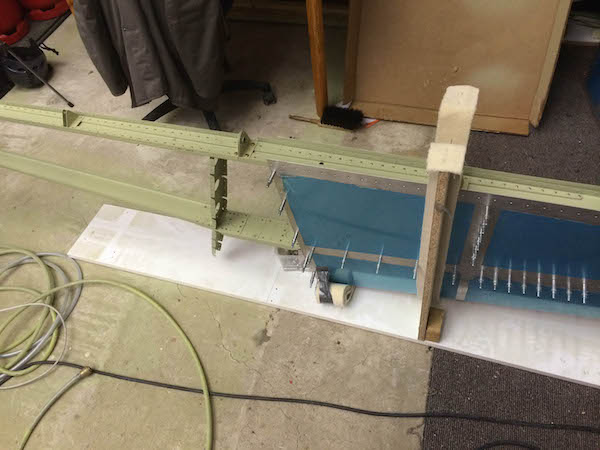

First thing the plans has you do is this: I choose to follow what other people have done with a piece of wood and then drilling the wholes.
download

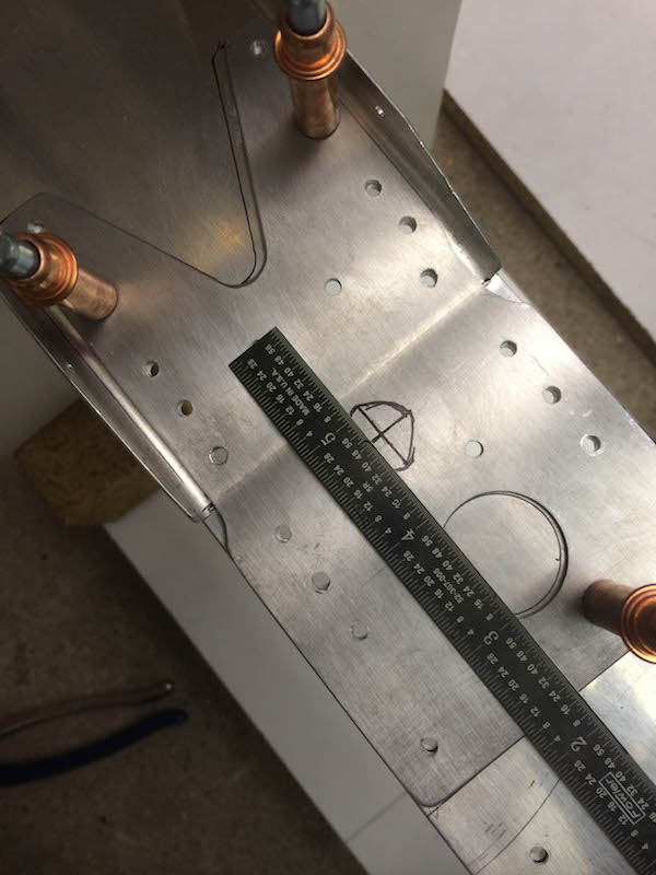

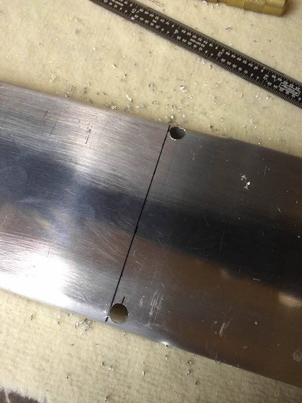

Manual trim line whole on the left side only
download

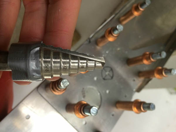

Unibit taped to the correct size
download
First real mistake. Don't know why I did this but I did make the cut on both sides. So yea there we go.

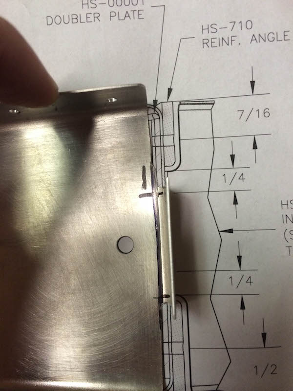

download
Since ED is always a problem I cut this quite conservatively. But after realizing what the reason for this cut is anyhow I could now fix this.
download
I drilled these with the long drill bits. 3 out of 4 were perfect. 1 walked away from me a bit. At the time I didn't see it but this was very close to having to start over the whole front spar because of ED. I measured this 3 times and while again really close I am still within limits. Consulted VANS on this and they said it is fine as long as its within limits.

After straightening I marked center lines on all of them.
download
Now I could make sure I hit the center of the ribs by aligning the wholes with the lines. But I didn't dill just yet. I just used a different color to mark the whole. An X so to speak and took it out again to flute it. Now with knowing where the X is I knew were it was safe for me to flute. You really dont want to flute where a rivet needs to go. So flute and back in for final drilling of the whole.

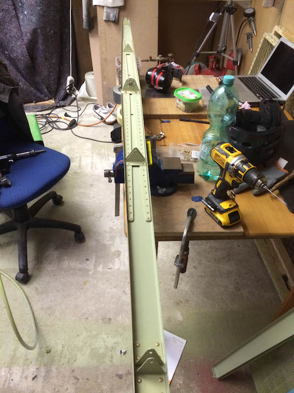

Rear Spar:

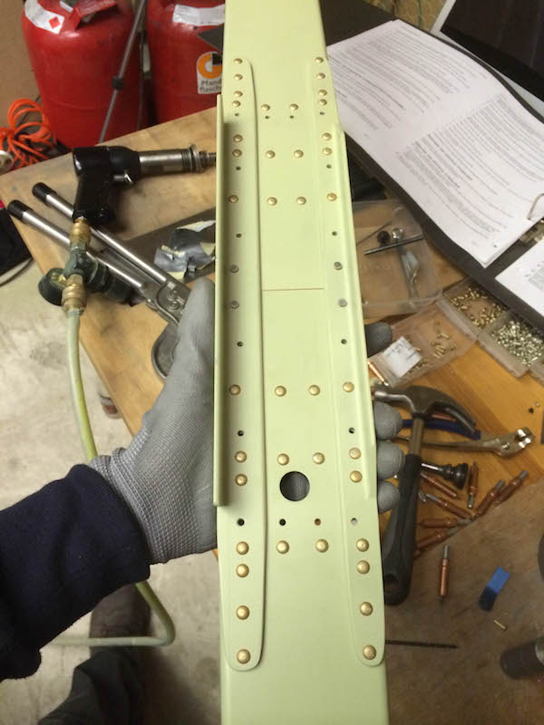

download
After drilling the rear spar and priming and taping the wholes that need to be left open for the ribs I riveted the rear spar together. I used 4-7 rivets on all of these instead of 4-6 because they are just a better fit in my opinion. The rivets on the brackets could be 4-8 but I didn't have any of those.
download
Finished product. All done :)

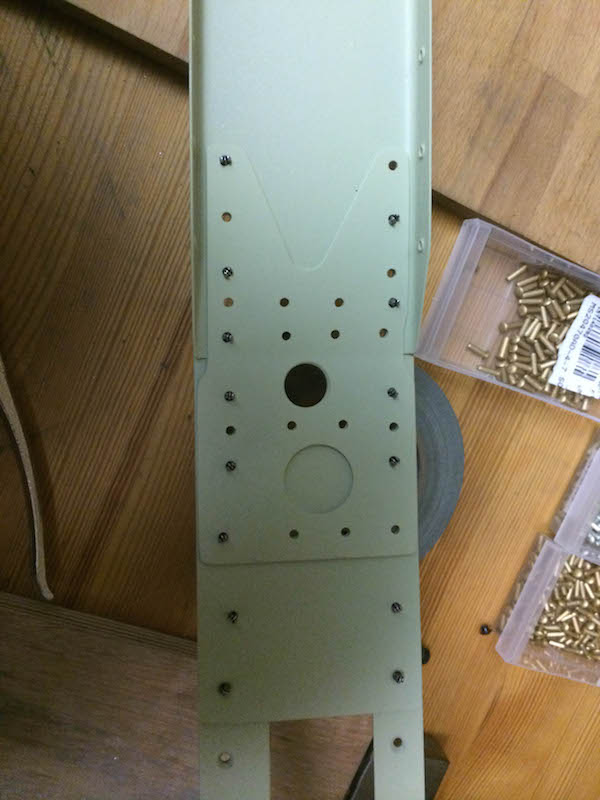

First thing I had to do is find out what wholes are left open and tape them.
download

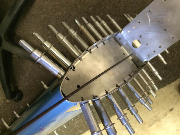

Riveting the HS-707 nose rib:
I had to think about what the plans say here for a while. Especially why they tell you to optionally use the pop rivets on the bottom side. That is because I did it differently than the plans tell you and then pop rivets on one side only no longer make sense. If any then on both sides.
download

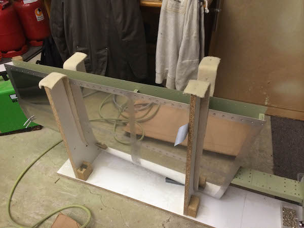

I clevoed the HS-707 and the HS-708 together and clecoed them to the skin while it was standing. This worked much better than on the table. On the VS on this part I got a little dent in the skin because I did it on the table. So that was the reason for my deviation.
download
One side first. When I pulled the skin in I just had to be quick because there is a lot of tension on the first clecoe holding the skin.
download

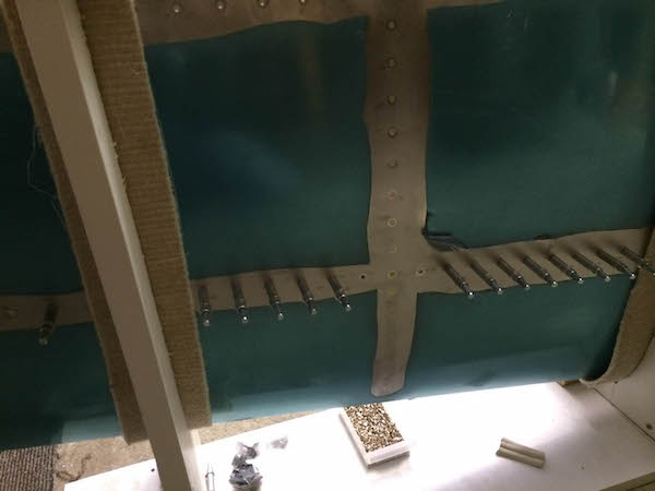

I used another jig type mount to hold everything while I started to rivet. I also put my hoody in there in case I drop something like the bucking bar in there and ruin my day!
download

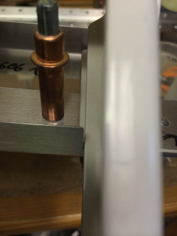

On the front rivets of the ribs I had a hard time making sure the rib and skin are sitting tight on top of each other. So I put a little wood in there to help with the pressure. This worked out really good!
download

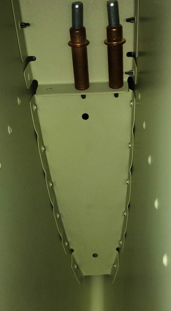

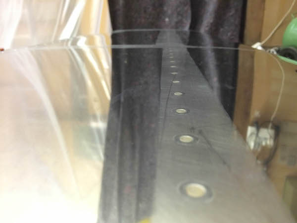

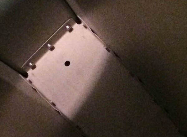

Today I spend about 2 hours in the shop. The first thing I did was inspect my work I did the other day. I also wanted to see what the pop rivets looked like from the other side.
download
I stuck my cell phone in there with a flash light.
Next I moved on to the flush rivets of the left HS skin. I actually managed to get all of them without drilling a single one! and I did it in just about 2 hours. So this was a first! I called it a night after that.
download
Well I supposed I left the 2 top one on each side of the HS-00005.

I feel like I always manage to screw up one rivet so that I alway have to drill one out. This is pretty much a non event as long as things are accessible at this point.
Drilled this one with a smaller metric size drill bit...
download
Then give it a few turns with the actual size drill bit of the whole and pop of the head. usually they come right off.
download
This is from the inside. This is how I like them to come out. Dead center on the punch!
download

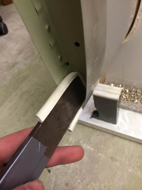

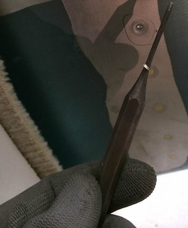

On the outside ribs HS-706 I used this self made bucking bar for the last 2 rivets where things get real tight. This worked out "ok" I do not own a no whole yoke for the Tatco. They are like 75$ and by the time they get to me they are around 150$. For now I am going to try to get away without it.
download

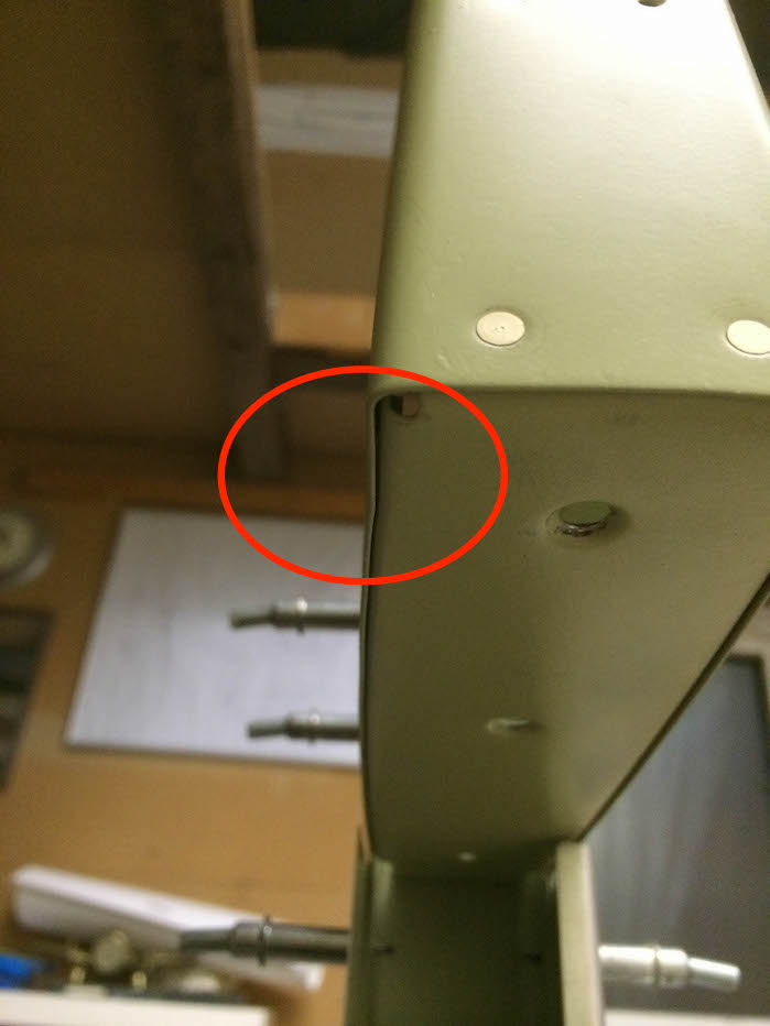

This is pretty much what I get for being a little cheap... A little dent on the outside
download
For now I will consider the HS done because I still need to get somebody to check out my work before I close her up but there are only a few rivets left. Everything accessible from the outside
download
***PS*** (Day after) I feel like I had one heck of a work out. May have to cancel gym membership...
You will not see that little dent and it may have been caused by the end of the rib, not the bucking bar.
Excellent technique on rivet removal.
Your work looks good.
Thanks. Yea I figure if I do paint up there the fiberglass and filler will cover that all up. Still It bugged me quite a bit. Getting over it now ;) But good point. I didn't think about the possibility that that might have just been caused by the rib itself. Poor prep then...
Really gives me confidence that you say that it looks good. Nobody but me has actually seen my work in person thus far.

Today I cleaned up the shop a bit from the HS work and started fresh with a clean table.
download
Yap. Back riveting the stiffeners of the rudder skins.
download
A bit of tape helps to prevent marks on my parts
download
One skin done, one to go!
download
The counterbalance rib R-912 riveted to the R-902 spar. Honestly I couldn't find the rivet call out on the plans... but I just used what I felt was the correct length. I think a 4-5
download
Counterbalance skin R-913 riveted to the R-912 but not to the spar

The counterbalance led didn't clear the rivets so I needed take some led off
download
Here we go. Hope Vans took this into account...
download
