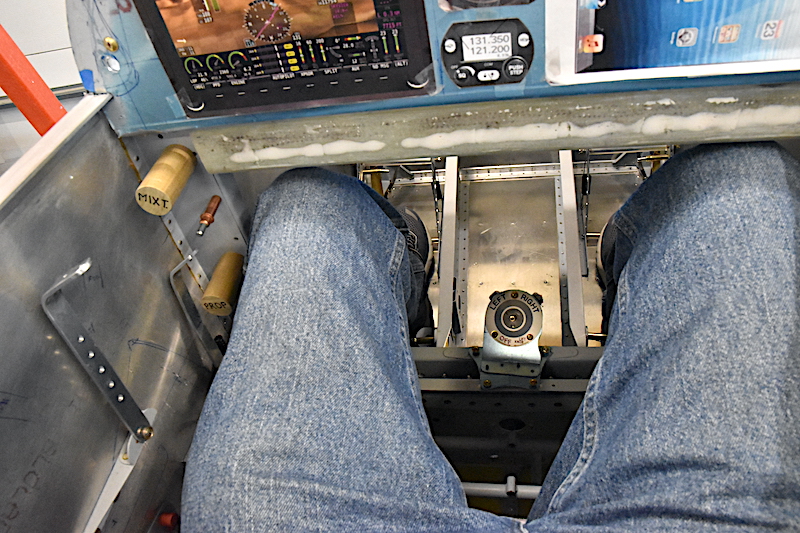

I have sat in the cockpit a number of times with the switch panel (and the avionics shelf, which is part of the same fiberglass part) installed. I need to pay attention to my legs getting in to miss the switch panel but not much all in all; it's not a big deal. Getting out, there is no issue.
Once in the cockpit there's plenty of room for me. The switches are inset about 3/4" from the panel, forward (that is, airplane-forward, and away from me) of the panel and there's plenty of clearance, about 1.5", between it and the stick. That's shown a couple of posts earlier. While accidentally moving something might be an issue, I don't think it will be - especially with the current switch panel layout, which moved the push-button switch closer to the center. I'm also changing switches for better feel, but that's a separate issue.
I am about 5' 7" and have relatively short arms. When I buy long-sleeved shirts they are always too long in the arms and often either just right or a bit short in overall length. For me, it's enough of a reach to the switches that I'm not worried about accidentally bumping one.
The RV-3 as designed has an indented seat, allowing more height for a tall person like Van. I filled that in and still need a cushion.
Please keep the cockpit comments coming. Cockpit layout is a new science to me and I want your comments and insight. It's curious.... I can tell good design from bad but have little idea how to get there except by trying out concepts.

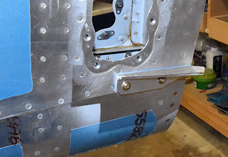

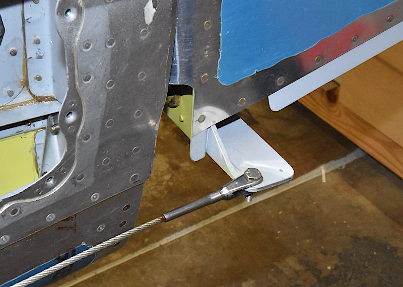

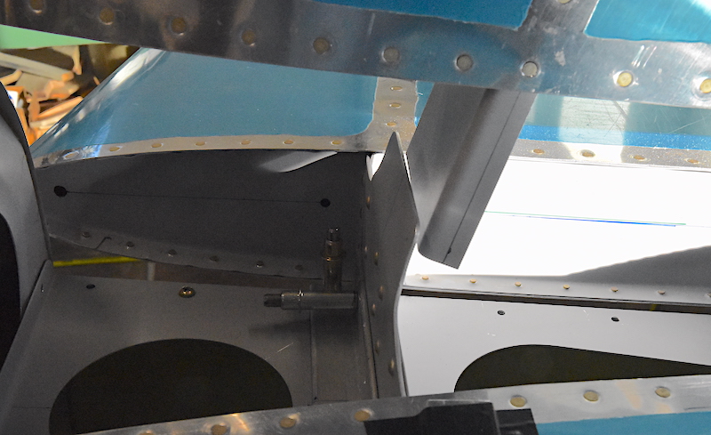

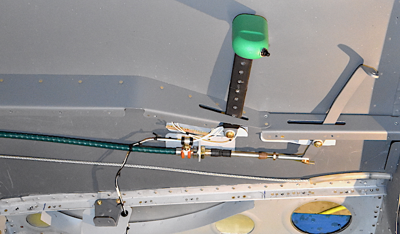

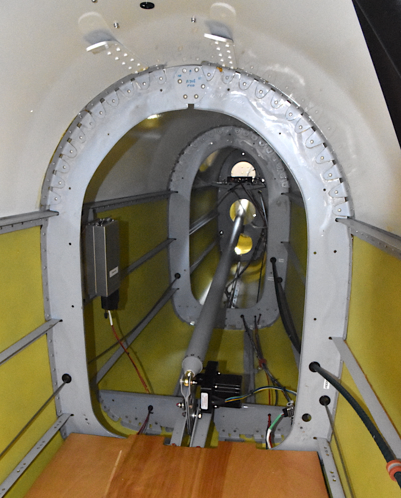

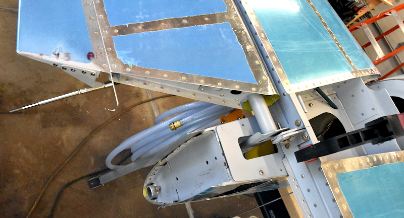

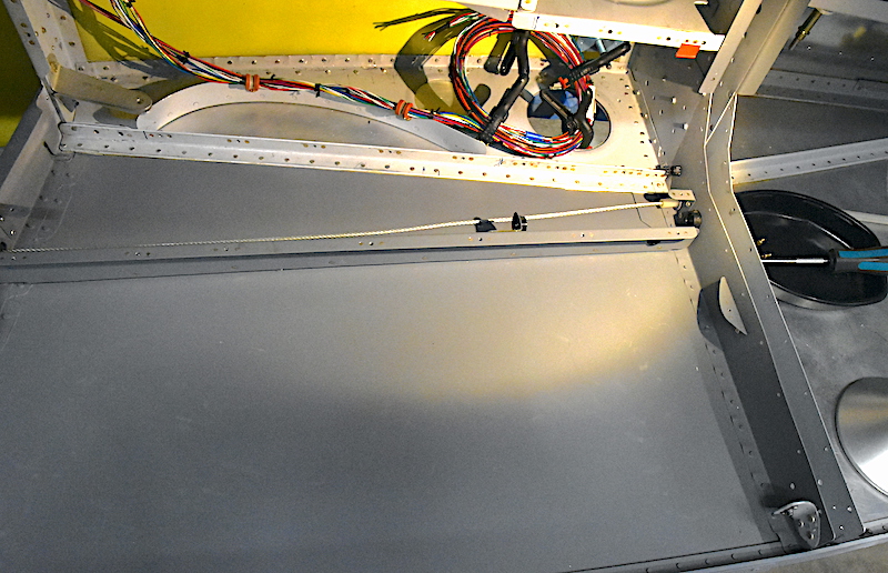

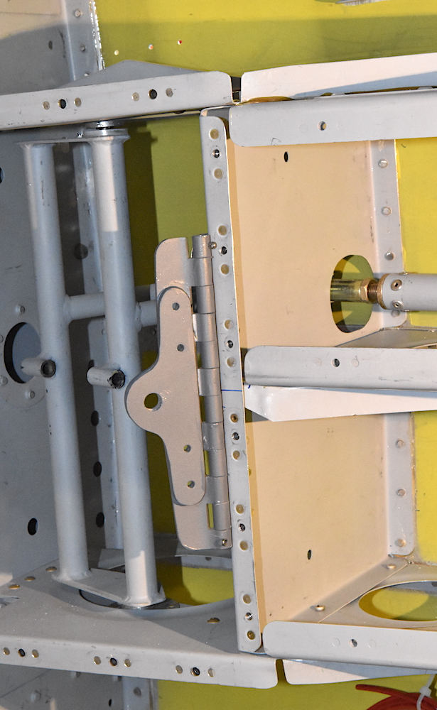

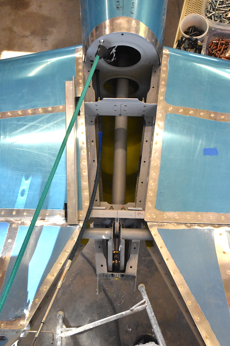

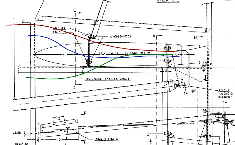

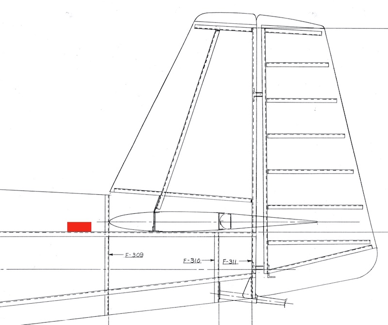

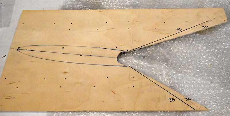

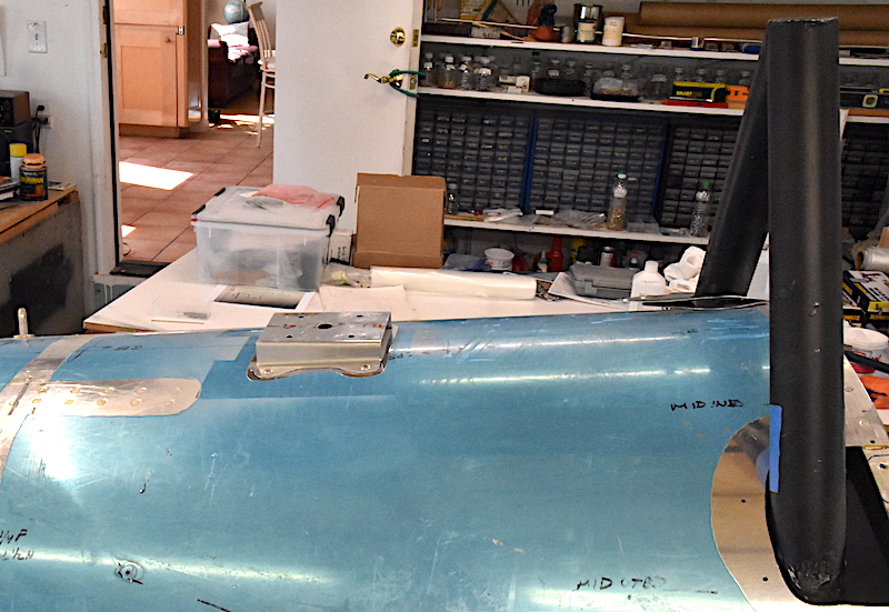

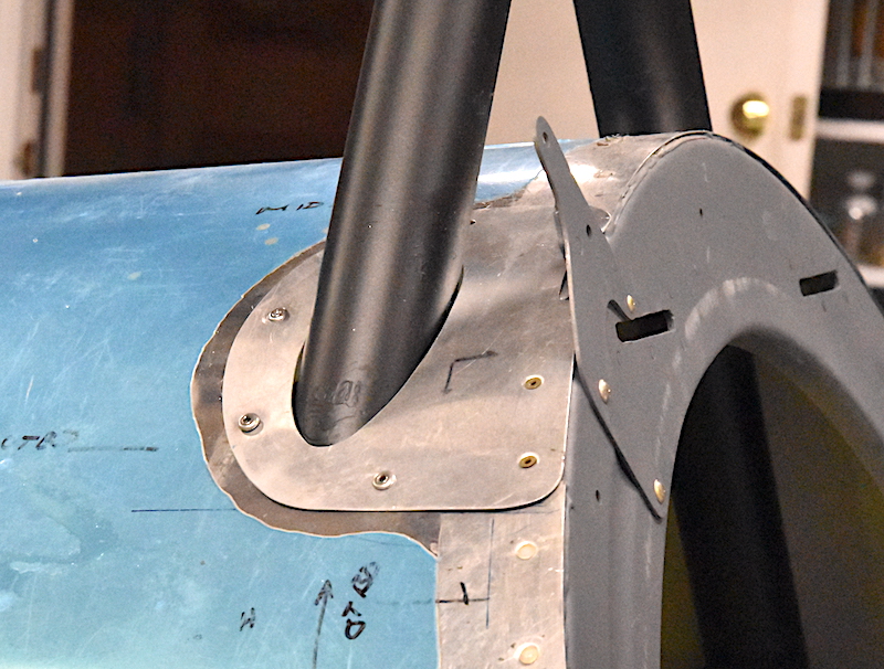

One of the things in the cockpit on the left side that affects other things is the trim handle. I need to know where it goes. Since the trim cable is made, the handle is at the forward end and the trim tab is at the aft end. But to get to the aft end, there’s this little problem - how to carry the cable around the horizontal stabilizer?
I asked VAF readers to let me know how they did it. Since many RV-3s seem to have electric trim, the information is a bit sparse. I got three replies and drew them on a section of Drawing 26 from the plans.
The red path was used by two builders. It fits under the empennage fairing, but requires somewhat of a deep dive into the stabilizer. On my plane, the cable will interfere with the ADAHRS and its mount which is in the tailcone just ahead of that bulkhead. It’s too bad because this is simple and fairly straight-forward.
The blue path was used by one builder. It’s a nice clean direct path except that it requires a hole in the forward spar. I’m reluctant to do that.
I chose the green path, even though I needed to figure out how to get the cable through the aft deck (the red and blue paths bypass it).
With a hole through the aft deck and a hole through the horizontal stabilizer root rib, the trim cable is in place. The lengthwise positioning of the cable is not correct, it’s about 7” too far, but that’s been adjusted subsequent. The holes are too small and there are a few more minor tweaks to do. But this is the general path.
It was sufficient to let me find out where the forward end of the cable will be in the cockpit, and that was the purpose of the exercise.

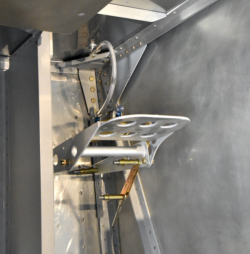

The bulkhead fittings for the brake lines arrived and I drilled holes for them in the firewall. This is the first equipment mounting on the firewall, and it’s now so that I can figure out the brake flex hoses from the cylinder (there’s one cylinder on the left) and mount those and the rudder/brake pedals. The circles show where they are.

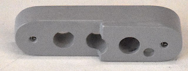

Since I’m making my own throttle lever, and I’m putting the PTT switch on the throttle, I got to get intimate with the switch today.
The PTT uses soldered wires. Both the Otto switch and Stein’s inexpensive switch need this.
I’m using Dsub pins to terminate the bitter ends of those wires so that I can remove the throttle if need be.
I don’t have any shrink tube the right size or color yet, but plan to hold the wires to the throttle lever arm with that - I’ll shrink over the whole thing, until I get close to the pivot.
In place, the Otto PTT switch that I’d thought was too stiff, is just about right. No concerns at all.
The plug in the back can get pushed in farther but is then difficult to remove. It’ll be held in with everyone’s favorite adhesive, Pro-Seal.

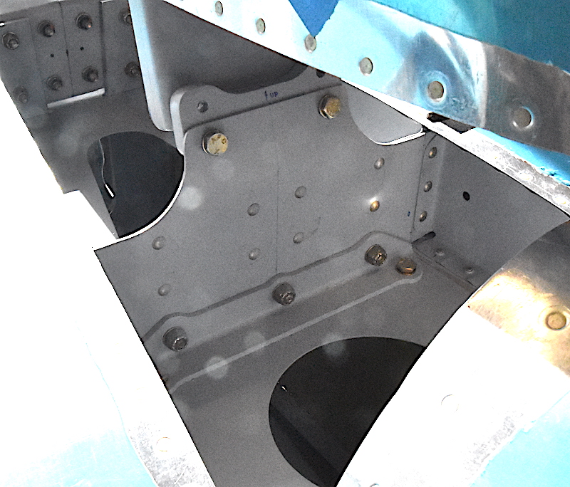

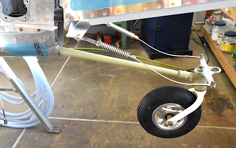

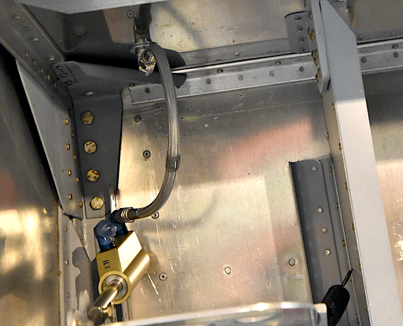

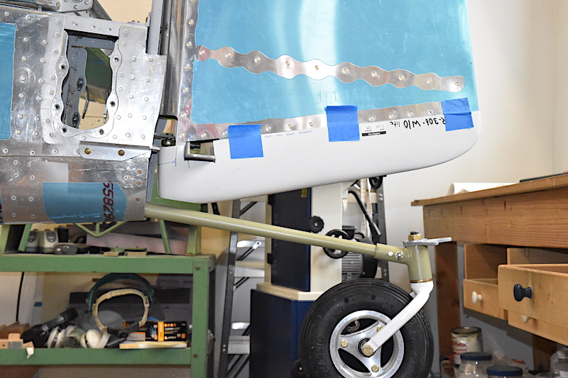

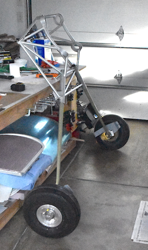

Here are a couple shots of the brake hoses trial-mounted. Thanks to Tom at TS Flightlines for the hoses and parts.
and

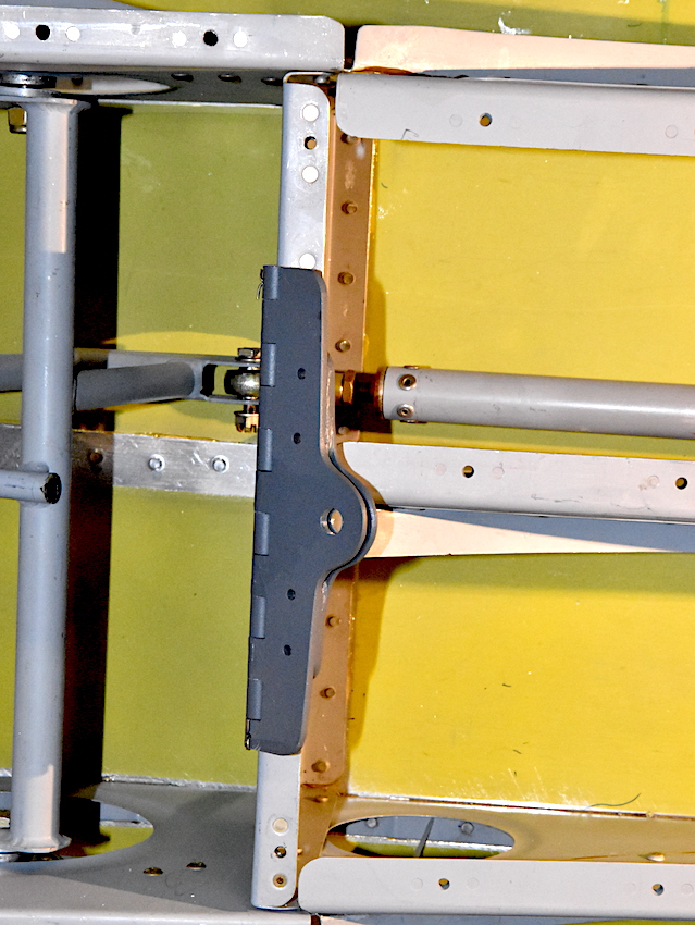

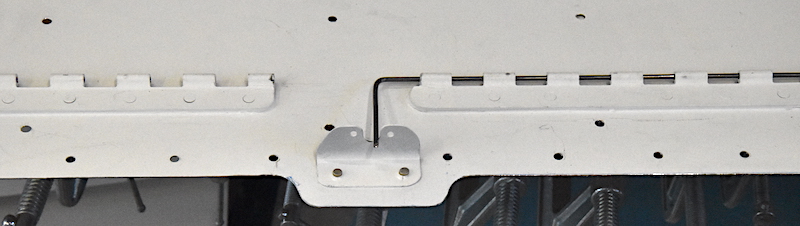

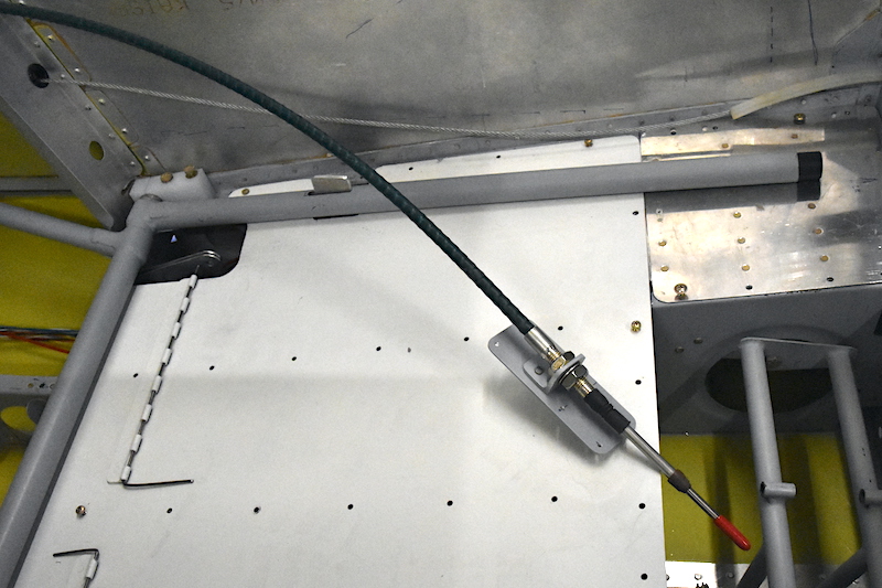

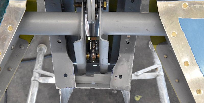

For some now-lost reason, I’d routed the manual trim cable below the rudder cable in the baggage and cockpit areas. Turns out that’s quite wrong. After adding a couple more holes in the bulkheads, I relocated it above. Here, you can see the old exit hole in the seat bulkhead below the rudder cable as well as the cable housing fitting. The stack-up of parts at the fitting means there’s only a tiny bit of cable housing adjustment available.
The exact positioning of the trim cable is still a bit TBD.
Remember that the short flap quadrant is only there to secure the internal assembly. That’s not the flight part.
Dave

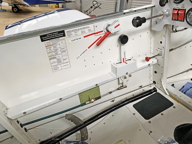

If you're still looking for photos of trim lever placement, here's mine. I didn't build this, but it's the best manual trim I've ever used.
Hi, Ed, thanks for the photo. The location of the trim lever seems to be very close to what I'll have, and that's a helpful bit of reassurance.
That latch is interesting. I suppose it's the canopy latch?
Dave
Dave
Happy to share! Yes, it's the canopy latch - another piece of simple clever design from the builder - very easy and solid to use. There's a matching exterior handle on the other side.

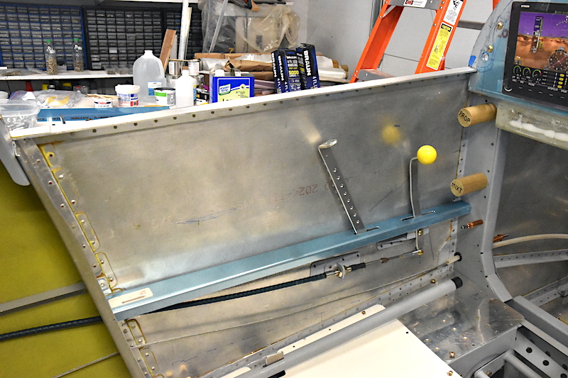

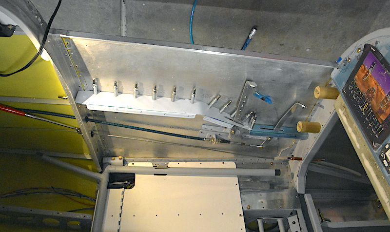

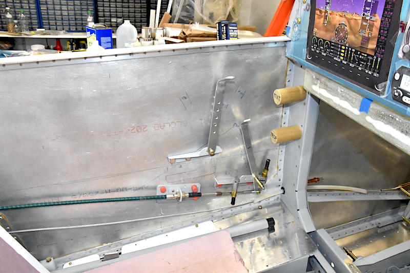

I’ve been trying to determine the positioning of the throttle, trim and mixture and prop controls. The main thing seems to be to put them where they don’t interfere with each other, have a clean run for the cables, and are more or less ergonomic. The most likely positions so far are shown here. Please disregard the sketch lines on the inside of the skin. They are handy to keep track of the various mounting points and will later go away.
So far none of these have mounting holes drilled for them. I’m using magnets. I won’t drill the holes until I’ve figured out what sort of side panel arrangement to have there.
Along with this, I developed the avionics shelf mounting. Besides the right location, it had to be removable. It is now, with four #8 screws holding it in place. Here’s the top of it showing the mounting points. It's also pretty near straight and level in pitch, roll and yaw.
The fuel valve is set up although it’s not installed yet. It screws to the spar bulkhead in the center, angled slightly to the left; the RV-3B has a center stick so it'll be my left hand on the valve. And yes, this small amount of offset is helpful.
This view shows it along with the throttle and trim controls. The wooden posts are mock-ups for the mixture and prop control. You can also see the switch panel portion of the avionics shelf below the panel and above my knees. There's more clearance there than it appears - that was a factor in its design.
Dave

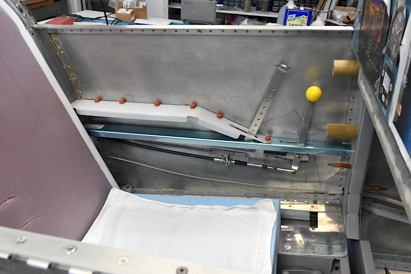

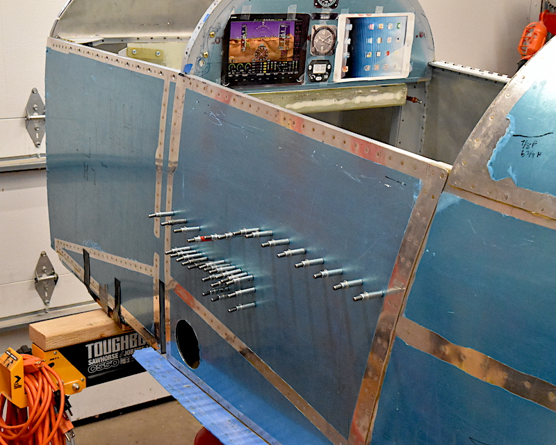

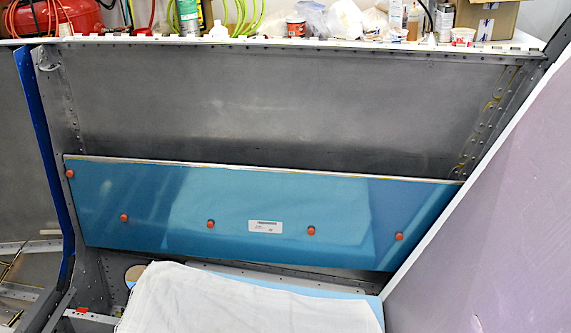

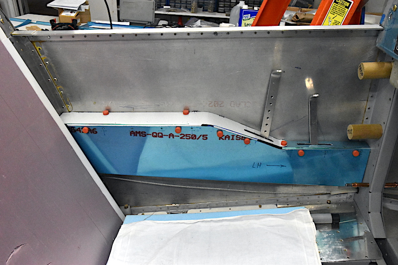

Time for the side panels. Looking through the various RV-3 cockpit photos I have, it looks like there are many ways to do this.
This is what the plans suggest. Here, the cover is not in place.
This has no storage and no armrest. There’s plenty of room for the controls including the flap handle.
I added an armrest. The orange dots are magnets. They’ve been invaluable with this, letting me move things around without drilling cleco holes.
Didn’t seem to be any reason to have both horizontal parts in there so after a bit of trimming….
Then I trimmed the cover and added it, too.
There’s room for a shallow, narrow recess in the armrest. Haven’t decided what it would be good for, though.
After drilling, I have a cleco farm.
I’m in the middle of dimpling, priming, adding the cover’s end angles, etc.
A neighbor has an RV-3. He dropped by to show his friend my project. She's trying out the Confor foam I got because I was tired of sitting on hard pink construction foam. There's still no lumbar support; the back cushion is still pink construction foam.
Dave

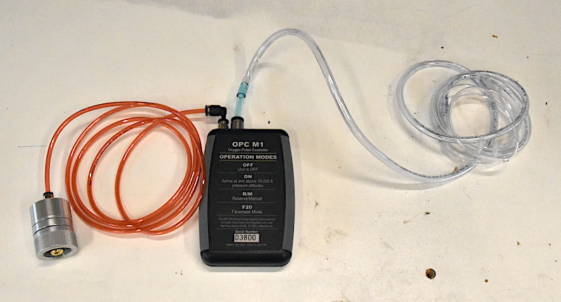

The right armrest has been interesting. It needs to hold the Mile High oxygen metering device and the headset jacks. And since I have an autopilot, it needs to actually be an armrest. Deciding where to put the headphone jacks is a good example of what needs to go where. A couple of pilots whose I respect advised me to put the jacks in the “fall line” of the cable from the headset. That would be at or near the aft end of the armrest, and that would preclude use of it when the AP is engaged. The headset I plan to use, a Lightspeed Zulu, has an external battery box (and no, I’m not going to use a Lemo jack to preserve compatibility with my other airplane). With some kluging, I was able to accommodate the cable and battery assembly. Then I realized that I have an inch or so between me and the right hand armrest. The upper cable and its battery box fits nicely there, and it’s a decent run to the very front of the armrest where the jacks will go. Problem solved.
The armrest will have a hinged lid. Haven’t gotten that far yet.
One frustrating thing with this armrest has been using the magnets to hold it all together while I fit things. If I don’t tape the magnets in place, they often jumped away somewhere. If I did tape them, they’d still jump away, after getting tangled in the tape. Some adult language has been said.

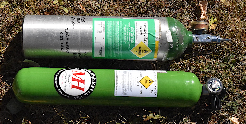

Back in 2016, after reading about military surplus single-person oxygen systems for sale in a VAF thread now lost to me, I was able to buy a PHODS on eBay. This is a Portable Helicopter Oxygen Delivery System. It’s complete with a tiny oxygen cylinder, cannula and a Mile High metering device. The device is a version of Mile High’s O2D1 device. Since the cylinder was way too small for my use and the cannula too military, I needed everything except the metering device itself.
Mile High sent me a new cannula, tubing, a few fittings, and an XCR-1P regulator, which will fit the CGA-540 valve on the cylinder. After a bit of consideration, I assembled it. This is a complete one-person oxygen system except for not having a cylinder. The cylinder I chose, their KF-011, has a fifteen year service life, so even though I’m not planning on keeping the plane, I thought I’d hold off on that for now. There’s a touch of denial in that decision since my own life probably won’t be much longer than that and certainly I won’t be flying then, regardless of keeping the RV-3B.
The metering device will go about a third of the way from the front. I need to build a cradle for it since the armrest cavity is too deep.
The rep at Mile High said that I’d be able to attach this to my present cylinder in my C180 and verify that it works.

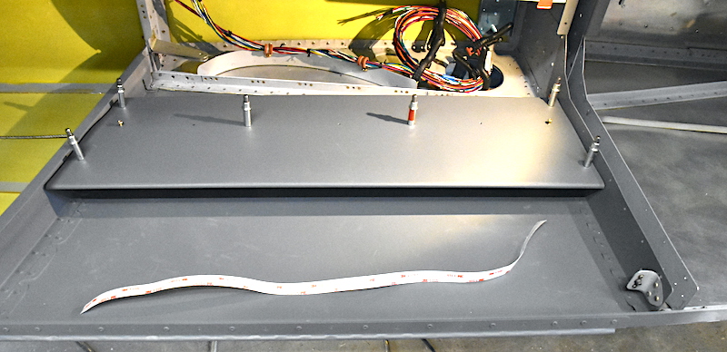

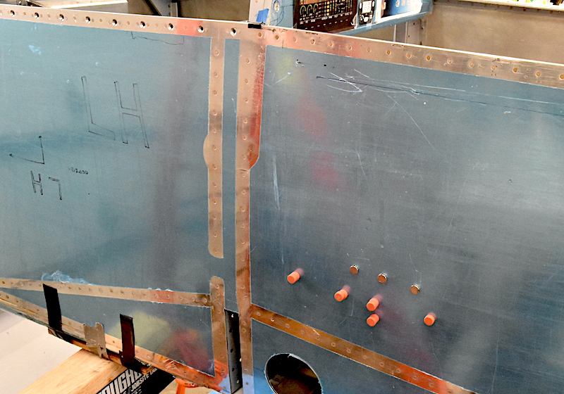

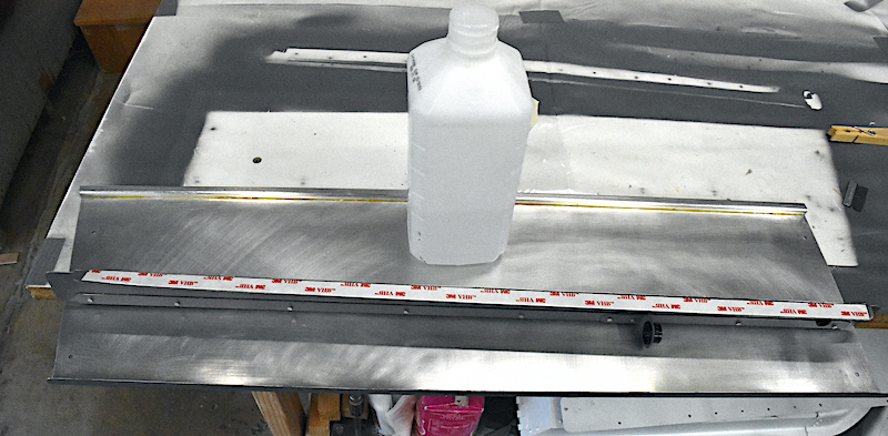

Been working on the right hand armrest. Lately most of the time has been spent making it gray. I remembered that my mentor used 3M’s VHB double-stick tape for some things and bought some.
The bottom shelf of the cavity needed to be attached. The options were glue, rivets, VHB or just leave the magnets on. I decided upon VHB. Here, the tape is on the shelf's outboard flange. The bottle of alcohol is just a handy weight.
I clecoed the cover to the shelf so that I could use the four tabs that were riveted to the bulkheads for alignment. The shelf is the narrow gray part on the unpainted cover above (since painted). Once the tape is on, it ain’t coming off. This photo shows the installation with the VHB’s cover removed.
Here’s the shelf mounted. No holes, no rivets, no mess.
The snap bushings hold that cable that's coiled up and feed it into the spar bulkhead to the right. There are still some additional wires to be added as I install things.
The main point with the VHB tape is that it’s like real estate. Location, location, location. Get it right. It holds quite well. Don't know that I'd use it for real structure, but it's fine for this sort of thing, and speeds the installation. I should have used it on the left side.
There are a number of VHB tape types and sizes available. I use 1/2” wide RP16.
The armrest is still just a cavity. Some more work is needed.

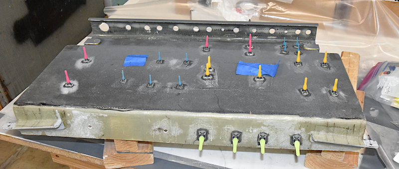

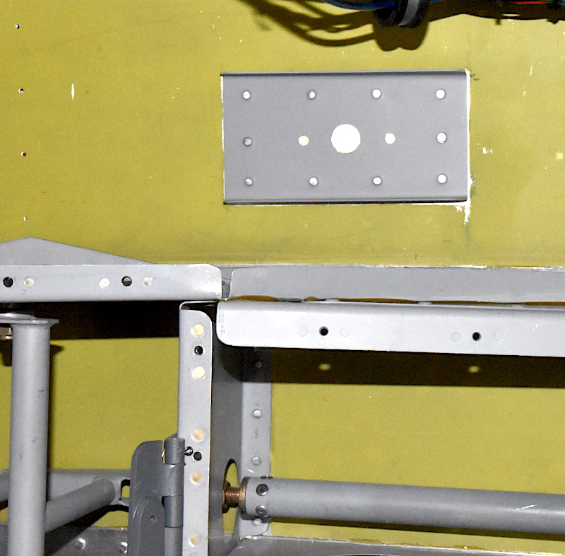

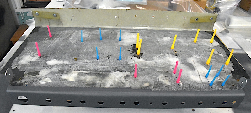

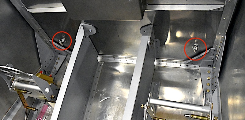

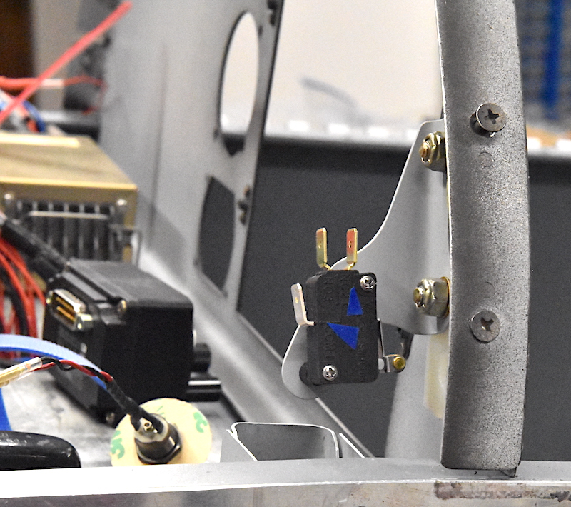

Kind of bouncing around the fuselage now. This is the avionics shelf and this afternoon’s job was to glue on the Click-Bond nutplates. Why this now? That bundle of cable in the previous post terminates on the avionics shelf.
The nutplates come with a silicone stem that’s used both for alignment and to tension the nutplate to the mounting surface. In this photo the colors are:
Yellow ones are 3/16
Pink for #8
Blue for #6
And Green for 1/4, not shown.
Pretty aren’t they?
Click-Bond sells several types of adhesive. Some versions come in inexpensive individual packets and some come in dispensers. Most builders, I think, use the packets - Spruce sells nutplate kits including them. I had some 2216 B/A and knew that would work, so I used some here. The main advantage of the Click-Bond nutplates, or course, is no riveting.
You may notice a couple of screws where there ought to be a silicone stem. In two instances, I pulled the stem too hard and it popped loose. The screw serves to locate the nutplate while the glue sets up.
I suspect that ordinary nutplates can use the stem for location and am saving them for that purpose.Don’t know how many times they may turn out to be reusable but I suppose I’ll find out.
The next photo shows the bottom of the avionics shelf with most of the 1/4” nutplates in. Green stems, as I mentioned.
Next, I installed the throttle and ran the push to talk wires through the belly. While I was at it, I pulled that coiled bundle through the snap bushings and up the side bulkhead.
I haven’t yet finalized the push to talk wire path on the left side of the cockpit, so that’s pending. The wire that runs past the cable bundle by itself is the rudder cable. The push to talk wiring includes one piece that goes to the microphone jack and another that goes to ground. Since the mic jack is above the shelf, or will be when I install it, the white wire aims at that. The black ground wire is in the inside of the spar bulkhead along with the rest of ‘em.

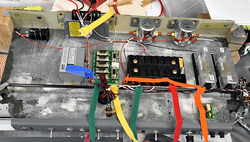

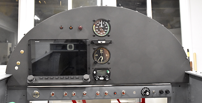

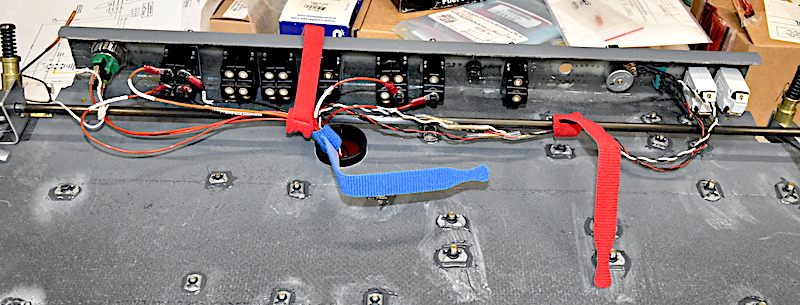

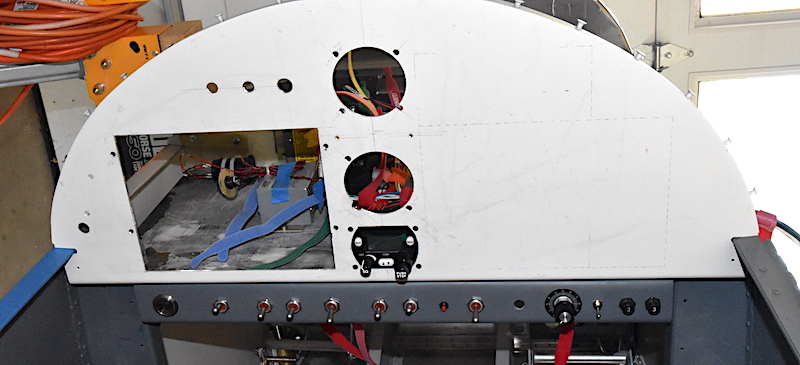

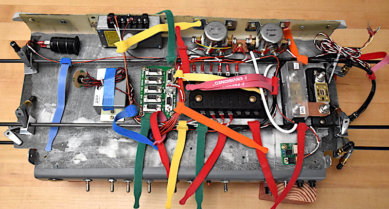

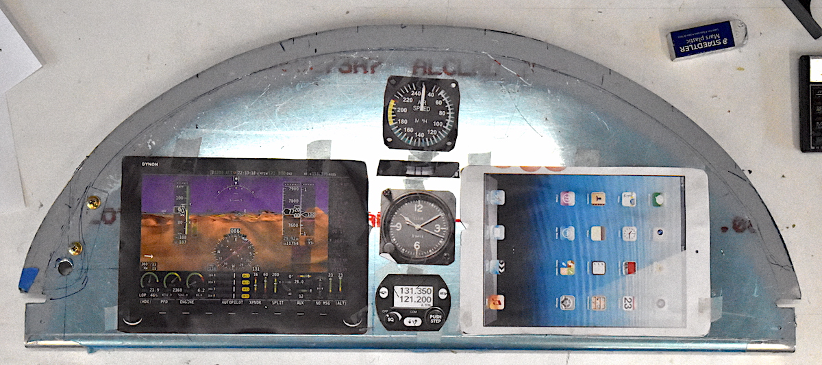

Here’s the final version of the avionics shelf layout. What I have is on it. I’m still missing the EFIS back-up battery, the EFIS itself and the com radio, everything is currently attached to the avionics shelf. Okay, the cabin heat cable is still missing. Lots of remaining opportunity to help keep the economy perking along. I’m not using the large costly heavy Dynon ADS-B In. Instead I’m using a PingBuddy that’s about the size of a postage stamp.
I’ve started wiring it up. I’m using Velcro ties to hold the bundles together as I build them, and carbon kite spars as a guide for positioning the bundles. Those add clutter to the photos but a substantial amount of organization to the project.
The space around the switches is limited. There’s plenty of room for terminals and wires but no room to get tools in. I’m building in service loops as I go, and it’s a bit more organized than is apparent. This picture shows a number of the Click Bond adhesive bonded nutplates - I like those.
At this time, much of the wire and fasteners are here. And I’ve making a list of more needed. I’m in the period where there have been multiple small orders per day. Knew I should have bought shipping company stock back when I started this project.

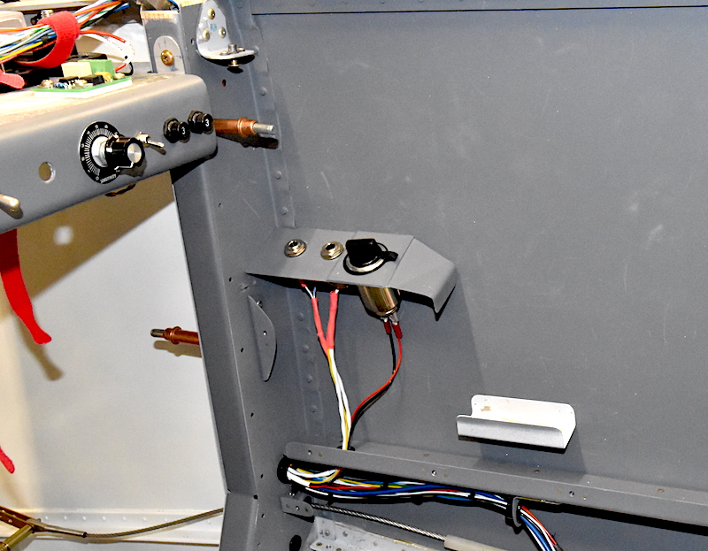

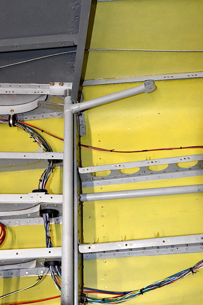

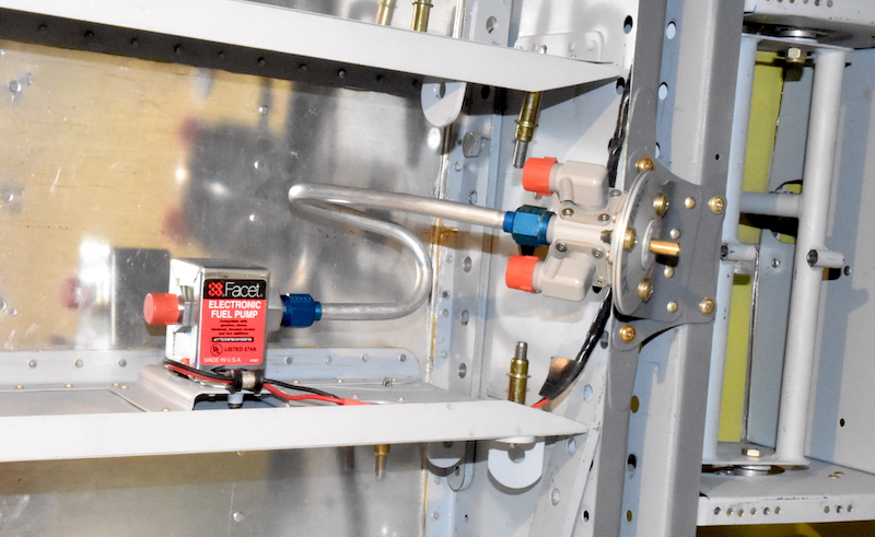

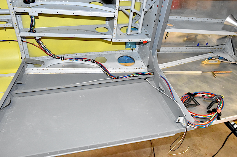

I’ve done a number of little things. Among them,
Wired the avionics shelf, except for the remote devices like autopilot servos and lights.
Hooked up the trim handle.
Installed the fuel pump, although still without the plumbing.
Installed the fuel valve.
Sort of off topic but it caused a week’s delay, put my Cessna 180 through its annual inspection.
Removed the primer and deburred and dimpled for the com antenna doubler.
Connected the push to talk switch wiring to the overall harness.
The PTT wiring from the throttle has a loop for flexibility, partly hidden below. If you look closely you can see the Dsub pins under some clear shrink tube that’s a service disconnect.

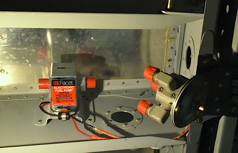

The fuel pump wiring, 18 ga, has a similar disconnect under the red shrink tube. In this case the pins are Molex.
The fuel pump’s wires are laced to clips that I glued under the spar bulkhead top flange. I need to add some chafe protection there.
For the fuel valve, I used fuel lube on the o-rings, applied sparingly with a toothpick. Instead of staking the screws, I used Permatex Threadlocker Blue.
