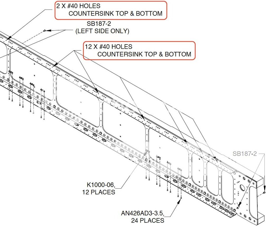

Want to confirm countersinking some spar flange holes
PAGE 13-03, FIGURE 2 DETAIL >>
The two leader notes point at 6 holes and 1 hole at the forward edge of the flange, and each note instructs to "countersink 12 x #40 holes 12 holes top and bottom, and "2 x #40 holes top and bottom".
Does this mean to countersink a grand total of 12- and 2- #40 holes in each top and bottom flange spar (the forward holes only as the leader note arrows indicates) ?
OR, to countersink a grand total of 24- and 4- holes in each spar being 12- and 2- holes in each of the top and bottom flanges (that being both the forward and aft #40 holes in both top and bottom flanges) ?
My guess is to just countersink the 6- and 1- forward holes in both the top and bottom flanges, but I want to be sure.
Your guess is right. CS the top 7 and bottom 7 for a total of 14. Another simple way to do it is to CS all #40 holes. If it is for a nutplate, CS for a rivet. If it is not for a nutplate, CS for a dimpled skin.
Helicooper>>
You are saying to CS ALL #40 holes? Including the aft flange edge #40 holes too for skin rivets? Is that in the plans anywhere?
I scratched my head at this step too. But if you read forward through the section, you will find that all the #40 holes have to be C/S. And that it is flush for the nut plate attachments and deeper to take a skin dimple on the other ones. Once you read the three pages you will see it's true. Get a marker and mark out what you would do and see if it isn't so. Red for flush, blue for deeper, or some such.
It's defined Page 13-03, step 7
I just saw it. Step 7 says to CS all the remaining #40 holes. So after CS'ing all the called-out nutplate holes, to then CS all remaining #40 holes would mean ALL #40 holes in the flanges get CS'ed. It takes a bit of study.

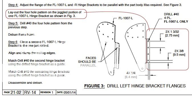

Indicated dimensions for drill holes?? 21-02, Step 4
'Control' >>
I'm glad you brought it up.
I can not decipher what these dimensions indicate for the four holes depicted on the joggled flange of the L-hinge bracket.
The two dimensions shown describe one hole to be drilled 3/8" from the bottom end and the two holes drilled 1 3/32" apart at the top end. The diagram indicates that four holes are approximately equal distance apart and the "2X" at the start of both don't make sense to me. There is no dimension shown for the space between the second from top and the third one and between the third and forth at the bottom. I generally take the "2X" to mean "2 holes" or "twice" the instruction. Here I am unsure what the dimensions should be.
I'm taking that to mean top and bottom holes 3/8 from the edge and the middle two holes 1 3/32 from the top and bottom holes' center.
Your interpretation is actually correct.
2X (or 3 or 4, etc.) is used often to reduce clutter in the plans.
In this case it means holes are located twice on the part depicted, using this measurement.
The only thing that would work for the 2X 3/8"is for it to be the two end holes (each 3/8" from the end). Then the 2X 1 3/32" is to measure from each end hole to locate the other two holes. The space between the two middle holes then ends up being what ever it is.
Thanks guys, now that makes perfect sense. i couldn't get the gist applied to dimensioning but now it's clear.

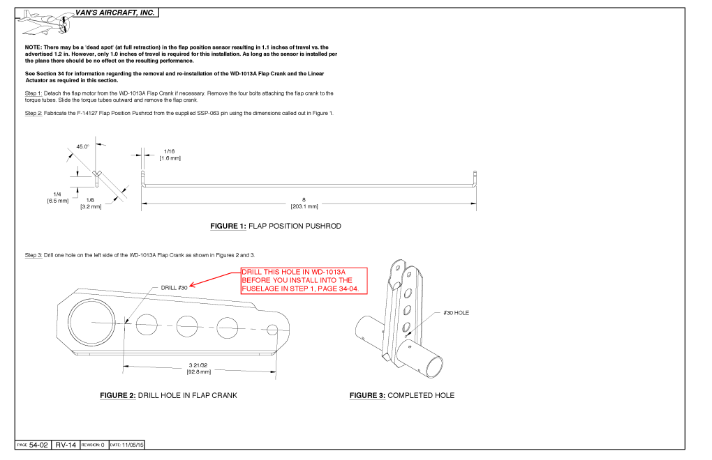

Page 38-28; Figure 3
>> steel tube work table to work on canopy >>
would like to fabricate one.
please post the size/dimensions of the table you guys used to work on the canopy, and if you found that it needed to be sized a little differently to work better > post those dims.

If you are going to install the Ray Allen Flap Position Sensor (Section 54) or even if you are not sure that you will, drill the hole in WD-1013A called out in 54-02, Step 3 while you are installing that crank in Section Page 34-04.
The amount of effort to drill that hole after the crank is installed is significant, or you can remove the crank, drill the hole and reinstall it. Even if you do not use that hole you are better off doing it at 34-04.
UPDATE 9/9/17:
I say again, SIGNIFICANT effort to remove the crank WD-1013A after it is installed. The note to refer to 34-04 for un-installing it is that you undo what it told you to do there. It is now a bit more difficult because there are a few more things in the way, etc. I originally did drill a hole in the crank with a right angle air drive drill - that wasn't significantly difficult, it was close to impossible! You have so little clearance that I had to cut off and shorten a drill at both ends so that there was enough untwisted shank to grip in the chuck and then re-point the dill bit cutting end. There was enough drill bit length then to get into the close quarters between the crank and the under-floor rib. You can't center punch the drill location; it's hard enough just to see it. I did my best to measure for the location of the hole and get it in the right place. But, the crank is powder coated which makes it 'slippery', it ended up walking a little and off by about 3/32". Plus it hard steel and I had to resharpen the bit twice.The whole process to drill that hole while the crank is in-place was VERY difficult. In all, it took about 3 hours+, and not in the right place.
Now I am removing the crank per the instructions and going through a whole new series of tight quarter body contortion and leg cramps. I feel that I need to get the hole in the right place and I have enough room to do that that is far enough from the first hole. And, I will have to reinstall the crank in those same close quarters.
The easiest thing to do if you have not installed the flap crank is to go ahead and drill that little hole that needs to be in there BEFORE you do install it. I hope that Van's revises the instructions to do just that, it will save much time and effort.
I did not use the thin/light-weight 1/16" rod for the sensor link/connection. I used RC model parts, two swivel ball joint ends, one jam nut, installed on a steel welding rod with 4/40 die cut threads held to the sensor on the crank with small RC hardware machine screws and nuts. I drilled a #44 hole.
I checked with Gus at Van's and he sent me Section 54, which is not on the Van's website. He said they installed the sensor after their RV-14 was flying. It looks like it is pretty doable in-place with a 90 degree drill. Probably an even hassle with removing 5 bolts/nuts and some safety wire to get at it now. Besides, I'm not certain I will install the sensor, since I can just look out the window at the flaps. Thanks for the warning, though.
The manifold pressure sensor on P. 43-03 calls out p/n 494-30004-02 which is a 50psi sensor but the Garmin std G3X-4CYL Lycoming kit comes with a 30psi sensor for manifold pressure (p/n 494-30004-01). According to Vans this is ok as you won't reach 30psi manifold pressure anyways but the discrepancy does exist in the plans vs what Garmin supplies.
Ok Jeffw, I drilled the hole in the flap bracket, and you were right. It was somewhat less of a PITA to just remove the 5 bolts holding the bracket to drill it than it would have been to drill it in place. I have a 90 degree drill and a very short bit, but it was still more than a little awkward to drill in place. Thanks for the warning. ;)

14 QB Wing J-Channel
For 14 QB Wing builders only. I tried to figure out how I was going to fabricate the J-Channel stiffener for the remaining bottom wing skin for the QB wing. Where I?m at in chapter 20 only has instructions on how to install it and makes no mention of how the J-Channel is fabricated. I looked back through the chapters and found how to fabricate it in chapter 13 which is listed as one of the chapters already completed on the QB wing.
In the RV-14 plans, the J-Channel is match drilled to the spar in chapter 13 for the proper location of the holes. However, on the QB wing, chapter 13 is completed (except fabricating the J-Channel) and the spar is already assembled in the wing so there is no access to it for match drilling the J-Channel.
I called Van?s builder assist to see what they recommended and Eric knew of this issue. He was building an RV-10 QB wing and he sent me the page from those plans (RV-10 Page 20-5) which details how to match drill the J-Channel to the wing skin for the QB wing. He also commented that he wished Van?s had included QB instructions in the plans for the 14 like they had for the 10.
After cutting the J-Channel to the length specified in the 14 plans, basically, the RV-10 plans have you draw a centerline 5/16 inch from the edge of the J-Channel flange and insert it in the ribs. Then cleco the bottom wing skin on and match drill each hole through the wing skin and the J-Channel. For each hole be careful to make sure the line on the J-Channel is centered in the wing skin hole before match drilling and insert a cleco in each hole as they are drilled. Of course after doing this for both wings, take the skins off, J-Channels out and deburr all the holes.
