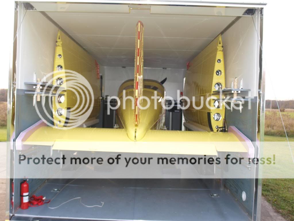

Here is the link to detailed pictures of my trailer design and loading procedure. I hope this gives you builders some ideas. My wife, Jane and I can load or unload the plane and ready to fly in less than 20 minutes. To date we have driven over 4,000 miles with this system - without a scratch on the plane! Having a portable hangar opens up a world of possibilities.

BASIC TRAILER REQUIRMENTS
The first thing you will need to do is select a trailer which has a rear door opening, 7 feet tall and 98 inches wide. You will probably have to special order it. We chose a 24 foot Pace America trailer. Your trailer will need to be ordered with tie down rings pre-placed and extra strengthening in the front to accommodate a winch. Also, you will need to find someone willing to cut your wheel wells and make them removable. This will accommodate for the wide wheel stance of the RV-12. We used welded nut plates to refasten the wheel wells during travel.
SUPPORT WHILE TRAVELING
We support our RV-12 fuselage in the following ways: The nose wheel is elevated on a ramp and captured in a slot, keeping the nose wheel from castering and the plane in a nose high attitude. This places more of the weight on the main landing gear and less on the nose gear. The plane is ratcheted down moderately by using a front tire tie down; main wheels are chocked and secured with tire nets. The tail section is secured using the rear tie down and a rubber block fastened to a two by four that is secured to the trailer walls. This allows for a mild for and aft pivoting action dampened by rubber on each end to reduce fuselage longitudinal stress. I do not believe any part should be rigidly fastened. The tail and stabilator are then supported and cushioned by use of a second two by four to create a shelf that holds two cushions fashioned out of pillow back support wedges from a pharmacy. We have noted no damage whatsoever in over 4000 miles of hauling with this method.
THE LOADING PROCEDURE
The plane is positioned near the lowered trailer door. Gust locks are installed on the flapperons and foam protectors are put in place on the stabilator. The rudder is then secured in the cockpit with a short spring loaded curtain rod. A guiding strap is then clipped to the rear tiedown ring.
The wings are then removed and loaded into the trailer. The wings rest on shelves, cushioned with 4" of foam covered with a soft cloth. The left wing shelf has a notch cut out of the foam to allow plenty of room for the stall warning vane. The wings are then attached to the wall. The spars are pinned between two short shelves using two wooden dowels and the wing tips are secured using cushioned PVC pipe fittings and snap rings.
For the fuselage we fashioned a ramp out of a 4 X6 with quarter round on the edges to help guild the nose wheel. At the top of the ramp, boards lined with Teflon cutting boards form a trap to keep the wheel from castoring. We also used a strap winch to help keep the plane tracking straight. As the main wheels get past the trailer door cables a board is then used to spread the door cables, adding additional clearance for the tail section.
The fuselage is carefully guided into the trailer. I control the winch with the string control in one hand and help guide the fuselage with the guide strap in the other. My wife uses a tow bar on the nose wheel to help keep us on a steady course.
Once the fuselage is load we secure it, stow our gear and go.

At this link you can see pictures of the 12 loaded into the trailer, note the rear picture of the foam around the horizontal stab:
http://s1286.photobucket.com/user/hemlockfield/library/?sort=6&page=1
96" verses 98"
Our trailer is a Pace America Shadow GT and it is sold with a standard rear door opening of 96". We custom ordered ours with a 98" opening. The foam around the horizontal stabilator is for protection only, during loading and unloading. It does not touch the walls.
