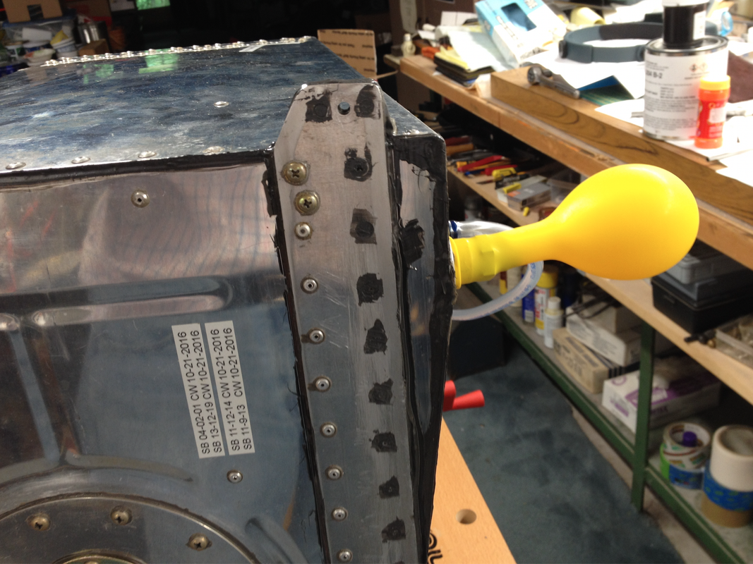

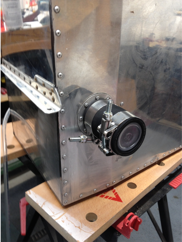

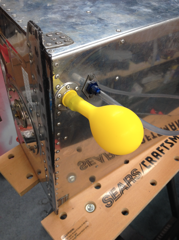

Very true, and law of averages would say, leak is on hidden side of tank. So, if you have fuel odor you need to remove the tank to fully investigate where leak is. Do very thorough repair and leak test with 1psig and soapy water. Should be hunky-dory going forward.
