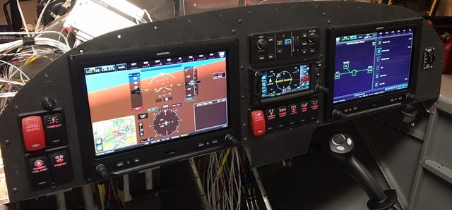

Sorry for the image size; it’s quite a silly dance you have to go through to post a photo on this forum. My one request would be to allow just posting photos here.
Soap box statements aside, here’s my panel from a while back.
Yes, I do have a G3X. Note the GTN625 in the panel center.
Thanks. I chose to use a single piece and cut it out myself, but retained all of the factory mounting holes and braces. It is admittedly a little overkill for an RV-12, but I thought, "why not?".

Thanks for the info! Any chance you could post a picture of how you set up your panel with the GTN and G5? The older -12 seems to be a little more tight- I like what they?ve done with the console in the -12iS.
That looks awesome- and I second your IFR discussion in the post. The gentlemanly IFR capability can be well worth it.

Panel is nothing short of awesome.
That withstanding, what is your backup for the primary flight instruments? Dual AHARS?
Thanks. The MFD is redundant to the PFD, but yes, I also have a second GSU 25. Noting how CAN bus works, both ADHRS units are available to either PFD/MFD.
Keep in mind, I still only have one pitot tube and one magnetometer (and one engine and one pilot... :rolleyes:)
You can go crazy with redundancy, but at some point you need to balance that against weight and reality. Reality is that my iPhone getting signal from my GDL39R has sufficient AHRS data to find a VFR route to land if really needed. That and if it's nighttime here over the Sierra mountains in a rainstorm with IMC up to 18,000', I'll either go find a nice place to relax, or take my Baron.
