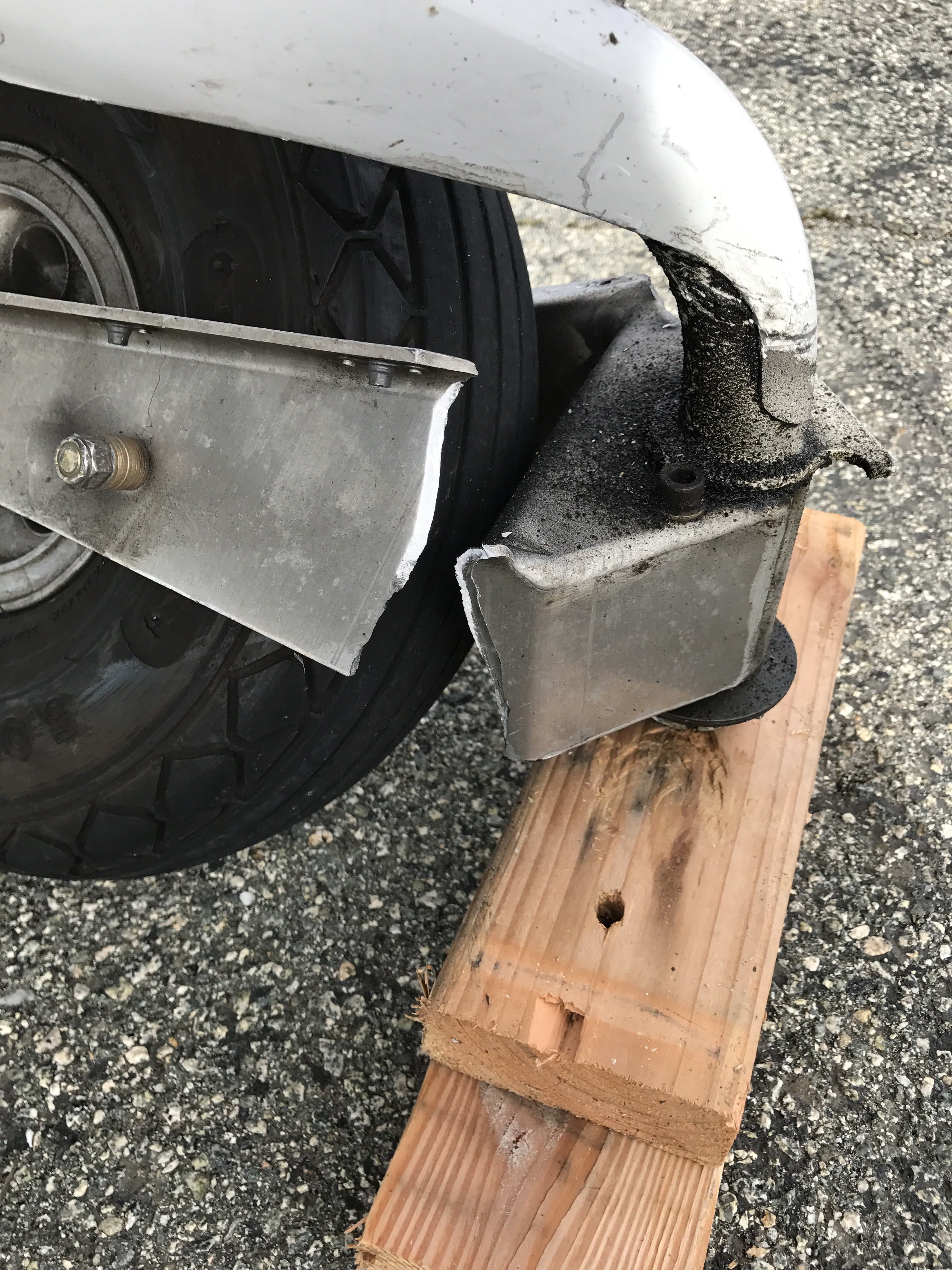

Here's a picture of a failure
This one happened with about 700 hours (on the second fork - first one cracked too). I know the pilots and they are careful - though there will always be the occasional less than perfect landing. Our runway is a bit of a washboard too - it is finally getting fully repaved in October. The triggering action for this break was a slow taxi sharp turn. That was it. I was a pax in the plane at the time.
After this break they put on the beefed-up fork with no further problems.
This fork was inspected (but not with dye penetrant) just days before the failure. Warning: I made the picture HUGE so you could get a good look at the failuer point. There was a similar crack starting at the bottom left weld as well and it was very hard to detect.

- I agree that it's unreasonable to expect "all my landings are greasers". Thanks for posting photos of your cracks. I haven't flown mine yet, but based on this, I'm going to plan to swap out the fork at my first annual. I agree with others that the cost of ~$350 for both the fork and pant hardware is a good insurance policy.

fracture surface
Has any one examined the fracture surfaces? Is there fatigue or is it all static overload? In post 48, I suspect that the strut failure is after the fact. In post 78, I see 45 degree shear lips and possibly some striations, but the photos are not sufficent. 45 degree shear lips are consistent with static overload and striations, if present, would be consistent with fatigue.
If there is no fatigue, then we are likely looking at static overload. The part may have failed under a single load.
If there is fatigue, there was an initiating event and the crack continued to grow. The question is how fast would it grow and how often would you need to inspect once the crack started. If this is a fatigue issue, you may be missing a very small crack that at some point grows very rapidly, under small loads.
In post 78, the crack at the tow bar bolt puzzles me. Why would uploading on the wheel introduce a crack above the tow bar bolt?
Does anyone have good photos of the fracture surfaces? Has anyone opened up the fractures?
