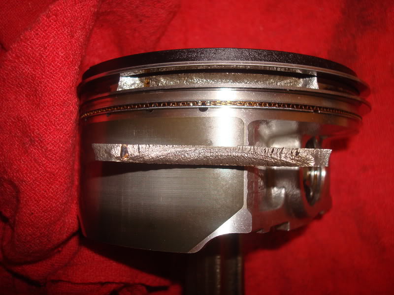

detonation typically takes a while to progress to serious damage
That might be true for a Lycoming, is it also true of a Rotax?
One of the documents I have read on detonation says
"An engine that is making 0.5 HP/in3 or less can sustain moderate levels of detonation without any damage; but an engine that is making 1.5 HP/in3, if it detonates, it will probably be damaged fairly quickly, here I mean within minutes."
A Lycoming is about 0.5 HP/in3, a Rotax is 1.2 I think.
Looks like pre-ignition damage, not detonation. I'd also be interested in seeing the other spark plug electrode.

Preignition however will destroy a Rotax a Lycoming or a Stihl chainsaw. The most common cause is from a cracked ceramic, probably around 90+% with a few %, say 5% from cross firing mags/harness. maybe 1% from helical tangs.
DanH is onto it with a plug failure, being the ceramic as the most likely almost for certain cause., perhaps a poor fit and this not heatsinking.
The fuel was stated as being 91ULP, is that MON, RON, (R+M)/2 ? I am assuming this is the (R+M)/2 or AKI number, which is around 95 RON or 85MON (avgas language)
The likelihood of detonation causing a ceramic failure is low, but a dropped spark plug is very high indeed.
You said you thought it was piston meltdown, but could it be debris inside the cylinder? Just thinking out of the box.
Don't think so John. The debris was an intermediate result of the root cause. The top edge of the piston is clearly melted on the surface. DanH has been asking for a week about the top plug for a reason. Ross has lots of experience with small bore, high power engines. While still no clear root cause it is in the preignition/detonation mix. Could be as simple as a broken electrode insulator.

As someone who's built over 150 turbocharged engines, driven, raced and flown them for the last 40 years and done thousands of dyno pulls, here is what I have observed:
Detonation almost always breaks the 2nd ring land first, 3rd ring land next, almost always with no major crown damage and usually leaving the plug ground electrode intact. The ceramic on the plug may be cracked in some cases. Depending on severity and piston design and material, this damage can take place in 1 second to many hours.
Pre-ignition will melt the piston crown in as little as 5 to 15 seconds and no piston can withstand continuous pre-ignition for even 1 minute, no matter how strong, what coatings are applied etc. Pre-ignition, again depending on severity and duration, most often removes the ground electrode closest to where the event is occurring also.
The higher the specific output, the higher the heat flux on the piston crown. As pointed out, the Rotax has much higher specific output than a Lycoming. This in itself is not a problem on a well designed engine but can be expected to shorten the time it takes for pre-ignition to take out a piston.
Pre-ignition is most likely to occur with high IATs and head/ chamber temps and as Dan pointed out, plug heat range and/or heat transfer through the plug can also initiate it.
Three different piston failure modes.
Here is what a typical detonation failure looks like on a cast piston.
Note broken ring lands but totally intact crown.
Below. Detonation induced pre-ignition failure on a forged piston with central plug location. Ring lands on the forged piston were able to take the detonation without breaking but it was no match for the pre-ignition that followed. Spark plug ground electrode melted off.
Below, 2 bottom photos. Crown and land distortion below caused by excessive heat flux for the piston design. Aluminum gets to plastic state and combustion pressure reshapes the piston which then loses gas seal, hot gas flow past the piston then quickly melts the aluminum.
These would all give you a bad day but detonation failures typically are more benign and besides a big loss of compression and tons of blowby, the engine continues to run in some fashion. Not so much on the others.

The piston damage looks like detonation damage on the top (coolant outlet, presumably hotter) side, and debris damage on the bottom.

IMO this failure is not due to detonation as I outlined in a previous post. There is a big difference in failure modes and length of time to failure between detonation and pre-ignition. They are not the same at all.
I'm not convinced anything would get hot enough at idle to induce pre-ignition when takeoff power was applied. Whereas engines definitely can get hot enough at idle power to detonate at higher power.

My best guess, if you don't find an obvious cause, is it was overheating based on the time waiting on the ground which lead to detonation.
Takeoff RPM may have been a contributing factor by reducing the detonation margin.

Vic
My experience is working with turbo engines on a almost daily basis for about 40 years now where detonation in some form is a common occurrence. Broken many ring lands in my time on cast pistons from detonation. The failures never looked like the Rotax piston here.
Pre-ignition experience was confined to race engines where there were wastegate failures, high IATs, high coolant temps, too hot heat range plugs or dumb guys trying drive engines through a lean miss condition.
Seen a number of pre-ignition failures where the side of the piston was blowtorched straight through with big spherical blobs of aluminum in the oil pan- certainly not from detonation.
I would have thought wastegate failures, high IATs, high coolant temps or dumb guys trying drive engines through a lean miss condition were detonation triggers not pre-ignition. (Or detonation induced pre-ignition.) Too hot heat range plugs would be a more classic pre-ignition trigger?
I acknowledge you have infinitely more experience with this stuff than I do. However, my job and my nature is to question (and in the process learn from!) experts.
I am interested in any comments you have on the article I linked to.
Andrew, IMO, that article is actually quite good. It is very broad and while factual, would not be a good guide due to he number of other indicators leading to a root cause diagnosis of a particular failure mode.
The pre-ignition section actually gives a good description. Note it always mentions melting of the piston, and the picture of this Rotax clearly shows the melted top land.
Hot aluminum is weak, pressures are high with PI and could either allow the top land to collapse or to stick to the wall and get pulled off. That leaves the rings unsupported and the failure progresses. FOD everywhere.
The reason I was looking at this as a sign of detonation was this section:
Some engines ... have a very common detonation failure mode. What typically happens is that when detonation occurs the piston expands excessively, scuffs in the bore ... and wipes material into the ring grooves. The rings seize so that they can't conform to the cylinder walls. Engine compression is lost and the engine either stops running, or you start getting blow-by past the rings. That torches out an area. Then the engine quits.
In the shop someone looks at the melted result and says, "pre-ignition damage". No, it's detonation damage. Detonation caused the piston to scuff and this snowballed into loss of compression and hot gas escaping by the rings that caused the melting. Once again, detonation is a source of confusion and it is very difficult, sometimes, to pin down what happened, but in terms of damage caused by detonation, this is another typical sign.
The description of pre-ignition suggests the heat is felt through the whole combustion chamber, and the areas that melt are the areas least able to absorb the heat e.g. the centre of the piston. I don't see how pre-ignition melting would be confined to such a localized spot.
On the other hand, if the melting is due to hot gases blowing past a section where the rings lost their seal, that is more like what I would expect.
But pre-ignition or detonation is a bit of an academic distinction at this point (albeit interesting!).
The 1st ring land is sometimes described as part of the crown. This is the portion above the top ring. I've never seen this break from detonation. The 2nd and 3rd commonly break from detonation as below:
There is usually no further damage to the crown from this failure because parts can't migrate upwards into the chamber.
From my experience, this is totally incorrect. You can see that detonation from the 2 latest photos I posted, simply snapped the ring lands with no other skirt or heat damage anywhere.
I've driven engines for hours after the rings lands broke from detonation. You just have to add lots of oil as it's woofing out the breathers. Never had one stop running yet and I've broken my fair share.
How long was that engine detonating at WOT? This engine might have been 1-2 minutes in detonation at WOT.
The first set of 4 photos I posted, photo 1, the engine detonated moderately to heavily for about 1 second, 5 or 6 times over a couple days. I got out of the throttle/ boost immediately each time. Then this happened the 7th or so time. Immediately down on 3.5 of 4 cylinders. Looked at the breathers and knew the rings lands were broken.
Several nearly identical incidents driving turbo street cars.
I lightly detonated this same engine dozens of times over the next 15+ years and never broke any pistons.
On another turbo engine, the water injection tank ran dry at full boost. Instant, severe detonation broke ring lands on all 4 pistons and the head gasket in less than 1 second.

Did I read that there was an ignition failure on one plug? if not, skip the rest of this but here is a theory from a HS grad with no formal training, so here is my uneducated guess, So everything is hot and ready for a detonation event, if one plug fires and as the flame front travels across the CC from the one good plug but with the flame front propagation not completely consuming all the gasses and then you have the (end) gasses spontaneously ignite and detonate with abnormal combustion that blows away the piston boundary layer you have heat transfer to the piston top that is no longer protected by the boundary layer and now exposed to that 1800 degree flame, then the explosive force and pressure of detonation to break stuff and blow holes through weakened soft hot aluminum? all happening within seconds depending on piston thermal inertia rejection capabilities. And this also might snowball by the head boundary layer absent and superheating the coolant in the head and vaporizing it making the coolant ineffective. May be jiberish, just kick me out of the sand box if I'm off base here :D
The ignition check failed after the engine melted down. Perhaps one of the #4 plugs was taken out - I'll check. Once I found the #2 melted I stopped looking at the ignition. I can't reason a dead cylinder causing a difference in RPM during an ignition check (500 RPM).
A melted ground electrode is usually a sure sign of pre-ignition which follows with the type of piston damage in the photos too. In all my years detonating turbo engines, never saw it melt off a ground electrode.
Detonation results in pressure spikes many times what you would get during normal combustion but it is of extremely short duration so it does not transfer much heat to anything which is why you see pressure damage but no heat damage.
Detonation also always occurs ATDC where cylinder volume is increasing and crank angle is more optimal where pre-ignition is of long duration (normal combustion started before spark initiation) and always occurs BTDC so pre-ignition adds a ton of heat while effective cylinder volume is decreasing, adding even more heat.
That is very different to detonation sustained for a minute or 2 at maximum power. There is detonation that breaks things within seconds. There is detonation that can continue for a long time without damage. Presumably, somewhere in the middle is detonation that does damage over 1-2 minutes. What does that damage look like?
Everything I have seen on detonation says it can shock the boundary layer that protects the piston and head from the heat of combustion, with the result that they overheat. That is not consistent with "no heat damage".
Another thing that destroys the protective boundary layer is hot gas escaping through a small gap. So if you damage the ring seal and the blow by is severe enough i.e. you maintain high power, the combustion gases act like a blow torch on that area of metal.
Detonation is short enough that cylinder volume change and crank angle are irrelevant.
Your point about pre-ignition is important though, it occurs before normal ignition so you have a cylinder full of unburnt mixture. The heat and pressure are applied to the whole combustion chamber so you would expect to see generalized heat damage - not just one area. With pre-ignition I would expect to see some evidence of melting on e.g. other areas of the piston. I do not understand how pre-ignition damage would be so localized.
Detonation on the other hand is likely to happen in the areas furthest from the plug and last to burn. The damage could quite reasonably be localized to those areas, and that is what I see here.
Your last part is where I agree with you, in post 88 I was thinking the same thing, one plug not firing, end gasses detonating opposite the firing plug. detonation can happen after one plug firing. Think of speed of flame front verses detonation, turtle is the flame front starting the burn at one end and then the rabbit blows the rest up at the other end.
