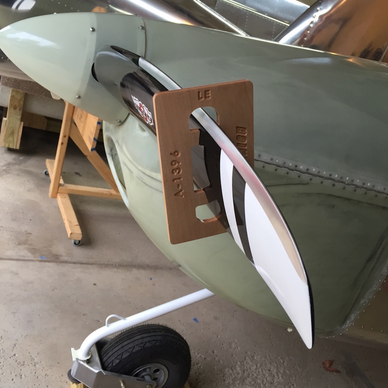

prop pitch measurement tool from Sensenich
I found an interesting wooden tool with my prop that appears to be custom made by them for the setting of prop pitch using a digital level. Did these get added to the kits recently? (Mine arrived last December.) I zeroed a digital level relative to the canopy rail (thanks, Scott!) and then measured the angle of the top of the wooden tool. Thanks to the previous poster who also mentioned that you have to measure the ascending prop blade, and don't assume that the ascending blade angle is the negative of the descending angle.
I have not yet reached the point of doing full power runups, although I have run the engine at idle.
Has anyone else used this with good results?
That's what I used to set mine and it worked out OK although you have to be a bit careful to ensure the tool is placed on the blade(s) the same each time. If it gets canted side to side it'll affect the reading . It does a great job of conforming to the blade shape but before I use it again I'm going to figure out a way to mount a cross piece that'll lay on the blade edge to ensure the same orientation each time.
I zeroed the level on the rail as well. No biggie, but since we're not trying to achieve a specific reading but just ensuring both blades are the same, I don't think it matters what we zero to, just that it not change while we're doing our adjustment.
Also, I'm not sure why the measurement needs to be taken on the ascending blade. I found it more convenient to do it on the descending blade because the put the relatively flat trailing edge on top so I could use it with a level to position each blade in the same horizontal position before I took my reading.
You are correct Tom, but the benefit to zeroing is you can record the resultant angle in the log book. Then later if you remove the prop for some reason (Sensenich specifies that the blades be removed for condition inspection....) it would be easy to reset to the original value without the need to have the airplane sitting in the same spot as before, or have any influence by tire air pressure etc., because it is a fixed reference.
Correct again. It can be done on either side. The main requirement is that both blades be in the exact same rotational position when the measurement is taken. Most people tend to use the descending blade position if they have made their own tool because it is easy to make it hang on the trailing edge repeatably.
Good point, makes sense ...
Has anyone checked to see if the wooden gadget can be ordered from Sensenich? My home brew jig with the level strapped to it works pretty well, but this appliance might have the potential to make pitch setting even more accurate and repeatable.
I personally think the home made tools are better because you can make it so the digital level or protractor attaches to the tool.
With the Sensenich tool you have to hold the level up against it (one more error variable also).
I think a pre-made tool might be available from Van's in the future, but I am not sure when. Keep a watch out for an announcement.
