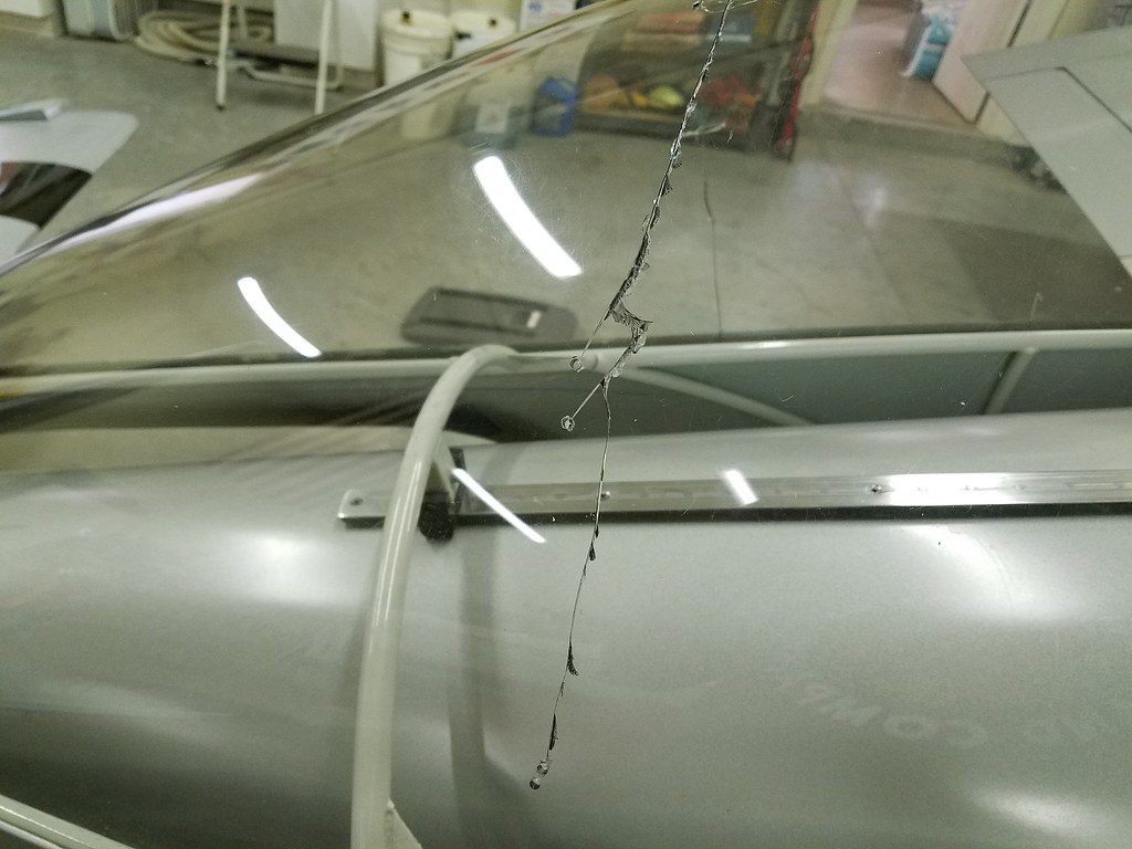

Has anyone with the fastback mod had a cracked canopy? This mod would have a shorter canopy and get rid of the point where most cracks seem to occur.
I re-read this thread, and have some thoughts.
It seems we've been discussing stress concentration factors, which are typically used when, for example, one places a strip of material containing holes under tension. The stress is "concentrated" around the edges of the holes in the manner depicted here:

However, this does not fit our situation entirely. The above depiction assumes the tension is not being applied directly on the edges of the hole. In the case of canopies attached entirely or partially by rivets, once the acrylic has contracted enough to contact the rivets at the extreme ends, the force is applied at the hole. We now have a local contact stress which may be extremely high.
Bill's interesting test of attaching a strip of acrylic to a steel angle might have a different outcome if the strip were wider, yet still attached in the same way. The resulting force on the fastener will be proportional to how wide the strip is. Our canopies are really wide, as analogized to this strip test.
I guess for me, what remains a mystery, is why they don't all crack... When I take mine from a 45F hangar out into 0F or so weather, the clicking it makes is horrifying, once the engine is running and the rapid cooling begins. The clicking is presumably the acrylic shifting relative to the frame, as the mounting scheme was designed to allow. If it stops clicking I need to worry.
It has been doing this every winter for 1600 hours/16 years, and hopefully it will continue to behave. The -8 is obviously worse case, given its length and the apparent mis-match to the curvature near the aft end.
My 6A canopy also had a serious mismatch to the frame at the rear, like .625 inches at the middle support. I just put plastic standoffs there and longer bolts thinking it would be a bad idea to cinch it down to the frame.
The "clicking" sound worries you initially but 15 years later with thousands of heating/ cooling cycles, mine is still crack free, rivets, bolts and all.

Interesting... I have never heard my canopy click in frigid temperatures..I am assuming that is because the hangar is unheated, so things happen at a much slower rate. (or I'm not in the hangar when it's adjusting)
If we look at the current number of flying RV 8s at 1450 and assume 33% are enduring cold winters (I just yanked that number out of nowhere) so about 500. Lets yank another wild number out of the air and say that we have 20 or so cracked canopies (based on the 7 or so reported on this thread).... that gives us 4% failure rate. Not bad. (AND THIS IS ALL PURE CONJECTURE HERE)
If it really was due to thermal / attachment stresses I'm thinking there would be a lot more failures. Like other posters have said, its probably an accumulation of factors... flight loads... RATE of thermal changes, How well the canopy fit in the first place... Hole treatment on install.. etc etc.
I think if we install with care, the odds are with most of us that we wont experience the unhappy event.

Thermal expansion is in all directions and not just linear. The holes do get larger but not enough to account for the lack(in comparison to plastic) of expansion of the aluminum. The canopy would not have stress from simply getting warm and expanding but when it pushes, in a point fashion, against the fastener.
It seems that the canopy needs to float within the mounting system. Maybe using small slots instead of holes. Just commenting from a mechanical point of view and not from an experienced builder.
So, how do planes like the P-51 manage the big bubble? Do they float in the frame? I can?t find details on how they are put together. One photo of a NOS canopy shows holes in the front bow area, but I don?t see any along the lower sides.
The P-51 - first thing is, it's a 400+Knot airplane and has mush thicker plexiglass, and it might have a different composition for protection. I imagine it's not a 'blown' canopy. It's probably formed in a mold, which ensures a fairly uniform thickness throughout. This also ensures an accurate fit to its canopy frame. I think our problem with RV canopies, particularly RV8 canopies, is twofold. We have a method of attachment that is not ideal. Pulled rivets on plexiglass doesn't allow tempering the stress on the fastener. Secondly, the blown plexiglass canopy is almost never ideal in size and shape, relative to the engineered frame it sits on. There is almost always some stress during attachment to the steel frame, even if you are using sikaflex. This stress seems to be usually concentrated at the rear of the frame on the RV8. Starting the assembly at the rear v.s. the front may eliminate some of this stress. But stresses still exist in this type of assembly. Oversizing the holes will take care of some of this. Using screws that you can gently apply clamping pressure will help too. But the bottom line is, unless you have a plexiglass canopy that is fairly precisely formed in a mold to a frame, steel or otherwise, there's no way can can eliminate stress points, and possible failure due to varying homebuilt construction techniques with this type of structure.
If we were all willing to spend an extra $3K on our engineered canopy, we may have more favorable results. But given that the failure rate is 4%(numbers are suspect....) we are doing pretty good with an affordable canopy on our RV's.
The 2 person sailplanes I maintain have huge canopy's on them and they are all rigidly glued to the composite frame with epoxy glue, just like the beautiful fastback kit being produced by Showplanes. I contacted Showplanes to inquire about cracking and this was their response; "There has been over a 100 sold and shipped to all parts of the world. I have not had any customer report back with an issue of cracking from cold or hot temps. " If you study the pictures from their website, you will see that they drill the RV8 canopy for clamping clecos and it looks like larger holes between the clecos to act as epoxy pins when it squeezes out.
Dan mentioned earlier that the epoxy/glass (not carbon) frame has a closer thermal expansion rate to acrylic than the steel frame. Maybe there is something to this??
