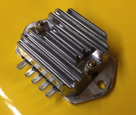

I just finished installing my Amazon knock off regulator and it is working fine. I made a mounting plate from 3/16 aluminum. I took the Ducati and traced it's footprint on to the aluminum, cut it out and match drilled mounting holes for the old one, then a pair of holes for the new one and it bolts right in. I found a piggy back 1/4" push connector and even used all of the wires. It is charging at full rpm approx. 14.6 volts. Best of all? $30 with shipping!

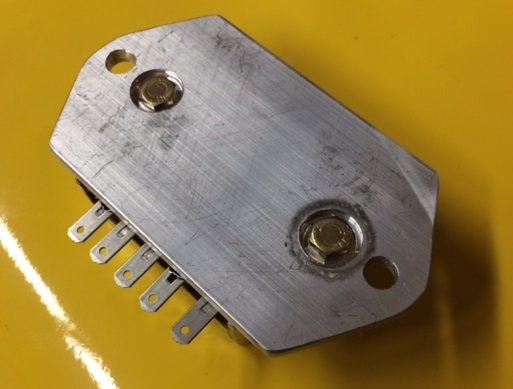

I like Dave12's mounting method using 3/16 aluminum. No modification of the the airframe is required. All drilling is done to the 3/16" mounting plate, not to the firewall. I assume that he countersunk the holes for the J.D. regulator and used flat head screws so that the adapter plate sits tight against the firewall shelf.
I like Dave12's mounting method using 3/16 aluminum. No modification of the the airframe is required. All drilling is done to the 3/16" mounting plate, not to the firewall. I assume that he countersunk the holes for the J.D. regulator and used flat heat screws so that the adapter plate sits tight against the firewall shelf.
Good assumption. Don't know where that idea came from;)
I removed the John Deere regulator and put the original Ducati regulator back in my RV-12 for the following test. I disconnected the small yellow wire from the "C" terminal. Then connected a wire from the load side of the battery contactor to terminal "C". Now my plane was wired just like Aircore wired OlderThanDirt's plane. I went flying and turned off the master switch. As expected, nothing changed. Everything electrical kept right on working. Shutting off the master switch had no affect. There was an intermittent high voltage alarm. Jumpering the regulator control circuit should not be done. Any plane wired this way should have a placard stating, "MASTER SWITCH INOPERATIVE DURING FLIGHT". Back on the ground, I put the John Deere regulator back in and wired it the correct way. An analysis of the downloaded Dynon data showed a maximum voltage of 14.7
I made a mounting plate today. I had some excess .125" stock and cut it to the general size and shape of the Ducati regulator. Drilled two mounting holes. Now I needed a way to mount the new regulator to the plate. I didn't have any countersunk screws long enough, but I did happen to have some AN3 bolts that were exactly the right length.
I had a 1/2" rivet shaver bit that I never had a use for, and being far too lazy to write code to do the work on my CNC router I just chucked it in the drill press. I used it to (slowly) counterbore two recesses for the bolt heads, then drilled through the centers. Voila! A new regulator bolted to a plate that will bolt in place of the original regulator, using the original hardware.

Could you tell me the hole spacing for the JD regulator? I'm going to put in an extra nut plate to account for the difference in dimensions.

John Deere regulator adapter plate. Only one hole is countersunk. The forward
end of the JD regulator is bolted to the existing firewall shelf nutplate.
All John Deere regulators might not be the same, depending on the manufacturer.

I can understand that after looking at Dale's picture. After I made that adapter plate, I think that it would be easier instead to install two new nutplates on the other side of the rudder channel. The disadvantage of doing that is that it will make more holes in the firewall.
My goal was to not have to install any more nut plates, or order a long bolt. I used the original mounting bolts and some AN3s I happened to have on hand. So basically I did it that way because I'm cheap and lazy. :)
