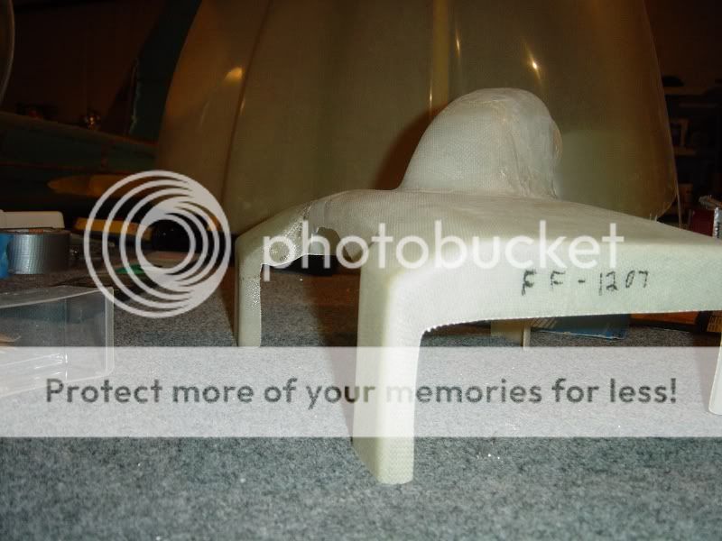

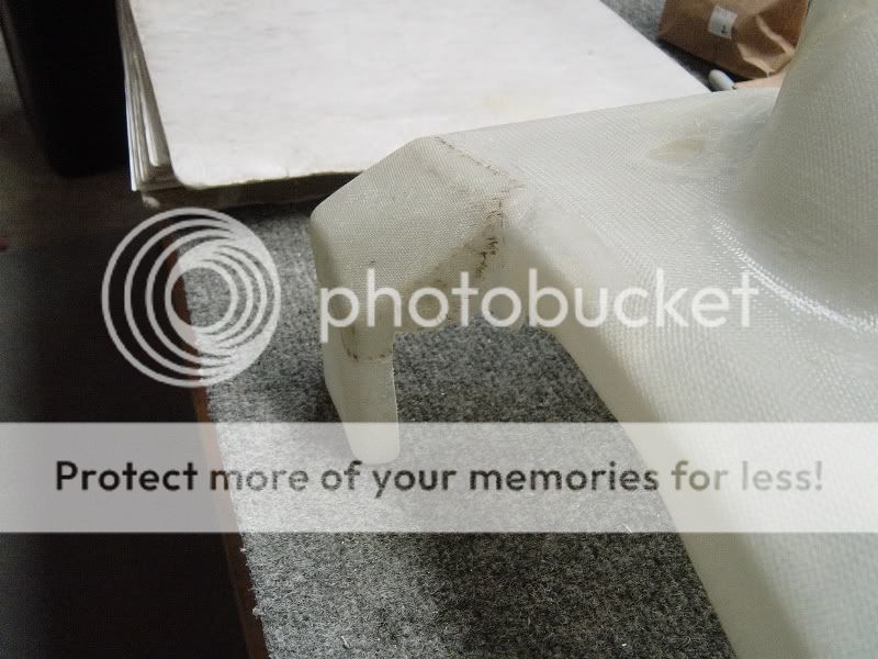

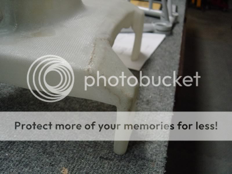

Van's fix
Here are a couple of pictures of the FF-1207 cooling shroud I received from Vans last week in my Engine Kit. It appears to have be fixed by Vans to allow access to the engine bolt. I'm not sure though since I haven't installed it yet. I'm still working on canopy fiberglass and will be until ??
Hey Steve, sorry to be a pain, but I can't tell much from your photos. Perhaps a shot of the entire glas shroud would make it more apparent.
Dick Seiders
Van's new cooling shroud cut out markings
It looks like Van's has copied Tony's cut out to me. See Tony's posting on the previous page.
Bob Kibby "N722BK" flying
Steve, thanks. I think I see it now. When you put it on the engine make sure you can get the bolt out before nailing everything down.
Dick Seiders
The new shroud
Actually, it doesn't look like the bolt could be removed with the new shroud in place. It looks like it would allow access to the bolt with a ball end allen key to check for tightness at the 25 and 100 hour engine check as listed in the Rotax checklist. I think that's all that is intended by the design. I can't really think of a reason to remove the bolt completely unless you wanted to put Loctite or a Nord-Loc washer on it after the fact, so best to do that on initial installation of the bolt, before installing the shroud.
Tony
Shall I assume the shroud will be modified on all new engine kits? And will Vans modify the mold when the current stock of shrouds has been exhausted?
Art Pennanen
Tony, I suspect you're correct in that the bolt doesn't need to be removed. Even if you wanted to loctite it you could likely loosen it enough to get sufficient loctite on the exposed threads. I felt that while I was doing the work to the original shroud I wanted to allow bolt removal as it is the only one of the four you can't get out, and if you ever have to well, you know you can.
