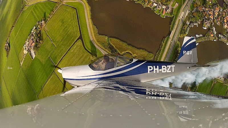

I split a 50 drum of AEROSHELL smokeoil with 4 guys. The skysmoke for the Rotax lasts about 10 - 15 min of smoke, but that's not constant smoke on.
There is not much to clean off of the belly of the 12 and it is easy to wipe off in a few minutes.

Nice! Do you get any smoke in the cockpit?
Did you cut the exhaust pipe?
I still have to seal my gear legs before further testing.
Besides that last week I had to call the tower. An other pilot had called that I had a problem with my engine ;-)
Just a little smoke wandered inside. Most likely thru the gear leg. Our exhaust is trimmed per the plans. It is cool.
During the last 20hours the smoke production was less than before. At my 100hr inspection I pulled the brass smoke nozzle/injector and it was "burned" up and I found the inner piece in my exhaust.
Welded the hole in the exhaust tube and drilled a new 1/4" hole for the stainless injector from Smoke-system-helper and discarded the preheater. In between the oil line fitting at the firewall and the injector I used a hose from Aircraftspeciality. The order was shipped the same day!
Taped the right gear leg opening because smoke was entering the cockpit and I was suspecting the right gear leg opening.
Even without the preheater smoke production looks a little bit better. I think the flow is a bit higher but the belly is still clean. Still a little bit off smoke in the flight deck when I have the pump running for more than 10sec but less than before.
