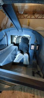

Flight Youth Engineering students completed 2 x SB00053 in the last month.
The first was on the non-attached tail cone and with the help of some tall young students!
The tail cone was lowered vertically over one of our students where standing on a chair it was a breeze to access the rear bulkhead.

The second aircraft was completed in the traditional way with lots of pillows and blankets.
The word has gotten out with one of our local RV-12 owners booking in one of our students to do the SB on his own aircraft:)

For those builders who haven't yet attached the tail cone to the fuselage:
I recently performed SB-00053 on my tail cone that was built before the SB was issued but before I will attach the tail cone to the fuselage.
I put padded blankets on the floor of my shop under the tail cone and rolled up about 20 towels to put inside the floor of the tail cone to support my weight. I also added an outdoor chair cushion on top of the rolled towels. I did this without cutting plywood tail cone floor panels and didn't suffer any damage even though I'm well above the recommended 200 lb limit listed in the SB. To access the bottom rivets, I simply rolled the tail cone onto its side.
I'd installed the manufactured heads of my internal bulkhead facing aft and had to use a 12" #30 drill bit to drill those out.
The biggest problem I ran into was using about 10 of the LP4-3 rivets that were included with the SB kit. For whatever reason, the mandrils on 9 of those 10 rivets broke off about an inch from the manufactured head of the rivet. I then had to use a Dremel cutting wheel to cut off the ends of those mandrils. This scenario had never happened with any of the other rivets supplied for my Empennage and Wing kits. Once I switched to my supply of LP4-3 rivets, all the remaining rivets pulled fine. It could have just been a bad batch of the rivets I received with SB, but I wish I'd switched to my kit rivets after the first mandril broke off an inch from the manufactured head.
Overall the SB took me about 3.5 hours.
Brad, I’ve performed two of these installations and I had the same breakage of the mandrels as you did on two of the rivets - one on each installation. Naturally, both were the rivet at the bottom of the web against the floor of the tail cone. Like you, I never had this issue during my build. I thought it might have been something I did incorrectly, but upon hearing your experience, I’m leaning towards the defective product explanation &#55357;&#56898;
