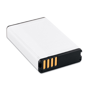

Battery life
I have a aera 510. The battery life was cery short. How is the battery life of the 660 when compare to the aera 510. ?
Hello,
The aera 660 web page provides this information under battery specs:
Battery life: Up to 4 hours during most daytime conditions, (80% backlight) and wireless connectivity in the cockpit, e.g. GTX 345; up to 6 hours during typical nighttime conditions, (5% backlight) and without wireless connectivity.
The aera 660 has a quick release battery compartment door, and at $29.99 list, the battery is pretty affordable to replace when it gets old and the capacity is reduced.
There is also a drop-in battery charger available for $24.99 that makes it easy to keep a second pack charged if you wish to take a backup.
Attaching a powered mount to your instrument panel takes care of all battery concerns.
Steve
