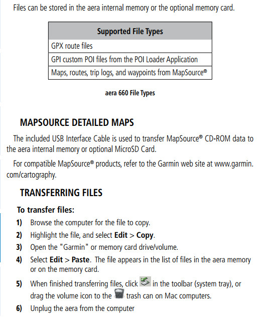

Is there a document anywhere which lists the various file formats which can be stored on the SD card and which the 660 auto detects and does specific things with?
There is this in the user manual
but that's all I can find, and I have seen some references online to an ability to load checklists etc (PDF or image files?).
It would be too good if you could drop in there georefenced maps :)
There is some stuff regarding Mapsource which seems to be some kind of rather old Garmin program... I prefer to avoid unnecessary software but if there is a list which specifically details what extra features one can get on the 660 with it, that would be great too.
I am based in Europe, which dramatically impacts the available mapdata...
