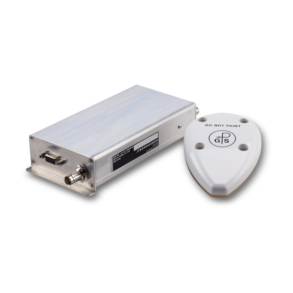

I haven't seen this out there yet, but it may be of interest to folks wondering about yet more ADSB solutions!
The GDL-82 is a neato inline box that you simply plug into your existing transponder installation and uses your existing antenna (but you will need to install the GPS antenna):

With the GDL-82 being a UAT out product, does it have anonymous mode capability when squawking VFR like other UAT products?

Hello Jim,
Yes, you can configure the GDL 82 to transmit in anonymous mode anytime the transponder code is set to 1200.

The GDL-82 is a UAT-OUT device so only transmits on 978Mhz. UAT is not an ADS-B compliant solution acceptable anywhere else in the world. At least not yet.

In lieu of using the GDL-82's internal WAAS GPS receiver can a panel mount GNS 430W provide position source? This would eliminate a need for the GDL-82's external GPS antenna.

Hello Jim,
Yes, the GDL 82 has an RS-232 port that can accept ADS-B+ position data from the following WAAS GPS navigators:
  • GTN 6XX/7XX series navigators with software v6.21 or later
  • GNS 4XXW/5XXW series navigators with software v5.30 or later
  • GNS 480 navigator with software version 2.4 or later
When you are able to take advantage of this, the installation gets even easier.
Steve

Hello Al,
No, the WAAS GPS inside the GDL 82 is only used by the GDL 82.

Hello Bryan,
Good question.
The GDL 82 configuration holds your aircraft registration (N) number and a 24 bit ICAO code, the latter of which is computed from the aircraft N number in the U.S. In normal operation, both ICAO address and Flight ID identify your aircraft to others.
When the GDL 82 is set to the configured transponder VFR code (1200 in U.S.) and is put into anonymous mode (via an installed switch that grounds pin 5), the GDL 82 transmits a random ICAO address (and identifies it as a temporary address within the address type field) instead of the aircraft's assigned ICAO address and transmits a temporary Flight ID of "VFR" instead of the aircraft's N number.
