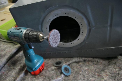

Tips on Proseal Removal
I am struggling mightily in my attempts to remove the T-1209 sender plate from the tank bulkhead. The screws are out and the small fillet of Proseal around the perimeter has been removed/dissolved. I cannot get anything plastic in between the tank bulkhead and the sender plate to work on prying them apart. I am unwilling to use anything metallic for fear of scratching the aluminum....but I am at my wit's end (all 2 of them). I used some methylene chloride based stripper to soften/dissolve the Proseal, but it is too thick for any capillary action to wick it into the joint.
Any ideas?
Tom
Having done it twice Tom, what I did was just get a putty knife and push it between the two surfaces, when wide enough, use a screwdriver and twist it as you break more seal with the putty knife or razor blade. Once you have a start, it comes apart pretty easy.

I'm with Don...I imagine a good ole putty knife and a small ball peen hammer (to drive it with) might be called for. Why worry about scratches? The new pro seal will seal then up fine, so I dont understand what you're concerned about. Am I missing something?
Just redid mine - -
I used a fairly thin blade putty knife and small hammer. Just get it started, and work your way around. Wish I had made a video. Once you see it done, it really only takes a few minutes.
Excellent picture Tony - -
Once you get it started, turn it to the side and keep driving it around. Work a little deeper if needed to get it completely loose. After you have done it once, it is fairly easy. A flexible blade helps a bunch.
I feel a lot better now...
Thanks gentlemen...I'm breathing a lot easier now. I'll proceed to locate a thin bladed knife as pictured. Tony - great picture, thank you.

In case the cover should ever have to removed again (hopefully not), make sure you follow the steps described in the KAI and do not fully tighten the screws that hold the cover (or the fuel level sender) in place, when re-installing it.
This will leave a .030 - .040 " gap filled with sealant that will make tapping the putty knife around, much easier.
Guilty as Charged...
...did not follow the directions and tightened both sets of screws too tight. I had to remove two of them by cutting a grove into the heads with the Dremel tool to use a bigger flat bladed screwdriver.

During the previous SB I removed the cured tank sealant with 3M Roloc 2" abrasive wheel (didn't need any MEK), will take about 20 minutes to clean the mating surfaces.
