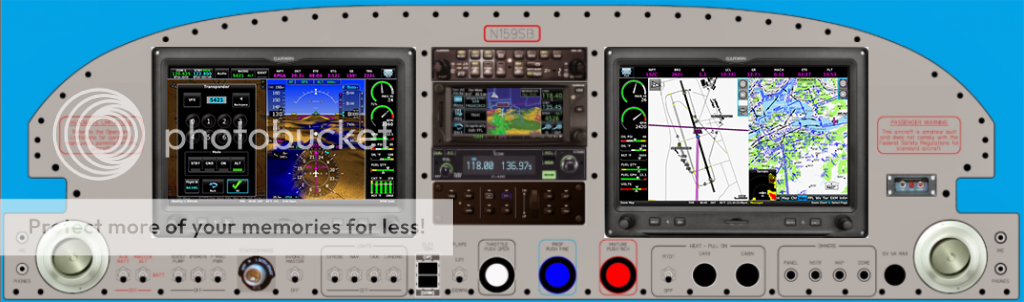

I did a quick and dirty rendering of how this would look on my panel...
Keep in mind that Steve has stated that it is not possible to have this configuration at this time.
I really don't expect to be upgrading anytime soon, I just wanted to see how it would fit.

If you give up the Dynon back-up and the TruTrak autopilot (in favor of the Garmin autopilot) you can fit two GDU 46X displays on your panel, I think.
Note that in my modification of your illustration the PFD pane of the pilot's display is in virtually the identical position as in your original.

Brian,
Welcome to VAF!
The goal of my quick and dirty rendering was to see how to fit one GDU46X in the panel. I just did a major redo of my panel about a year ago. To add two screens means moving the radio stack and that for me is a show stopper since I have already butchered up my subpanel one too many times. I would also have to reorganize all of the stuff behind the subpanel like the VP-X Pro and remote xponder and I am not going thru that again anytime soon.
I have already switched from the GX Pilot to the Garmin AP so that space is available however I will always want a separate, stand alone and unique backup attitude display like the D6 on any panel I build. Two screens and multiple ADAHRS's based on the same platform do not provide a full redundancy solution due to the common code, hardware and communication buses.
Your new layout looks cool, if you build it please post a pic for us to drool on...
