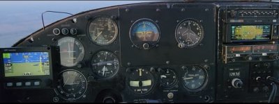

Hi All,
I'm looking for some advice on what's the minimum equipment I'd need to add to my VFR RV-7 to be IFR legal? Asking because I equipped my RV-7 for VFR only and now I'm scoping out the possibility of an upgrade. I currently have a Dynon Skyview system with one HDX display, a single ADAHRS and a Dynon (non IFR certified) GPS. I believe I need at a minimum second/backup attitude indicator, a second ADAHRS and a IFR-legal GPS. Is there anything else I'm not thinking of? And a related question, IFR GPS units seem to range in price from very reasonable to well over $20K. What would the high end units give me that the cheaper ones would not?
Again, I'm just in the initial stages of scoping the possibilities of an up grade. I'd still have to go get the IFR rating if I chose to go that way. Just trying at this point to understand the possibilities.
thanks
-Ivan
Ivan, The $20k GPS will give you GPS, ILS, LOC, VOR, full Vertical navigation and a large moving map display. A large display can give you a geo referenced chart so you can use your HDX as is without splitting the display for reading approach information. $12K units have smaller screens and still give you VOR, LOC, ILS, and GPS with full Vertical navigation, but charts are displayed on your PFD or IPad. Most $5K units that I know of are GPS only and do not include step down altitudes in the vertical navigation.
If you do not have a transponder capable of ADS-B out you will also need to have an upgrade. The above GPSs will send the required position data to the transponder for ADS-B out for ATC.
If your plane is equipped for day/night operation, with legal ADS-B out, the cheapest certified IFR GPS will work. You will need the required database updates and required static and transponder checks so your plane can fly legal IFR fights to airports with matching requirements for approaches.
If you plan on getting your IFR ticket in your plane, the IFR ACS as interpreted by most DPEs require two different NAV sources for two of the required non-precision approaches. GPS alone doesn’t make it unless you have a separate unit that has the VOR and LOC with it. There are a few DPEs that interpret the ACS differently, but good luck finding one. Check with the DPEs in your area before doing the minimal.
There is a higher risk if you don’t plan for back-ups for your systems and equipment. There is a possibility of getting ice in your pitot/static system. There are some pilots that won’t fly IFR in an RV because it only has one engine and limited de-icing. You need to determine your risk based on the mission for your intended flights.
You can PM me if you wish to discuss.

If you could only have one NAV for IFR and be most useful, a TSO'ed GPS w/ current database is obvious choice in 2024. The rest is in FAR's for instruments and NAV required. Flying IDR w/o IFR approved FPS navigation is limiting. Yiu can get away with out having ILS capabilities.
For me my IFR Nav is Garmin GPS175 backed up with (for Ref Only) GRT EFIS GPS and database and iPad (internal GPS) EFB map (including Geo Sync approach plates). One mode S transponder ADS-B out and one COM (with standby Freq monitor) rounds out my IFR Lite panel. Sure VOR LOC GS DME would be nice. However not needed for what my mission is.
Good Lord who is paying $10K used for a 430W? More like $4K.
That was my shock, but my recollection looking a year ago about $9K Looking at eBay current prices average $6K, High $8K low $4K. Does it have antenna, tray, connectors. Cosmetics, working? No need to argue, but a few points on the 430W, great unit, introduced 25 yrs ago, out of production 13 yrs ago. Garmin announced it was phasing out support and parts would progressively become unavailable. Some parts are already not available from Garmin. Also to use a GNS420W fully, you need a G5 or some external display. G5 base price does not include installation kit, battery, so expect over $2K for experimental and + $3K certified G5. If you buy a used GNS430W (assume $6K with tray, connector, antenna) and G5 ($2K) will put dent in $10K. Add cost and weight for COM, VOR/LOC/GS antennas and cables. That is why I am going with just GPS175.... Granted I can use my GRT Horizon EFIS to display Garmin's NAV data (with an ARINC 429 adapter), for the 430W or GPS175. So apples and apples a GNS 430W used and GPS175 about same price, may be a little less for the GPS175. However the GPS175 is GPS only. I really don't want or feel I need to add a second COM and VOR/LOC/GS of the GNS430W. A second COM is nice but you can add a remote COM (controlled for through EFIS) for $2K. My iCOM has standby Freq monitoring. MIN IFR going with one COM. (Yes I have handheld but if it gets that bad and I am in terminal area CELL PHONE might work better.)
When I say IFR I mean light IFR... Departing airport with low VFR, to climb on top, or en-route undercast, IMC let down to high MINS approach. I have no desire to fly night IFR over terrain with potential convective or icing conditions with low ceiling and visible at MINS, in single engine single pilot sky scooter. I want enough to legally get into the system even if VFR conditions. If going into say LA area, far better to be on IFR flight plane arrival than hunt peck around the airspace VFR. Even if the weather goes to MINS a GPS175 and LPV approach will get me down low mins, even as low as a CAT 1 ILS, 200 and 1/2, although 300 and 3/4 are common the low MIN LPV are not rare. In some cases LPV is better than ILS due to signal interference of an ILS when near mins, including aircraft on taxiway.
If a 430W fell into my lap I might cut a hole in my panel for it, but the new "over the counter" direct to user GPS175 with touch icon driven screen (albeit smaller) is for me. Their combo units GNX 375 (GPS+TXPD'R) and GNC 355 with (GPS + COM) are nice, and kit plane freindly. Call them.
GPS 175 is new, OK for end user to buy, install and get Garmin support.
I like the GPS 175, have it hooked up to the KI209 (another reason to go 175 over 430, 175 plays well with a strait 209, the 430 must have a 209A), the KX155 goes to the upper loc/glide indicator. The GRT mini GA is a nice addition, my IFR setup, KISS principle.
