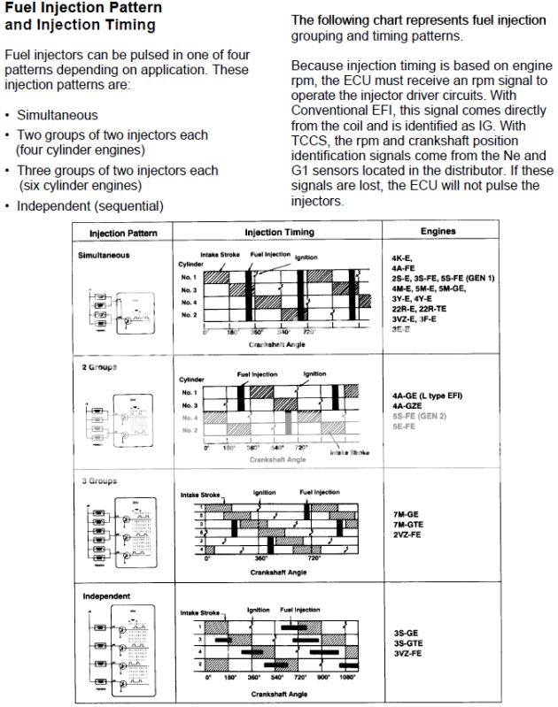

I've attached a semi-sequential injection diagram below, compared to batch injection. If installed on identical engines, either must inject the same fuel quantity for similar power, so the difference here is merely when the injectors are opened. It's probably a good representation of the System 32. If not, I'm sure we would all appreciate a correction. One wildcard, for example, might be injector flow rate, which would change the pulse width.
Take a hard look. Is there an advantage to one or the other, and if so, why?

Sounds like you are trying to decipher what Robert means by, "System32 provides semi-sequential fuel delivery timed to intake valve operation."
I suspect that all that means is that he has a dedicated injector channel for each cyl so he uses the crank position sensor to determine where he thinks the cyl is at in the cycle and injects fuel at a specific time as opposed to once per cycle for all cylinders.
Whether that makes a lick of difference really boils down to two things in my mind:
1. As discussed earlier, how would he be able to determine if we are on the intake or exhaust stroke. Without this information he is blind, so everything else is moot.
2. Even if he did know exactly where the piston is in it's stroke, does the fuel atomize better if it's sprayed on the back of a open or closed valve? In our application, I suspect it matters little.
