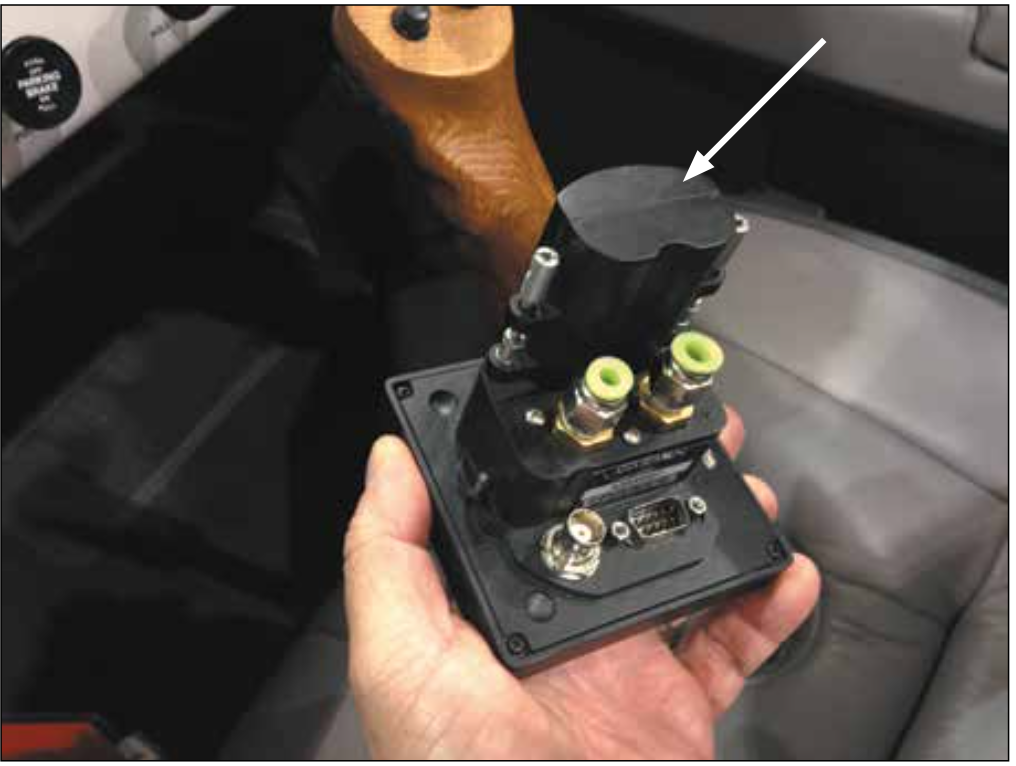

None of this stuff is perfect. I emailed my vendor of choice today asking for suggestions as to why my G5 (with battery back-up) routinely shuts down in flight.
Please post your resolution, our vendor of choice resolved similar issue perfectly. (Mine never shut down in flight but could see battery was not charging past 75%)
