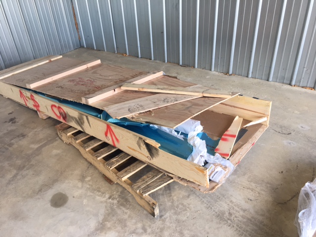

If it makes you feel any better, my first crate (tail) was damaged.. About $400 worth of replacement parts. Luckily I still had enough good parts to keep me busy for awhile.
The carrier was Old Dominion.. the wing and fuse kits came later by the same carrier and were OK. Its just what happens when an underpaid new dock worker runs his forklift into the side of the crate. Van's was really responsive and provided all the papers I needed to submit a claim.
Unfortunately, the "crating charge" cost of $75? or so was NOT covered by the carrier. So I did have to pay a little out of pocket.
I guess I'm not alone in the damaged shipment department. When the driver delivered the crate he asked me if I had anything he could use to help drag the crate out to the lift on the back of the truck. He said that whoever loaded the crate must have pushed it in with a fork lift because the crate was in the truck the long way. There was a stencil warning spray painted on the side of the crate saying "no push" and I mentioned it to the driver but he said nothing. At that point there wasn't much I could do as the crate showed no sign of damage at all. It wasn't until I unloaded the crate that I saw there was damage to the skins inside. When I finished unpacking the crate and stood it up on it's side to move it out of the way is when I saw the reason for the damage to the skins inside, but by that time the driver was long gone. The fork from the fork lift had found the seem between the side panel and the bottom plywood. It was one of those things that makes you shake your head in disbelief. The fork slide right into the crate without damaging it, and when the fork lift drive backed away the fork just slid back out leaving no trace of external damage.
Lesson learned... before signing for the shipment make a note "Subject to inspection".
