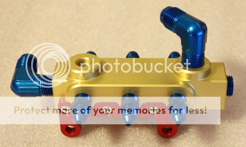

New Fuel Block
Just received these back from the anodizer:
1/4 NPT in and out on ends, another 1/4 NPT on top for outlet or can be capped. 1/8 NPT on sides and 1/8 NPT for fuel pressure takeoff on top rear.
These bolt to the crankcase spine about halfway down.
Wow, great looking part, maximum functionality and minimum weight/mass.
Thanks. Took some feedback from customers who wanted some options for the return fitting positioning. On 4 cylinders, at this time, we'll use the same part and just plug 2 of the side ports. Later we may develop a shorter block for fours.

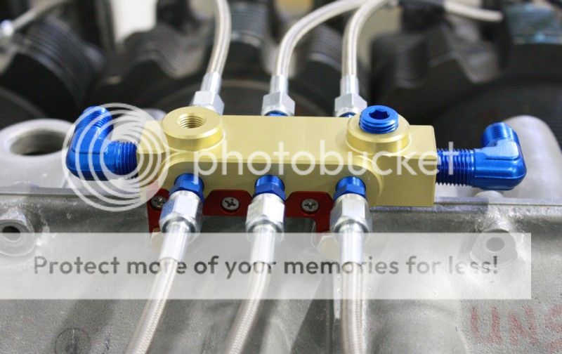

Here's another photo of the block mounted up on a 540 case with the braided -3 lines.
