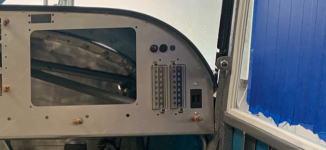

I had to make a change to the CB's in the right hand "wing" of the instrument panel and it was pure torture. Not accessible. Any new panel design or re-wiring effort will include moving those CB's....OR installing some ECBS.
So i was initially attracted to the ECBS concept. All wires run to one spot. I have to say that I erroneously thought that, somehow, an ECBS system would result in simpler wiring. I also liked the fact that you could observe status of various circuits.
After reading everyone's comments I can see that one way or another - fuse block, CB bank, ECBS, you still have to run the same wires to some connection.
Given what I've read, I'm going to either stick with CB's or move to a fuse block.
The only reason I'm considering a fuse block is that it's smaller so it takes up less space, and is more easily swung out of the way but swung out for access.
However I tend to lean towards CB's.
One option I'm considering is mounting a block of CBs much like Walt's arrangement in post #42, but on a hinged door so that it swings out from the panel.
Anyway that's where I stand now and, again, I thank everyone for taking the time to post their views.
Another option is just a variation of the idea you've mentioned above. Mount the CB's on a sub-panel which screws to the face of the main frame of the instrument panel. Wire the CB's such that you have a large enough service loop to allow the sub-panel to be unfastened from the main panel and laid out face-down on your knees so you can work on it. This will cost you an extra foot or more of wire for each circuit but SO worth it when it comes time to work on the power circuits. The same advice would apply to a fuse block installation.
Also, with fuse blocks, be aware that some fuse blocks suffer from poor retention of the "clips" into which the fuses are inserted. This means that inserting a fuse can cause those clips to back out -the harder you push, the further they back out until they touch the metal to which the fuse block is mounted. Then the real fun begins! For those who wish to go with fuse blocks always suggest installation of an insulator between the block and the metal panel to which it is mounted.
Yes that occurred to me to just screw a CB block sub-panel to the main panel.
Simpler to install - 4 screws holding the sub panel onto the main panel - and the longer service loops makes access to the back side of the CB's much more convenient. Also, possibly less main panel space would be taken with some nutplates as opposed to the hinge leaf.
Drawback is, as you say, longer service loops. I wouldn't care about the cost of extra wire. My only concern would be the wires of the much larger service loops for 25-odd CBs taking up a lot of space behind the panel. And I'd have to come up with a method of supporting those loops when flying acro, and yet a quick release of those supports when I need to pull the panel.
With the hinged door, I would have to have a service loop as well (said door held to the panel with a 2-3 screws on the edge opposite the vertical hinge line). But the door service loop could be smaller than the one necessary for the screwed on panel.

I think this looks reasonable enough to use auto fuses and still give me the features of seeing if something failed.
