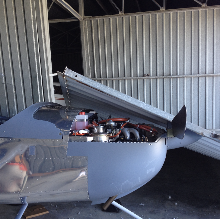

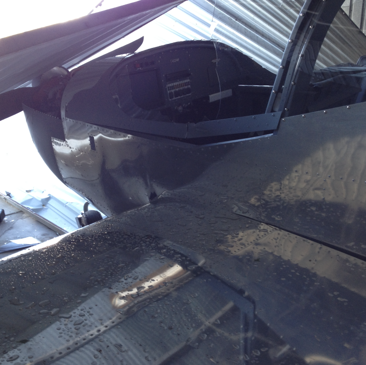

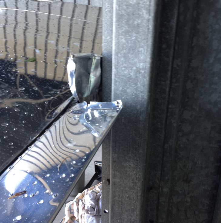

Santa Monica was hit with 35 to 40 kt winds last week, and the hangar doors got blown off their tracks, effectively locking my plane inside.
Hangers are not necessarily a safe haven. Hanger doors must run in an enclosed track so they don't come loose. New RV-12 with 2.0TT was destroyed in a sturdy metal hanger by microburst thunderstorm when doors unlatched from overhead track. Several planes wrecked...
