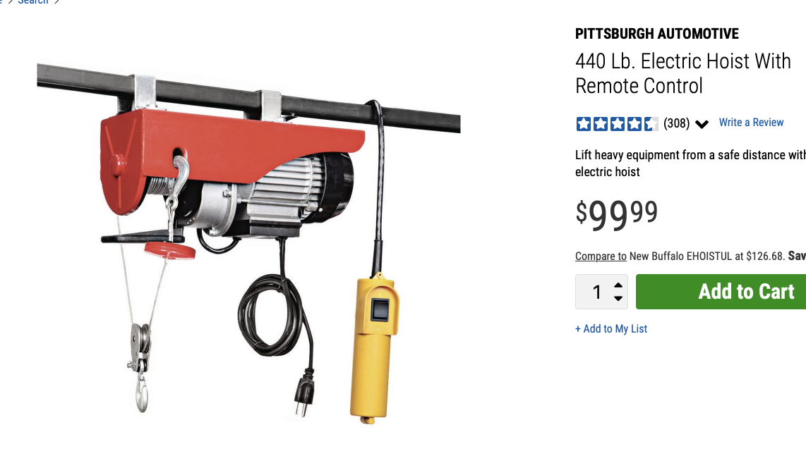

Harbor Freight Electric Hoist used as a winch... https://www.harborfreight.com/440-lb-electric-hoist-with-remote-control-60346.html
I installed this 15 years ago for use with my J3-Cub and now RV-12. Tail hook on RV-12 is very substantial. I extended the pendent switch so it can reach 30' in front of the hanger. So, one hand guides tow bar to steer while other hand controls winch motor. I installed the winch about 5' above ground level so pulling force doesn't raise nose wheel off the ground. Works a charm...

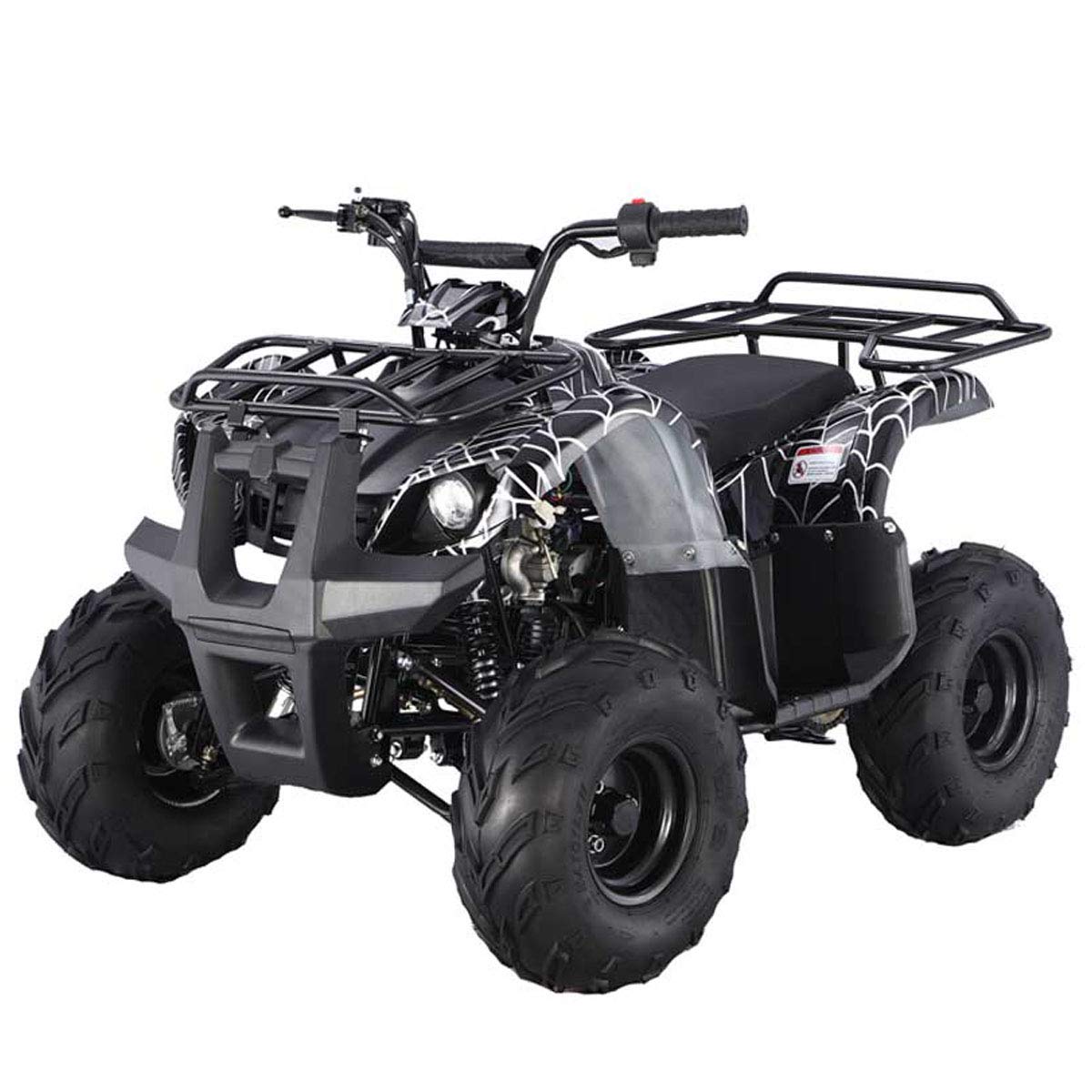

little quad?
It seems if you have the space, a small quad would be a good solution - they are not expensive. No idea why small gas and electric tow bars are $1500 when a little quad is only $500. I guess you can get used quads for a lot less. Just need to rig up a way to attach a tow bar.
I might need one since I'm in a shared hangar, and the aircraft in front of me is very heavy. I can move it using my legs, but it's quite a workout, and not much fun.
Another idea might be to modify an old self propelled snow blower or tiller or something else like that, but quads are much more fun to ride. :D
This is the sort of device I had in mind. Harbor Freight has an even less expensive winch, designed to be mounted flat rather than hung from the ceiling. Using the tail tie-down ring as the attachment point was what concerned me. Glad to read that you've found that the tail hook is substantial.

The HF hoist has an emergency shutoff. The wire rope is guided through a switch arm that activates when the rope is fully wound up on the spool. I have tested it and it works fine. The RV-12 only weighs 750# empty so the hoist can pull it up an incline by the tail hook no problem. The tail hook is mounted into a hard-point on the tail cone so loads are distributed very well. In fact, when I fly early in the spring the hoist/winch is needed to pull the plane back into the hanger thru wet/soft turf. Almost impossible to push by hand even with two people.
The key to guiding the plane in reverse is the have the winch mounted higher than the tail hook to keep the nose wheel in contact with the ground so it can be easily steered with the towbar.
I have added 15' of nylon rope to extend the winch's reach further in front of the hanger. With this added reach I don't need to pull the plane so close to the hanger. A secondary benefit is the winch shuts off with the above mentioned emergency switch and the plane safely stays 15' from the back wall of the hanger. With the airplane 2/3 of the way into the hanger it is very easy the use the towbar for the final positioning.

quad
What is a quad?
a four wheel motorbike like this:

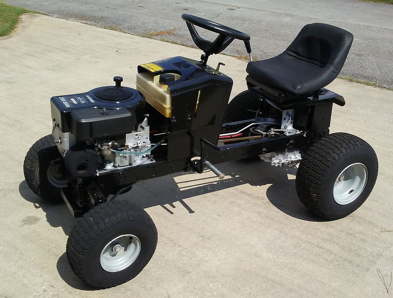

Here is my "quad" RV-6 tug: :D
About $90 for carb, tubes for the old tires,battery and general cleanup/paint of a derelict Murray lawnmower.

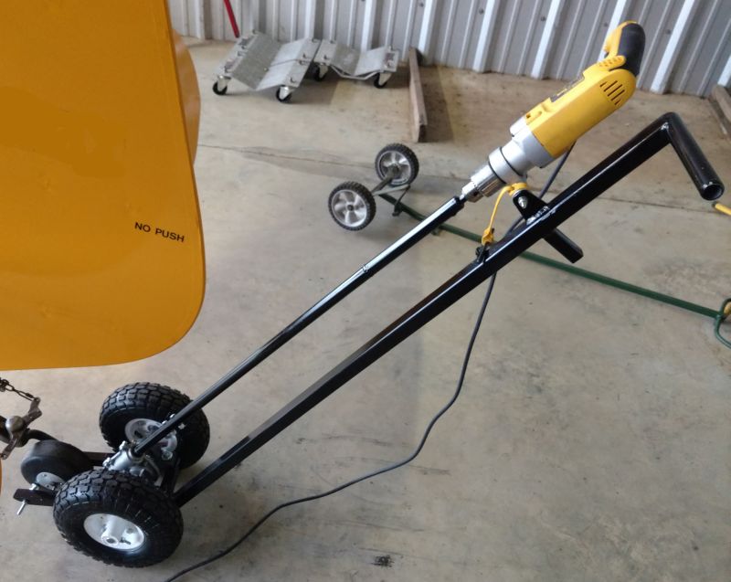

Lift Nose Wheel
What if you use the block and tackle or a winch to pull the plane in by the tail. And add maybe 15 or 20 pounds to the tail ring to slightly lift the nose wheel off the ground. Then it cannot turn sideways. I used to back up a 172 by pushing down on the tail and maneuvering it backwards. It was the easiest and fastest way to back a nose wheel plane.
You want to be able to control and steer the plane as it retracts into the hanger. Airplane should follow centerline of the door opening, and if close on the sides, perhaps put a marked line on the floor. Use the towbar to steer so plane tracks centerline. If using a winch to pull the plane, mount the winch on back wall of hanger at about 5' above floor level so that pulling force does not lift nose wheel. Extend pendant switch so it reaches about 25' in front of hanger. Very simple - pendant switch in one hand and guide towbar with other hand. Why make this so complicated...

If 120 volts is available, I like Jim Stricker's idea of using a hoist. Amazon has
a similar looking HOIST for $80 with free shipping.
Using the pulley will reduce the speed and initial jerk.
