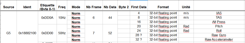

I can chime in here. I have 2 G5s, a GMU-11 and GAD-13. I hooked up a cheap $100 CAN bus analyzer from Amazon and observed. The packet protocol is fairly straightforward, easy to reverse engineer, and has no encryption or obsfucation. Here's a little bit of useful data that I located, mostly specific to the G5. When I characterize more of the GMU-11 and GAD-13 packets, I'll post a more complete and properly-formatted write-up.
* AHRS data packets transmitted at 50Hz, CAN ID 18882100. Packets start with 0xDD00. Pitch, roll, raw gyro and raw accelerometer data are in 32-bit floating point format starting at packet byte 20.
* Pitot/Static data packets at 10Hz, CAN ID 18882100, packet starts 0xDD0A. IAS, TAS and pressure altitude are at byte offsets 4, 8, 16.

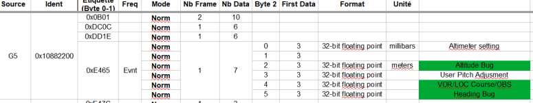

* Any time the G5 knobs are used to change a value, the updated value is sent in a packet with CAN ID 10882200 and packet header 0xEA65, new value in floating point at byte offset 3. Byte #2 indicates what is being changed:
0: altimeter setting in millibars
2: altitude bug
3: user pitch adjustment
4: VLOC course/OBS
5: heading bug
Angles/headings are always radians, speeds in meters/sec, altitudes in meters, pressures in millibars.

411574528x = 18882100hex
And I see in my second frame data begin with 221;0 witch is 0XDD en hex.....
So, for exemple with this frame:
1479,4122;RX;411574528x;8;221;10;48;0;68;115;11;0;
1479,4122;RX;411574528x;8;29;2;0;0;104;97;141;62;
1479,4122;RX;411574528x;8;230;235;97;63;54;118;16;59;
1479,4123;RX;411574528x;8;85;134;31;67;96;108;95;65;
1479,4132;RX;411574528x;8;96;108;95;65;0;0;0;0;
1479,4132;RX;411574528x;4;11;221;45;61;;;;;
IAS was 0;68;115;11 ? (44730B in Hex)

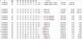

My value last year:
-----id------- DLC B0 B1 B2 B3 B4 B5 B6 B7 Read Value --------- FUNCTION
0x10882200 007 E4 65 00 00 00 DA C5 00 1013 --------- altimeter setting in millibars
0x10882200 007 E4 65 00 00 38 C7 47 00 1020 --------- altimeter setting in millibars
0X10882200 007 E4 65 02 0A D7 F3 41 00 100 --------- altitude bug
0X10882200 007 E4 65 02 0A D7 73 42 00 200 --------- altitude bug
0X10882200 007 E4 65 02 67 66 98 43 00 1000 --------- altitude bug
0X10882200 007 E4 65 03 88 C3 64 3B 00 0,2 --------- user pitch adjustment
0X10882200 007 E4 65 03 88 C3 E4 3A 00 0,1 --------- user pitch adjustment
0X10882200 007 E4 65 03 88 C3 E4 BA 00 -0,1 --------- user pitch adjustment
0X10882200 007 E4 65 05 00 FB 0E BD 00 358 --------- heading bug
0X10882200 007 E4 65 05 00 FC 8E BC 00 359 --------- heading bug
0X10882200 007 E4 65 05 00 00 00 00 00 360 --------- heading bug
0X10882200 007 E4 65 05 35 FA 8E 3C 00 1 --------- heading bug
0X10882200 007 E4 65 05 35 FA 0E 3D 00 2 --------- heading bug
0X10882200 007 E4 65 05 50 77 56 3D 00 3 --------- heading bug
0X10882200 007 E4 65 05 35 FA 8E 3D 00 4 --------- heading bug
0X10882200 007 E4 65 05 DB 0F C9 3F 00 90 --------- heading bug
0X10882200 007 E4 65 05 DB 0F 49 C0 00 180 --------- heading bug
0X10882200 007 E4 65 05 DC 0F C9 BF 00 270 --------- heading bug

My value last year:

If you take from with Id 0x1882200
Bbyte 0 and 1 in the frame represent a label, in this case 0xE465.
For this label, the complete transmission will be carried out using 6 concecutive frames, the number of which is visible on byte 2. The rest of the data correspond to the values to be transmitted.
In this example, they are encoded in 32bit floating....
So, for the "altitude Bug" value, it's on frame ident 0x10882200,
label 0xE465 (byte 0 and 1)
and frame number 2 (byte 2))

There are other types of weft, including cyclic ones.
For example, the one sent with ident 0x18882100. Bytes 0 and 1 of the first frame sent contain the label followed by the total number of data in byte 2.
example 1: label 0xDD00 with 0x38 i.e. 52 data transmitted over 7 consecutive frames.
And on these 52 data we find, for example, the pitch from byte 20 coded in 32bit floating point, unit in radian.
Here are 2 examples of G5 frames:
620,8212;RX;0x18882000x;8;0x01;0x00;0x01;0x00;0x3C;0x00;0x60;0x33;
620,8212;RX;0x18882100x;8;0xDD;0x00;0x38;0x00;0x03;0x64;0x03;0x60;
620,8212;RX;0x18882100x;8;0x7A;0x77;0x07;0x00;0xFF;0x97;0x01;0x08;
620,8212;RX;0x18882100x;8;0xF9;0xCF;0x4B;0x3F;0xBD;0xD4;0xA2;0xBE;
620,8223;RX;0x18882100x;8;0x9B;0x52;0x25;0x3C;0xA8;0xC3;0x9A;0xB8;
620,8222;RX;0x18882100x;8;0xE8;0x4C;0x44;0xC0;0x04;0x04;0xC6;0xBD;
620,8222;RX;0x18882100x;8;0x20;0xB2;0xF9;0xBE;0x7E;0x76;0x92;0xB8;
620,8222;RX;0x18882100x;4;0x00;0xA8;0xA4;0x3B;;;;;
621,5882;RX;0x18882100x;8;0xDD;0x0A;0x30;0x00;0x78;0x7A;0x07;0x00;
621,5882;RX;0x18882100x;8;0x1D;0x02;0x00;0x00;0x00;0x00;0x00;0x00;
621,5882;RX;0x18882100x;8;0x00;0x00;0x00;0x00;0xE5;0x3A;0x1E;0xAC;
621,5883;RX;0x18882100x;8;0xBA;0xC1;0x44;0xBD;0xDB;0xF6;0xB3;0x42;
621,5892;RX;0x18882100x;8;0x60;0xA4;0x66;0x41;0x00;0x00;0x00;0x00;
621,5892;RX;0x18882100x;4;0x4C;0x30;0x74;0xBD;;;;;

Dear Wasp, Trying to get this. Below is my interpretation.
LABEL 0xDD00
620,8212;RX;0x18882100x;8;0xDD;0x00;0x38;0x00;0x03;0x64;0x03;0x60; ... means 38hex long message
620,8212;RX;0x18882100x;8;0xF9;0xCF;0x4B;0x3F;0xBD;0xD4;0xA2;0xBE; ... bytes # 20,21,22,23
Byte 20 with 4 bytes length
HEX 0xBD;0xD4;0xA2;0xBE, converting to 32bit floating point ...
DEC -0.103826 rads
DEG -5,948 degrees
Is it Correct ?
.... My value last year:
Still, cant get the number 1013 or 1020 from the above 32bit floating point of your post (Apr 29, 2020).
1013 in float would be 0x 44 7d 40 00 and
1020 being 0x 44 7f 00 00
I don`t see those values above. What I am doing wrong ?

Yes I have make a error for 1013
