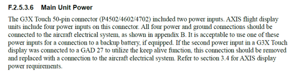

This question is more for G3XPERT but I'm putting it out there for everyone. I'm going to be upgrading my GDU460 to a GDU116Bx as soon as I receive the unit from Stein. So I have started to plan the changes to my electrical system. A few issues that have come up:
The installation manual says that if you used the GAD 27 keep alive function with G3X that you should disconnect this and connect the Axis flight display directly to the electrical system. Without the GAD 27 or a backup battery, does the Axis display have some sort of brownout protection that will keep the Axis display powered when cranking the engine? If not, does Garmin recommend a backup battery?
Also regarding the increase from 2 power inputs to 4 power inputs for the J1012 connector -- which note 6 to Figure B-1.1 says is for the PFD/MFD/GPS functions -- I have several questions:

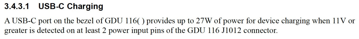

1) Is the J1012 connector also for the USB-C charging (since I note the power inputs on the J1015 connector are only needed for the GDU116C/NC units per note 8 to Figure B-1.1)?

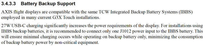

2) The paragraph above says that if you have a backup battery, you can put it into one of the J1012 power inputs. Does that mean that any one of these inputs can power all PFD/MFD/GPS functions, or is there reduced functionality if only running on one input through the backup battery in the event of electrical system failure? Assuming the answer is all these functions can be powered on one input, then what's the purpose of 4 vs 2 power inputs since 1 extra input would solve for redundancy?

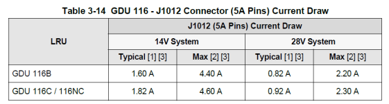

4) If all four are truly needed, do they all equally draw the same amount of current? The main reason I ask is because my existing GDU460 wiring is two 22AWG runs, one on a 5A breaker and one on a 5A fuse (fed from the e-bus to which the GAD27 keep alive power flows). Ideally I could keep those two runs and just add two more that are 20AWG.

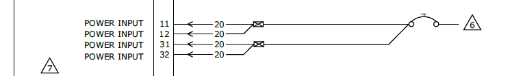

5) What does Garmin recommend for the breaker size that all four inputs are tied to?
6) Usually when I see splicing like that it is a bigger wire run that is stepped down in gauge to fit the dsub pins. Does Garmin recommend a larger gauge between the breakers and the pin splice?
J1012 Connector:
I note the increase in max draw over the G3X's 2A at 14V:
Installation manual 3.4.2 GDU Power Requirements says "The main 50-pin connector (J1012) has four main power inputs. This connector is present on all display variants. All four power and ground connections should be connected to the aircraft electrical system. It is acceptable to use one of these power inputs for a connection to a backup battery, if equipped."
If one pin connected to a backup battery is sufficient to keep the display working then why are 4 pins needed for normal operation? Wouldn't one expect half the pins to be allocated to primary power and half allocated to backup power?
When Garmin LRU have redundant power inputs then they are often described as "diode ORed". I found no such description of the AXIS DU power input pins.
I would like to see at least a block diagram level representation of the internal power distribution.

A backup battery serves as backup power for the system to operate on, in the absence of the primary electrical system, and is also used to protect against voltage sag during engine start in many G3X Touch systems. We expect many AXIS system to incorporate backup batteries to run the system in the case of an electrical system failure. The use of backup batteries is discussed in the installation manual.
You are correct.
Full 27W USB-C charging is not available on only 1 power input pin, which changes the power consumption of the device. The system has different power requirements from G3X Touch in general and we strongly suggest providing power to all 4 inputs. As mentioned in the manual, if a backup battery is incorporated in the system, use one (and only one) of those inputs for that connection.
Yes
If wired as shown, 7.5A @14V.
Here's what I'm going with:
The 4 power inputs on J1012 are diode ORed. We will clarify this in the installation manual.

So, in addition to power inputs ALL 4 power grounds MUST BE connected ?
Tom
I'm curious about this too and alternatively, if using all four ground pins, does each wire need to go back to the common ground point or can the four grounds be spliced close to the device with one wire going back to the ground point?
I'm very curious why the device calls for four 20awg power inputs fed from a common breaker and four 20awg grounds to power a max of 4.4A. Is this to lower voltage drop? Or is this one of those things the FAA requires for certification just because? Maybe some of the electrical engineers here can shine some light on this.

this iis to support the USB charging capability on the usb-c port in the bezzel.

But since the total draw of the unit with the USB-C charging maxes out at 4.4A and all inputs tie to one breaker, why are four power inputs needed to support charging and the unit in general? I’m trying to figure out the technical/engineering reasons.

A bigger puzzle is that Garmin suggest a single power pin is used for backup power. In my aircraft I run all G3X Touch LRU for extended periods on IBBS (database loading, configuration review and edit, etc.). I asked g3xpert why one pin was sufficient to power AXIS on backup power but 3 would be required for normal power (MAIN bus in my aircraft). That question was not answered.
M39029/64-369 pins are rated at 7.5 A each so the use of 4 pins does not seem to be driven by pin rating.
It was somewhere else - the USB is the big draw and disabled when running on one wire
It maybe prohibited but how would it be disabled?
We have been told the 4 input pins are diode ORed so they feed a common point in the AXIS DU. Yes, it would be possible to have current sensing on each input before the ORing diodes but I have seen no indication that is done.
The question of why still remains. If 4.4A (which is enough to support full charging and all functions) can be technically be pulled on one pin then why are four inputs needed/recommended, especially when all four pins are tied to the same power source. The only benefit I see is it reduces the load on each of the four wires, perhaps reducing voltage drop (?), but any one wire can easily handle 4.4A so the benefit isn’t clear to me.
