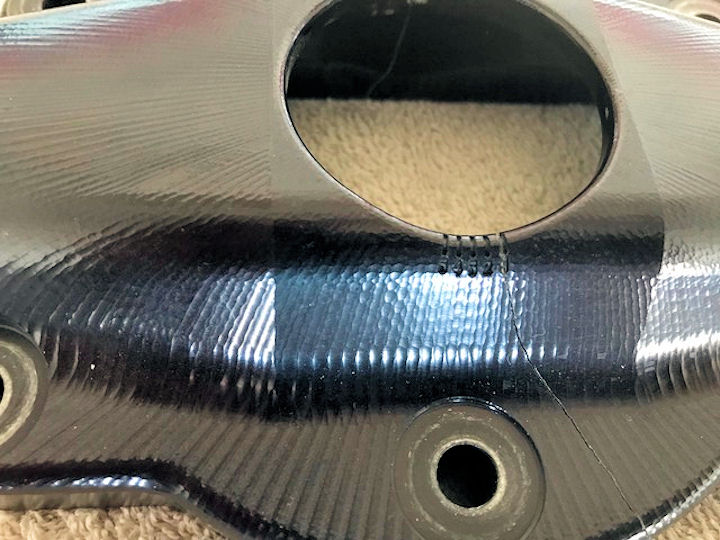

Looking at this photo, I’m struck by three things. 1- The surface finish of the entire part (ignoring the paint) is riddled with irregulaities- not done to the standard I’d expect on a modern critical part. 2- It appears that one of the deep hatch marks may have served as a stress riser from which the crack initially propagated. 3- The irregularity and extreme granularity of the face of the actual failure zone makes me wonder about the consistency of the alloy.
My guess is Sensenich is re-running a Finite Element Analysis to try to find the mode of failure...

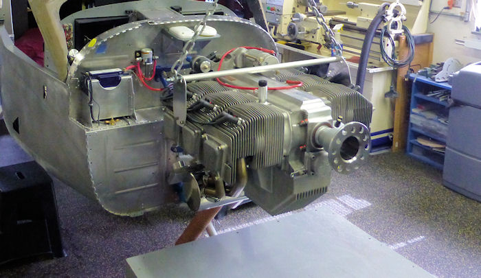

I'm using a WhirlWind GA_J2B
I install the new Jabiru 3300 Generation 4 Engine in my 12
I'm using a WhirlWind GA-J2B

Joe, that?s a scary crack. Did you discover it without removing the forward spinner bulkhead? It looks like it would be visible at the edge with the bulkhead in place. Was yours one of the 3 Jabiru failures noted in the SB, or is this in addition to those 3?

Let?s see if I?ve got this correct? reading back through this thread I list three prop hub failures as follows:
? Robert Liddell - Hub failure in flight with safe landing. Hub sent to Sensenich ? awaiting disposition.
? David Heal ? Appeared to have found two cracks per SB. Hub sent to Sensenich ? awaiting disposition.
? Joe Dallas ? Hub cracked in half. Sensenich replaced with new design hub.

Had mine inspected this week for the second time in compliance with amended SB. Nothing found at 280 hours. Has anybody found a crack (apart from the one that started it all)? I?ve ordered a replacement cover plate to avoid the repetitive inspections.
Jack
Instead of a version "D1" hub, which will eliminate repetitive inspections per Sensenich FAQ, I opted for the newest design front hub which is either "E" or "F". This design has the three smaller holes in-line with the prop axis. Normally the pins in the shank of the prop blade need to be relocated by the factory to allow use of the gage pins for setting rough pitch angle. I will keep my blades as-is and set pitch manually with use of digital level per the Van's setup procedure. This is how I did it with my "B" hub - not relying on the pitch cylinder.
Jack asked: "Has anybody found a crack (apart from the one that started it all)? I?ve ordered a replacement cover plate to avoid the repetitive inspections."
Yes, my original circa 2013 / 650+ hour prop hub cover plate was cracked exactly as depicted in the SB. I have just installed a new Revision D1 cover plate per Sensenich's SB and FAQ.
Thanks, David. How does the Revision D1 differ from the problem covers? I have the paperwork to order a D1 through the Australian dealer but in light of Jim?s comments, I am wondering whether I should go for the newer version.
