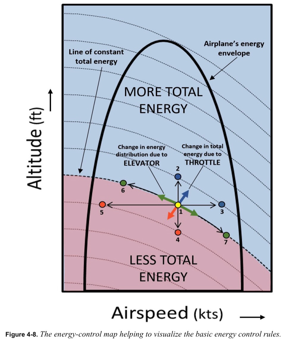

Yup. Energy is power converted into some combination of altitude and airspeed. I can't refute your basic game plan, but if the engine fails on takeoff, it's just a physics problem at that point. How I fly the airplane is an energy management problem.--what do I want to do with the energy available? If I have a smart computer figuring out where I'll crash (continuously computed impact point), I'll factor that into my decision matrix. If I can fly a simple condition (say on speed AOA) to make that work out, even better:

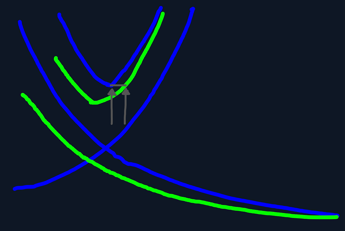

What was this mysterious carat? It was the E-bracket. You see, while we use pitch to control AOA and power to control path, you could still see path forecast in the AOA. That’s right, AOA is a lead indication of power requirement. If you saw the staple aka E-bracket drop meaning the velocity vector rapidly rose to above the bracket indicating a rapid slowing, you knew you needed to add a shot of power before you saw a VVI increase or path going lower. Similarly, if the bracket rose, you knew you needed a (lesser) power reduction (quickly to be counter-corrected).
What is a power carat? Well, power is energy over time. What is AOA? AOA is your kinetic energy relative to adequate kinetic energy for your craft. AOA predicts power needs.
Think about this, if you inadvertently go slow, and you’re not “stick thermalling,” that is you’re not inadvertently adding back stick, your trim is going to restore you to trimmed AOA and that means the nose is going to go down and your path down will steepen VVI down increase, except should you add power to change that VVI. It is still pitch for AOA, power for path, yet we now have this extra with AOA forecasting path.
This does get a little tricky for us in RVs unfortunately, as prop wash unlike zero vertical displacement jet engines changes our pitch moments hence we get AOA changes with power changes. Expect AOA to increase with power increases and decrease with power reductions. These can easily be compensated for via small trim changes with no need for longitudinal stick when looking at approach and landing power changes but will need stick influence to catch when talking missed approach, go around, rejected landings. This also means any AOA forecasts have to be before power corrections.
Better to ignore this concept entirely while learning AOA then revisit and see about adding it in after having fully gotten comfortable with AOA flying in the pattern.
I’ve linked this before, I’ll link it again, https://medium.com/@jamesmcclaranallen/improve-your-landings-with-aoa-power-techniques-04601584fb3a
Also useful https://medium.com/@jamesmcclaranallen/back-side-of-the-power-curve-vs-drag-curve-8442d369d9c8
