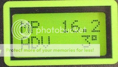

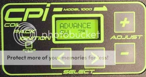

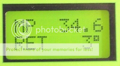

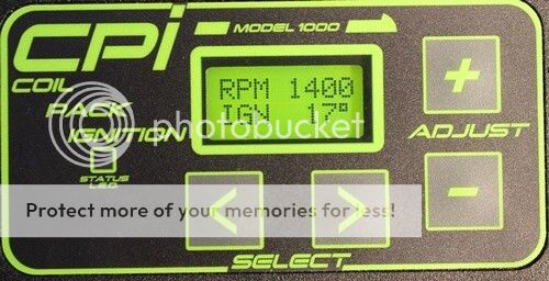

Flexible, Quick Programming
With a couple threads discussing EI and adjustable ignition timing, I wanted to show how easy the CPI is to program compared to the interfaces offered by some of our competitors. Timing is adjustable every 100 rpm in 1 degree increments and reads ACTUAL timing. Scroll to a new range/ window with the < or > buttons, increment or decrement the timing value at that rpm or manifold pressure. Total timing is the composite of rpm timing plus/minus MAP advance or retard. Dead simple. Cranking retard and and advance switch (for LOP operation) amounts are also easily programmable in their own windows.
